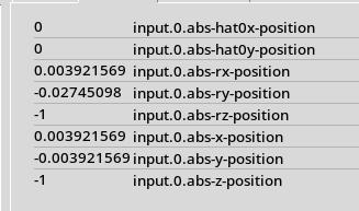

I have an Axis sim running for a 5-DOF robot and a Logitech F310 Joypad. It works well except the jog directions are backwards.
So following this wiki,
wiki.linuxcnc.org/cgi-bin/wiki.pl?Simple_Remote_Pendant
I added the instruction...
Now when I hold in the jog speed buttons the machine immediately moves without me touching the X, Y, or Z joysticks.
I'm running Linux CNC-Robot 6.1.0-18-rt-amd64 #1 SMP PREEMPT_RT Debian 6.1.76-1 (2024-02-01) x86_64 GNU/Linux on Bookworm
Any ideas what might be wrong?
setp input.0.abs-hat0y-scale -127.5 Now when I hold in the jog speed buttons the machine immediately moves without me touching the X, Y, or Z joysticks.

- Posts: 19904
25 May 2024 13:52 #301434
Replied by andypugh on topic Joypad Reverse Jog Direction
Try monitoring the pins in the halshow watch window to see whether they are permanently at some non-zero value.

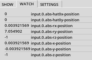

25 May 2024 17:16 - 25 May 2024 17:17 #301447
by Project_Hopeless
Replied by Project_Hopeless on topic Joypad Reverse Jog Direction
Last edit: 25 May 2024 17:17 by Project_Hopeless.
- Posts: 19904
25 May 2024 18:39 #301453
Well, you have changed the sign, which is good, but it looks like the scale is much too high.
Just change it to the negative of what it was before. If it was 1, make it -1.
If you don't know, then try -1, and increase from there as needed.

26 May 2024 20:00 #301537
by Project_Hopeless
I'm good now, it was the number of bits, I found the answer in another post.
forum.linuxcnc.org/24-hal-components/419...-x-and-y-axis#203090
Apparently the problem was in the number of bits of the number. I've gone from 8 bits to 16.
So
- setp input.0.abs-y-scale -32767.5
- setp input.0.abs-ry-scale -32767.5
