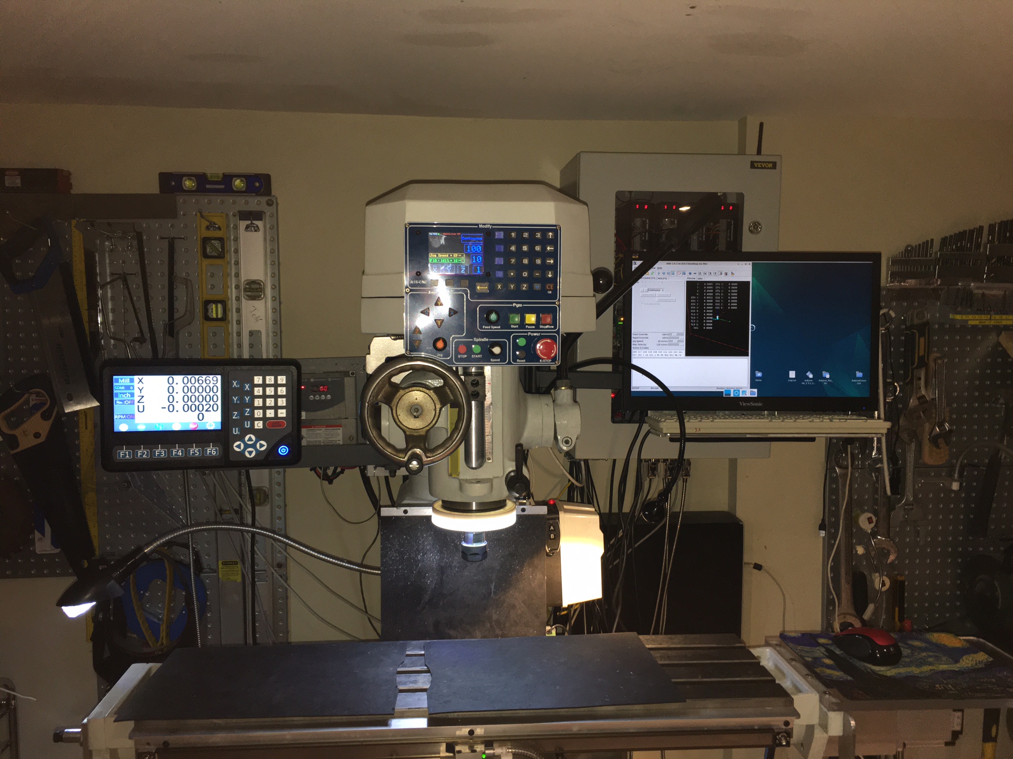

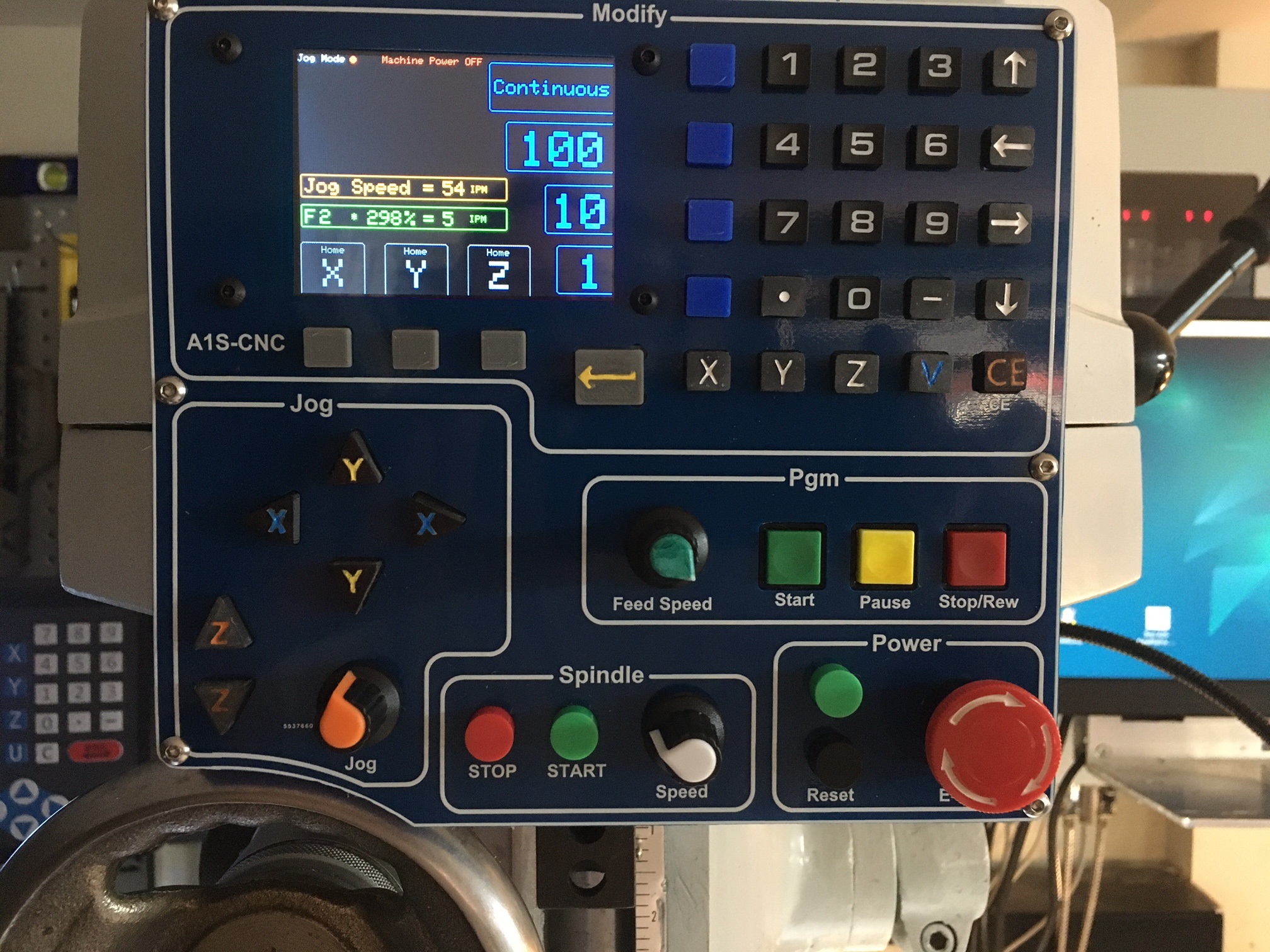

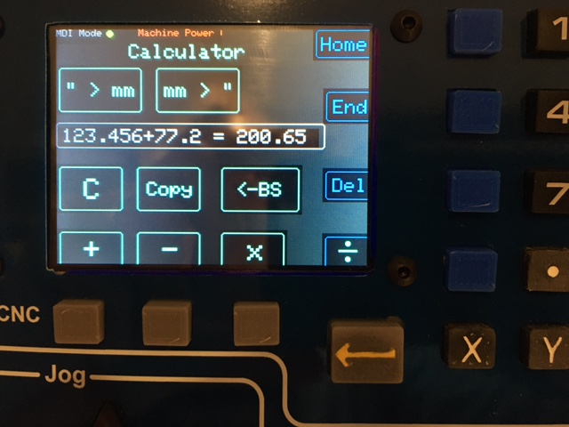

For simple MDI type mill control tasks I prefer real buttons to mouse clicks. So I made this little control panel for ease of use. On the control panel side it's just Arduino code so libraries galore and I found some open source code called Arduino Connector (Thanks Alex from Germany) that allows simple messaging between Arduino world and HAL. The display has multiple modes and in the Jog Mode, the home buttons are associated with the three grey buttons just below the screen.You could try switching to joint mode (halui.mode.joint ) then homing, but I am not sure that is preferable to unhoming then rehoming.
