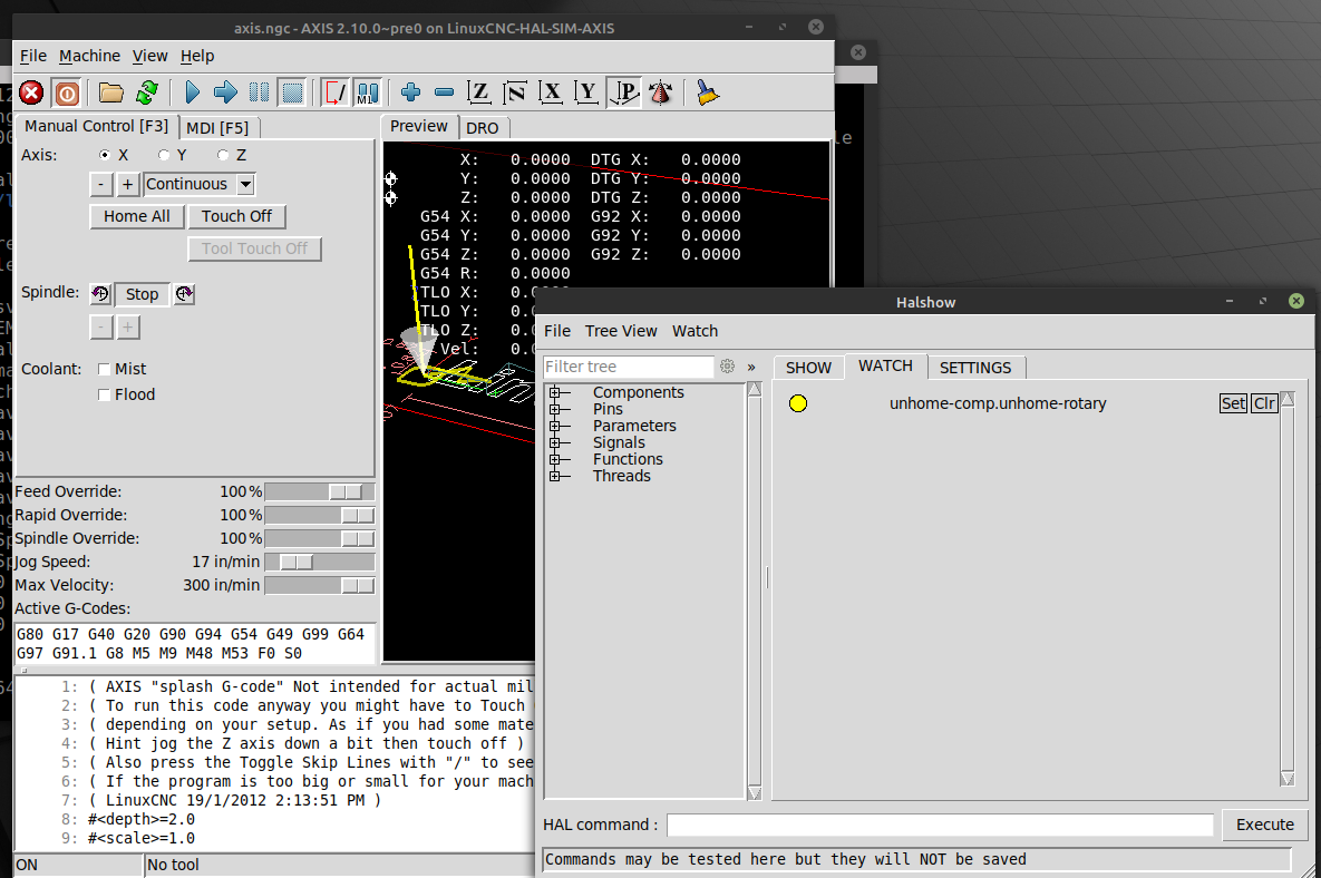

1 year 9 months ago - 1 year 9 months ago #320338
Replied by Aciera on topic caxis.comp - How to freewheel axis/spindle?
As for the component (Bit of a rushed job as I'm short on time right now):
Save this as 'unhome_comp.py' in a folder named 'python' in your machine config and mark as 'executable':
add this line to the [HAL] section of your ini file:
Start your config and open the 'Show HAL configuration' tool and 'watch' the 'unhome-comp.unhome-rotary' pin, setting it to TRUE should unhome the joint number set in the python script in the line 'joint = 0'.
Code:
#!/usr/bin/env python3
import hal
import linuxcnc
h = hal.component("unhome-comp")
h.newpin("unhome-rotary", hal.HAL_BIT, hal.HAL_IN)
h.ready()
c = linuxcnc.command()
joint = 0
homed = 1
try:
while 1:
if homed == 1 and h['unhome-rotary'] == 1:
c.teleop_enable(0)
c.wait_complete()
c.unhome(joint)
homed = 0
if homed == 0 and h['unhome-rotary'] == 0:
homed = 1
except KeyboardInterrupt:
raise SystemExit
Code:
HALCMD = loadusr ./python/unhome_comp.py
Last edit: 1 year 9 months ago by Aciera.
The following user(s) said Thank You: besriworld, spumco
