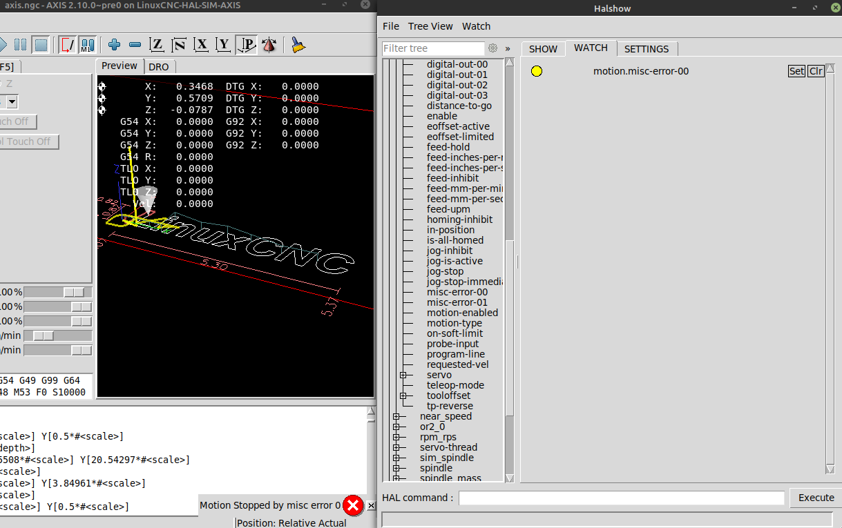

Hello,
i have a question:
How is the way to get motion.misc-error-00 working?
I connected it in the hal with an input. I can see it in the halscope that the input for this signal is working.
The manual means "If driven TRUE this will disable a machine", but in my case nothing happen.
How does it work?
Thanks!
Michael
i have a question:
How does it work?
Thanks!
Michael

Replied by Aciera on topic motion.misc-error-NN does not work

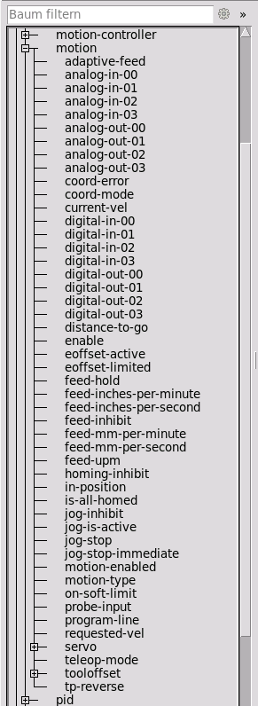

Hello Aciera,
thanks for your reply.
I see the difference. In my machine the motion.misc-error-00 i see only as signal, not as pin like in your picture.
It is not in my pin-list and i see in the documentation that it is not standard-list (linuxcnc.org/docs/stable/html/config/core-components.html).
In which way can i get this pin? (Sorry, it's my first machine with LinuxCNC).
Michael

The error pins are optional and need to be set in the 'loadrt modmod .....' line in the hal file using, for example, 'num_misc_error=2' which should give you two error pins:
linuxcnc.org/docs/stable/html/man/man9/motion.9.html
