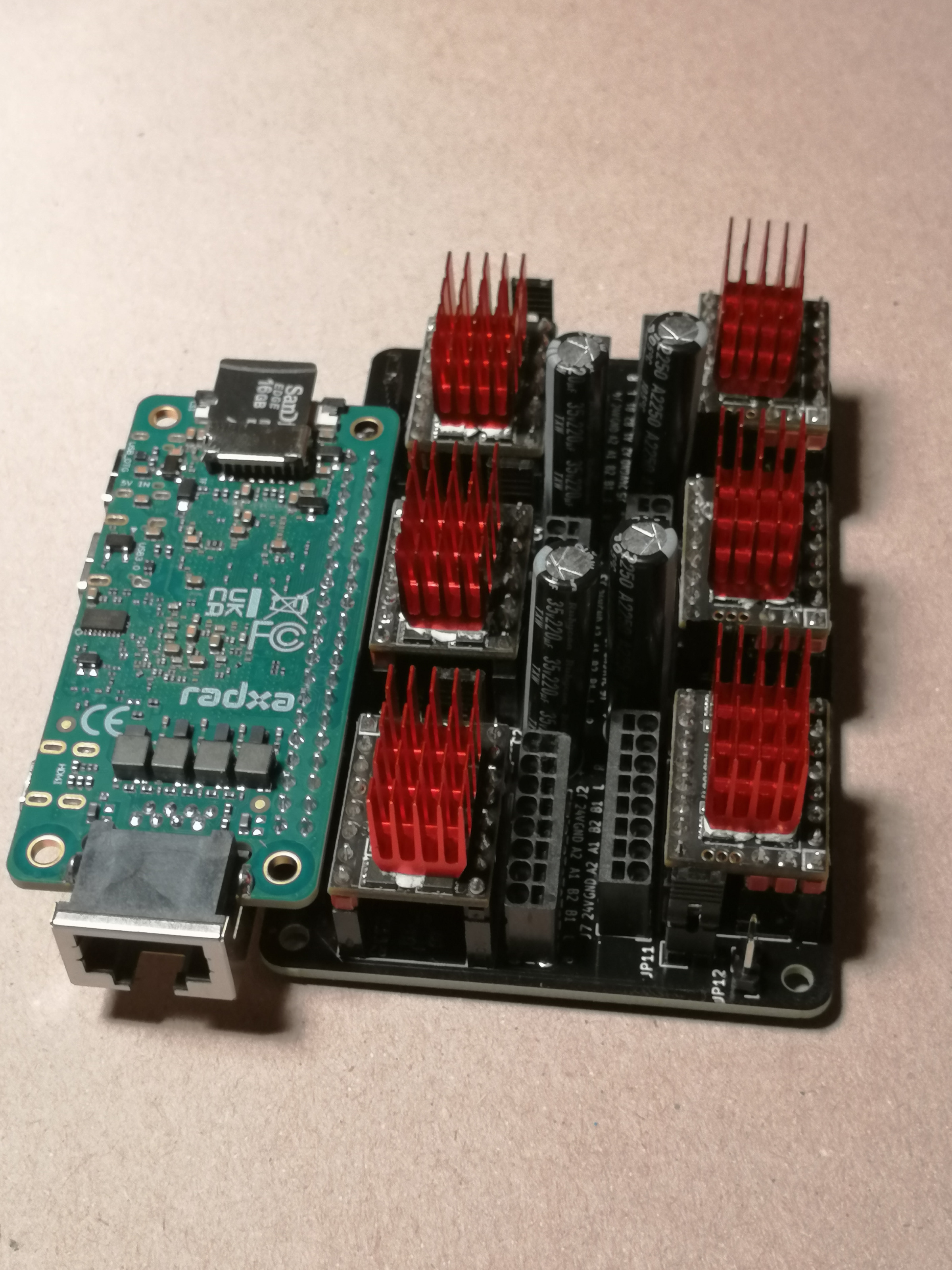

20 Apr 2025 15:13 #326773
by 3404gerber
Replied by 3404gerber on topic Configuring 6 axis robot arm with lcnc
I'm currently playing with TMC5160 on Linuxcnc in full SPI mode and am happy with the result. Just received a pcb to stack 6 of them on a Pi Hat: (well, on a Radxa zero 3E on the picture)
You only use 5 pins from the PI, so plenty left for other stuff. I also added the possibility to connect two 24V end switches directly on the TMC's. And a clock signal generator is on the pcb, so the TMC's share a 16MHz clock, which means better sync and faster SPI communication.
