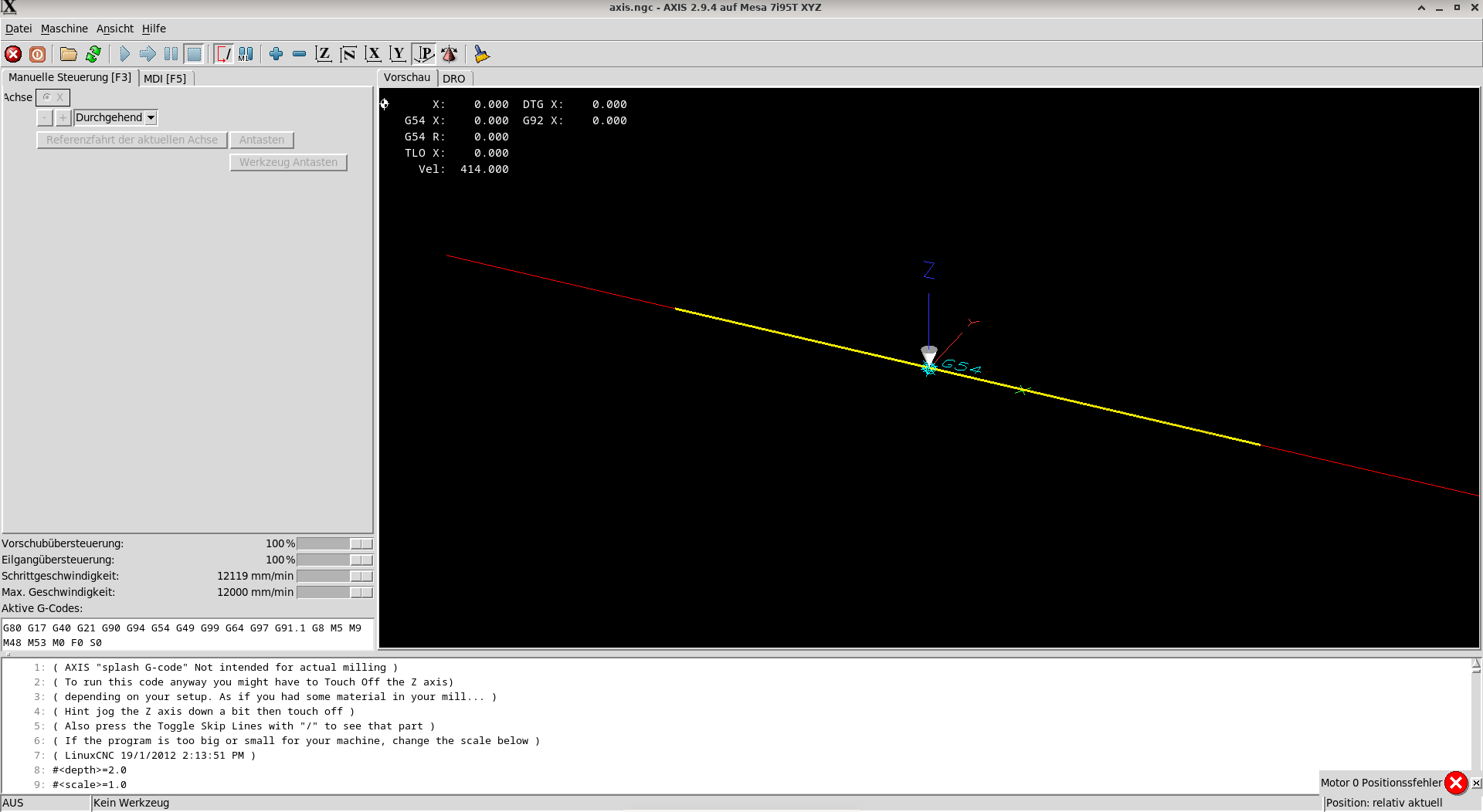

Hello everyone.

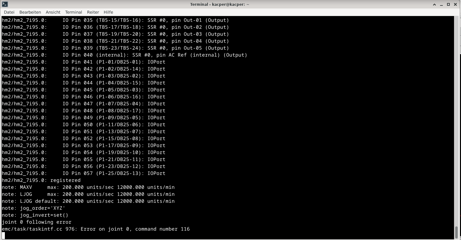

I'm quite new to the topic of Mesa cards and LinuxCNC. For the past few days, I've been trying to get my Mesa 7i95T up and running. Some things are working well, I’ve loaded the firmware and configuration, and now I can communicate with my card. Encoders can also be observed on the LinuxCNC interface. Now I wanted to try running my motor for the first time, but unfortunately, I’ve been unsuccessful for a few days. When I reference all my axes and click Jog, I get the error message:
Motor 0 position error
emc/task/taskintf.cc 976: Error on joint 0, command number 108

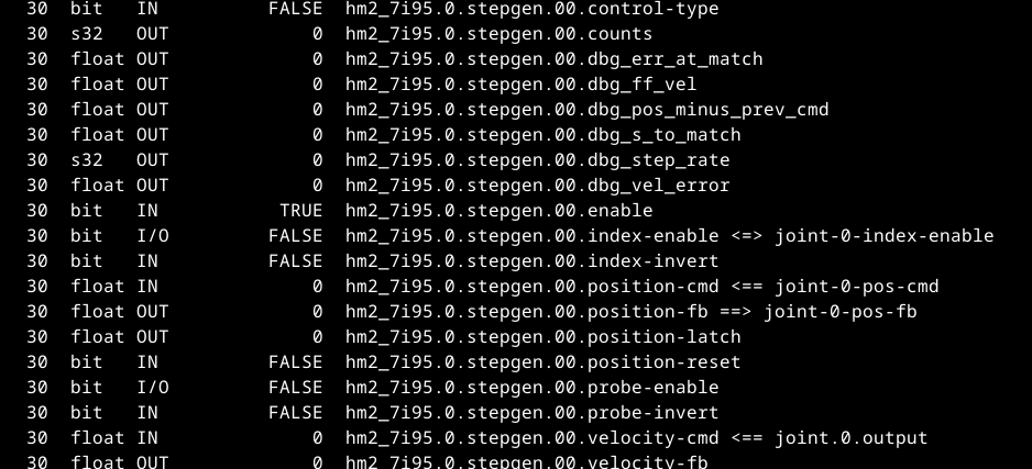

From a hardware perspective, everything seems to be correctly connected. Below, I’m attaching my .ini, .hal, and stepgen pins. Do you maybe have an idea where the issue could be?
Right now, my main goal is just to get the motor running. Thanks in advance for your tips and support.

Replied by PCW on topic Problems with jogging the motor
I would start with a MesaCT created configuration.
