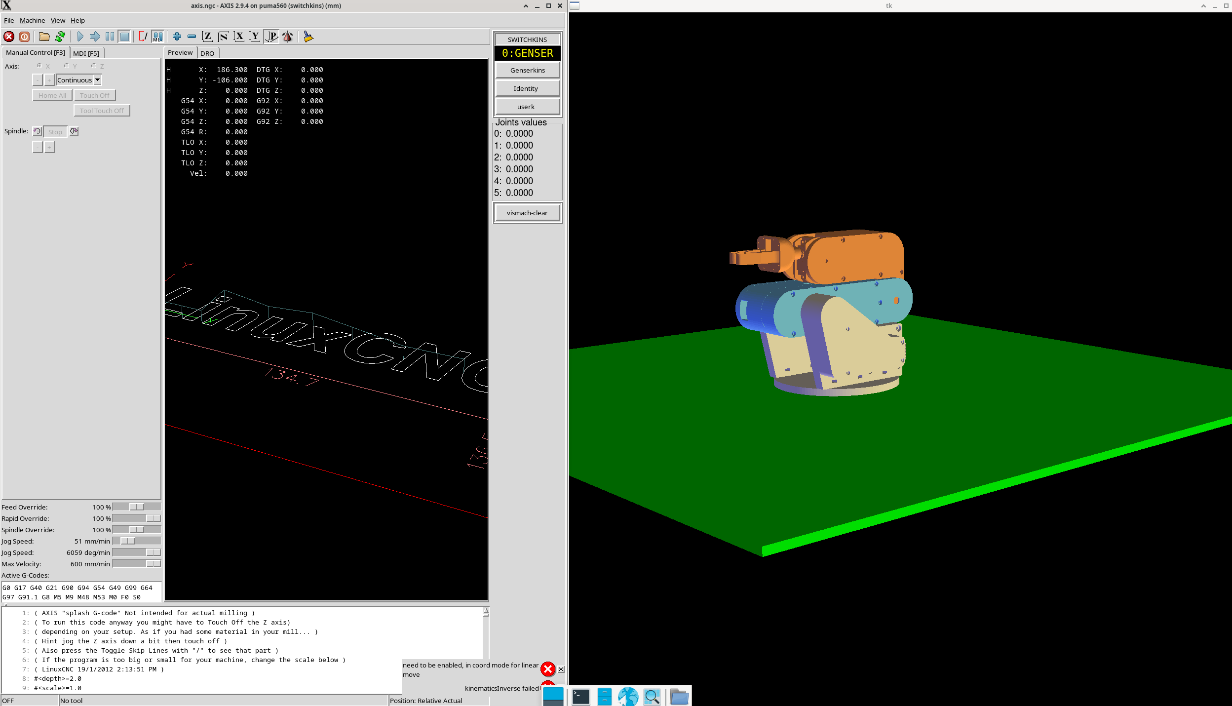

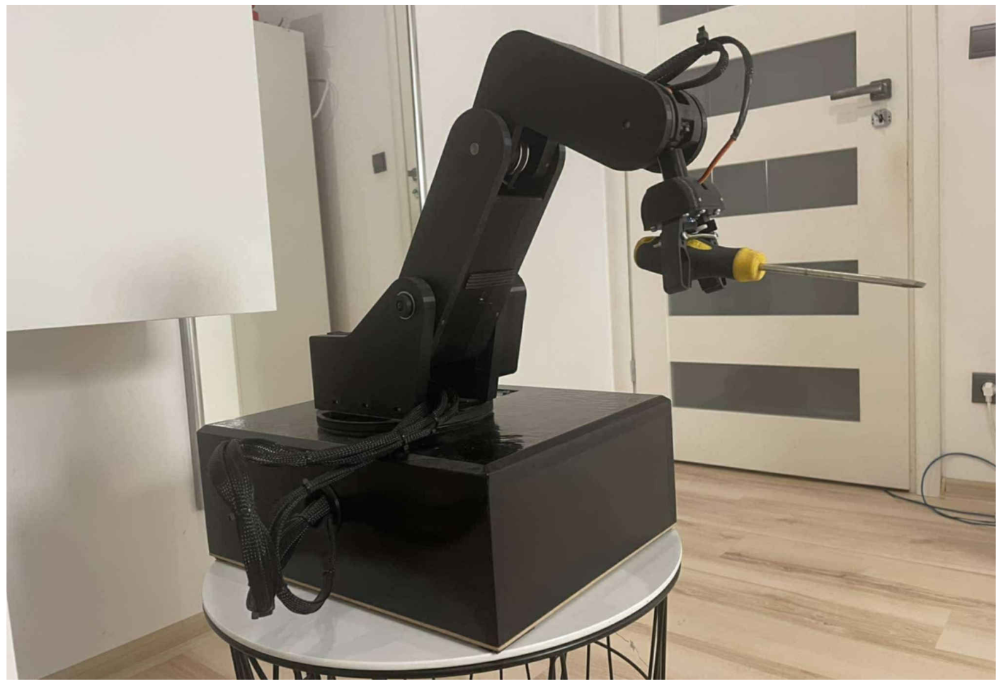

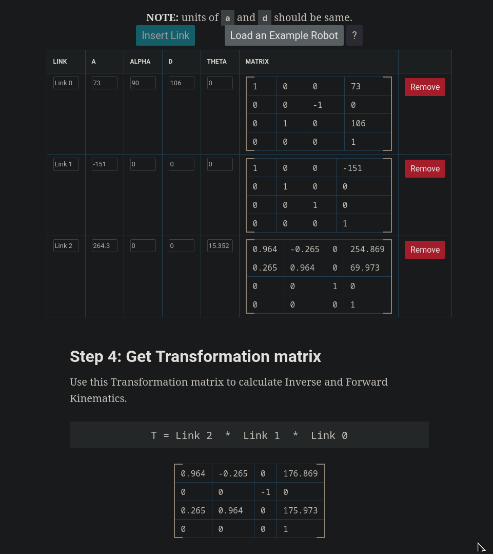

Hi,I am currently developing control software for a 3-axis robotic arm using LinuxCNC together with a Mesa 7i96S motion controller. Everything has worked well so far, until I ran into issues related to the Denavit-Hartenberg (DH) parameters defined in the HAL file.As a base, I used the Puma560 example, which worked correctly with the default DH parameters. However, after replacing them with my own DH values, I started encountering problems. Specifically, I’m unsure how to properly handle fixed theta values within LinuxCNC’s DH parameter structure, since there seems to be no direct way to set them.I have created a precise mechanical model of the robot and derived the necessary DH parameters accordingly. Despite this, I consistently receive an "Inverse Kinematics Failed" error whenever I attempt to run the "Home All" sequence for the joints.I’ve attached both the DH parameter values and a visual representation of the robot. The actual robot has 5 axes, but for the purposes of this project, I am controlling only 3 of them using stepper motors to keep the setup simple. I would be very grateful for any advice or guidance on how to resolve this issue.Best regards,

Replied by andypugh on topic Issue with Inverse Kinematics Failing During Homing – 3-Axis Robot with LinuxCNC
Note that all that I know about kinematics is that it confuses me...
Forward kinematics takes the joint positions and calculates the end effector position. This will always work and will always return exactly one solution.
Inverse kins takes the required end effector position and calculates the joint positions to achieve that. Sometimes there is no solution (because the arm simply can't reach that point). Sometimes there are multiple solutions (in fact there _generaly_ are.
So, the kins has to choose a solution. And sometimes it can lock itself in a corner, where there are solutions for the current position, and for the next position, but it would have to pass through a "wrong" position to get there.
This isn't just robots. I am sure you have been in this position with your own arms.... The difference is that you have a brain and are not blindly following what is basically a relatively simple mathematical equation which has no predictive capability.
So, back to your questiion: Homing happens in joint space, using forward kinematics. So presumably you only see the error after homing is completed, and the system switches to "world mode" and inverse kins.
Maybe your home position (in XYZABC rather than joint angles) simply isn't reachable? (or, doesn't _actually_ correspond to the joints-homed position?)

Note that 'genserkins' uses 'modified' DH parameters.
Have a look here (there is also an example of how to derive the parameters for a manipulator):
www.linuxcnc.org/docs/stable/html/motion...ml#cha:dh-parameters

Well, you were right. I had to use the modified parameters in the DH method.

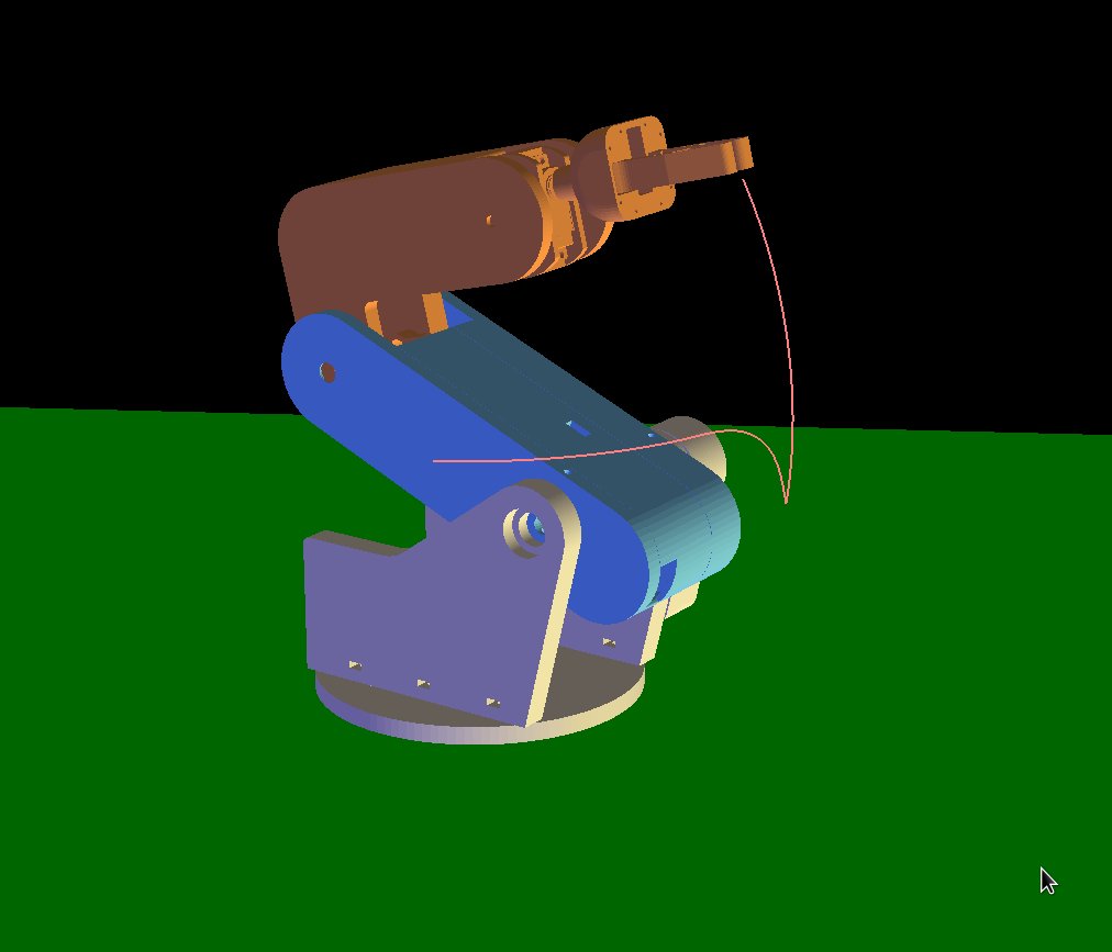

i think you have to build a new kinematic module for 3 axis robot because Genserkins can't be used for less than 6-axis robot. Also keep attention to singularities (your 3 axis robot will have a singularity when link 2 and link 3 are straight line, this can cause kinematic fail)
