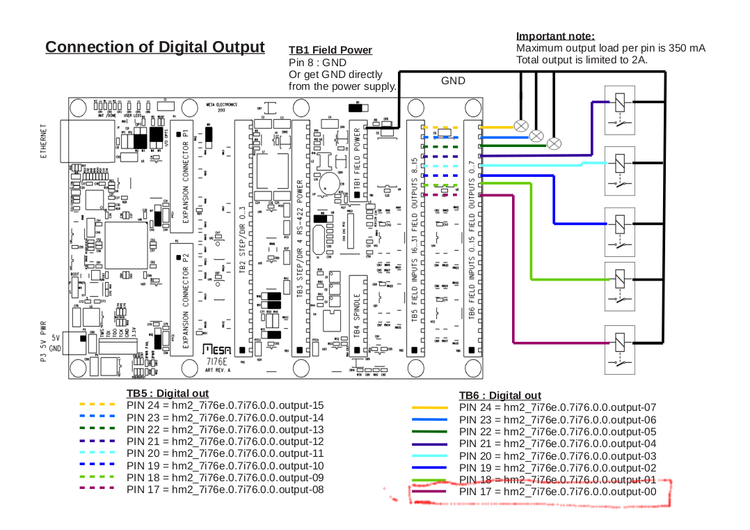

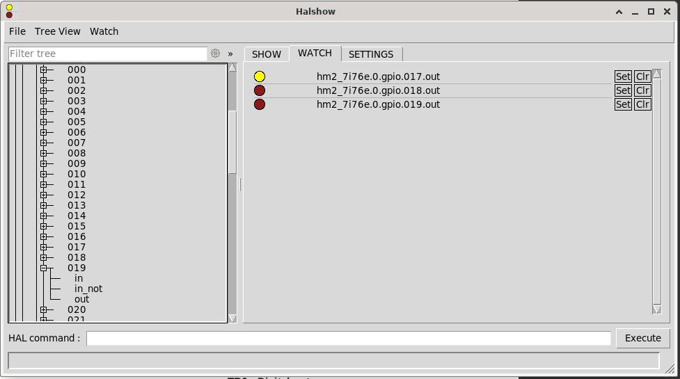

As a German beginner, I am currently trying to get my Mesa7i76e up and running.
I have connected three relays to pins 17, 18, and 19 and would like to control them via Halshow. When I connect a relay directly to 24V, it activates.
In Halshow, I would say that I have set the correct pins via Set. However, no output is switched. I can switch the yellow indicator in Halshow on and off.
I hope you can help. Thank you.

Replied by PCW on topic Set GPIOś via Halshow
That should work, if LinuxCNC is running and there have been no watchdog or other faults.

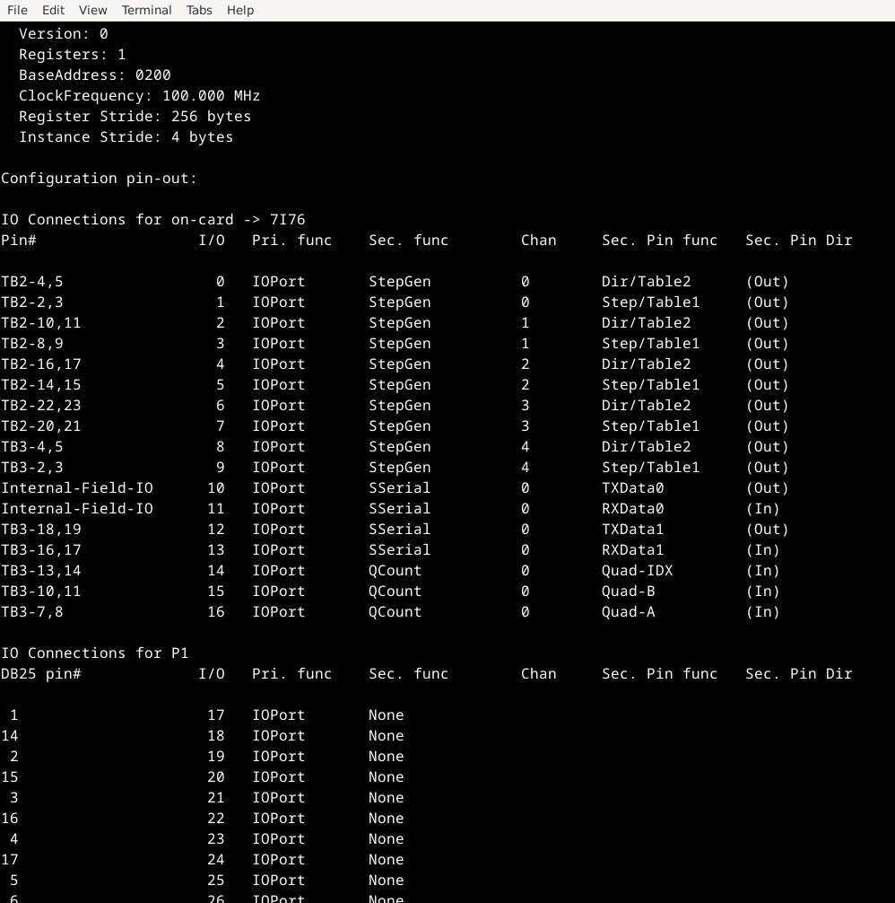

Replied by DerKlotz on topic Set GPIOś via Halshow
In the editor i just did a mesaflash --device 7i76e --addr 10.10.10.10 --readhmid... there is just TB2/TB3, P1 and P2 visible. No TB4, 5 and 6. Somewhere there the mistake? What to do?
- Posts: 18118
- Thank you received: 5336
08 Oct 2025 11:09 #336103
That's correct, mesaflash does not show sserial devices unless you add the --sserial command line option
Hmm, it looks the same if i add --sserial
- Posts: 18118
08 Oct 2025 12:55 #336109
--sserial does not work with --readhmid
It also does not list pins, if you want that you need to run LinuxCNC
I just set pin 17 to flood and pin 18 to mist. Then the relays work...
So how can i set the pins to Digital out and control then via Linuxcnc. Can i create new buttons in Linuxcnc?
