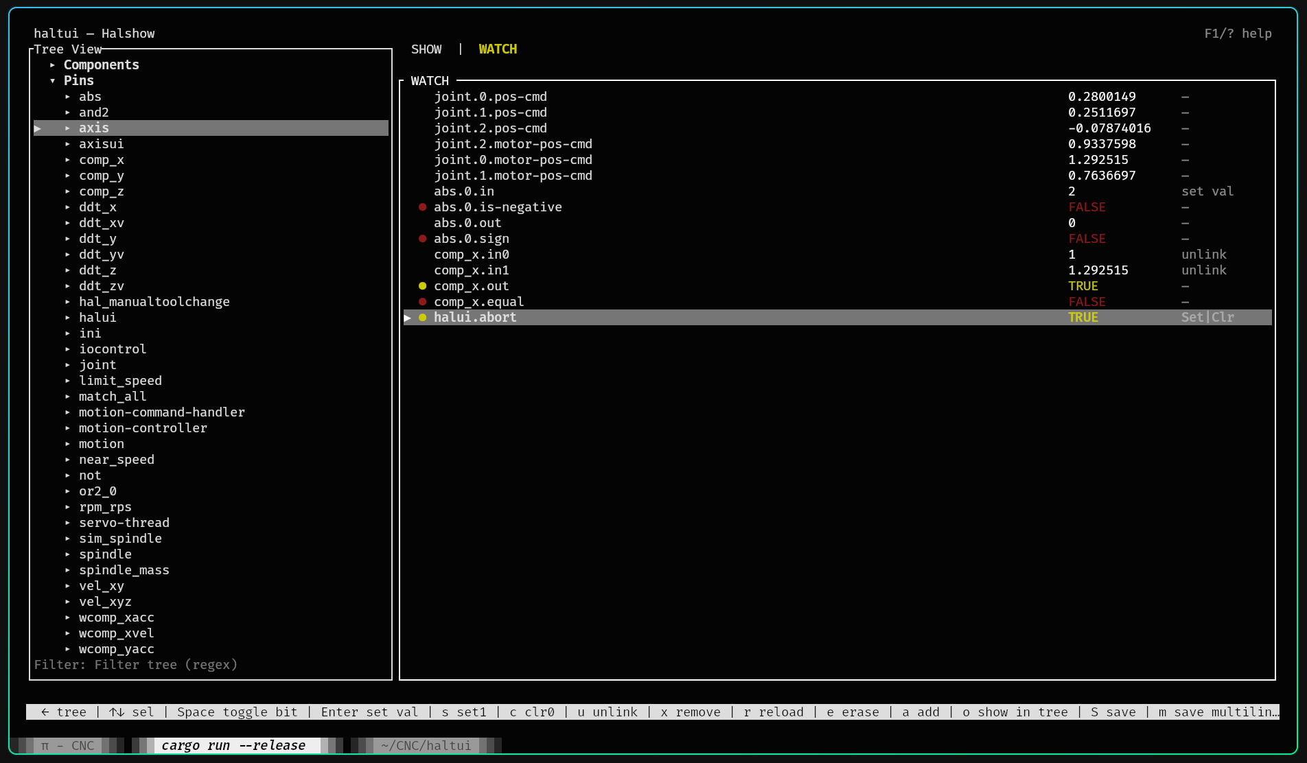

I created a terminal based HAL viewer, 100% keyboard based operation
25 Aug 2026 04:32 - 25 Aug 2026 04:36 #348995 by hansfbaier
write this halshow based HAL viewer, because halshow is unusable from the keyboard only.
This one is completely operable by the keyboard and is compatible with halshow save files.
For example toggling a boolean Pin is only the press of the space bar and
moving between the tree and the WATCH/SHOW tabs uses left/right arrows.
Here is the source code:
github.com/hansfbaier/linuxcnc-haltui
Have fun!
HansĀ
Last edit: 25 Aug 2026 04:36 by hansfbaier. Reason: Broken image link

03 Sep 2026 10:02 #349290 by andypugh
Note that there is a re-write of Halshow under development, it might be worth seeing if there is scope for adding your ideas there?
github.com/LinuxCNC/linuxcnc/pull/4231
