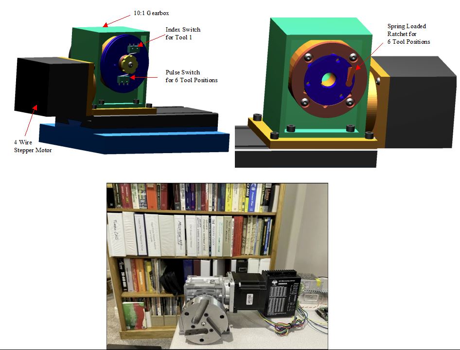

13 Feb 2021 22:35 #198741 by Barry
Replied by Barry on topic LinuxCNC 2.9 vs. 2.8 Using A-Axis for ATT
LOL...Thanks Andy. I needed a good laugh at myself today. I honestly agree, the Carousel man page was "exquisitely documented" by you but please trust me when I say that I'd already spent hours and days looking at it 100 times trying to figure Carousel out as a newbie before posting for help. I feel like I'm working on getting a 3rd Engineering degree the past 6 months putting together all of the puzzle pieces for Remapping, G-Codes, M-Codes, O-Codes, Hal, LinuxCNC, different GUI interfaces etc. It seems the more I learn the more I realize I don't know, but it's been fun and at some point will come together in my mind.
I've attached the files necessary to provide help and see where I am so far on this project. You'll notice that the hal file shows 3 ATT control options that I've experimented with.
Option 1: Uses the A-Axis. Position is controlled by an O-code sub using typical G-Code position commands. This works fine now that you solved my A-axis graphic display problem for me.
Option 2: Uses M68 E0 Q commands in an O-Code Sub. This option works but I haven't figured out yet how to maintain unidirectional wrapped rotary, nor how to home the ATT automatically to tool position 1. Don't worry about helping with this option though as I'd prefer to spend the time on Option 3 which uses Carousel since this would be of more help and interest to the broader audience on this forum.
Option 3: Uses the Carousel function. If you could please help me get this going it would be greatly appreciated! :) You'll notice that I added both an index sensor for tool position 1 and a pulse sensor for individual tool positions (but it might require a software counter to maintain tool position after homing). The pulse sensor may not have been necessary though since a Stepper motor is used. However, it looked like Carousel might require it, unless motion control can be used to provide this feedback, so I added it to the design. Regardless, if this sensor is not needed then it can be used for a tool position light indicator.
Note: Internal parts of the ATT are shown as 3D CAD drawings because I have not yet finished fabricating them in my machine shop.
Thank you in advance,
Barry
14 Feb 2021 01:14 - 14 Feb 2021 01:15 #198769 by andypugh
Replied by andypugh on topic LinuxCNC 2.9 vs. 2.8 Using A-Axis for ATT
I am guessing that this tool changer needs to run forwards to the pulse, then reverse onto a pawl?
The missing parts of the puzzle seem to be:
1: Use iocontrol.0.tool-change and iocontrol.0.tool-changed to enable the tool changer. ]
net tool-num iocontrol.0.tool-prep-pocket => carousel.0.pocket-number
net start-change iocontrol.0.tool-change  => carousel.0.enable
net change-done carousel.0.ready => iocontrol.0.tool-changed
2: Use a velocity-mode stepgen to move the carosel:
loadrt stepgen step_type=0,0,0,0 control_type=p,p,p,v
net motor-speed carousel.0.motor-vel => stepgen.3.velocity-cmd
setp carousel.0.fwd-dc 200
setp carouself.0.rev-dc -20
setp carousel.0.rev-pulse 3
Then M6 Tnn G43 should move to the requested tool and set the tool length,
Last edit: 14 Feb 2021 01:15 by andypugh.
