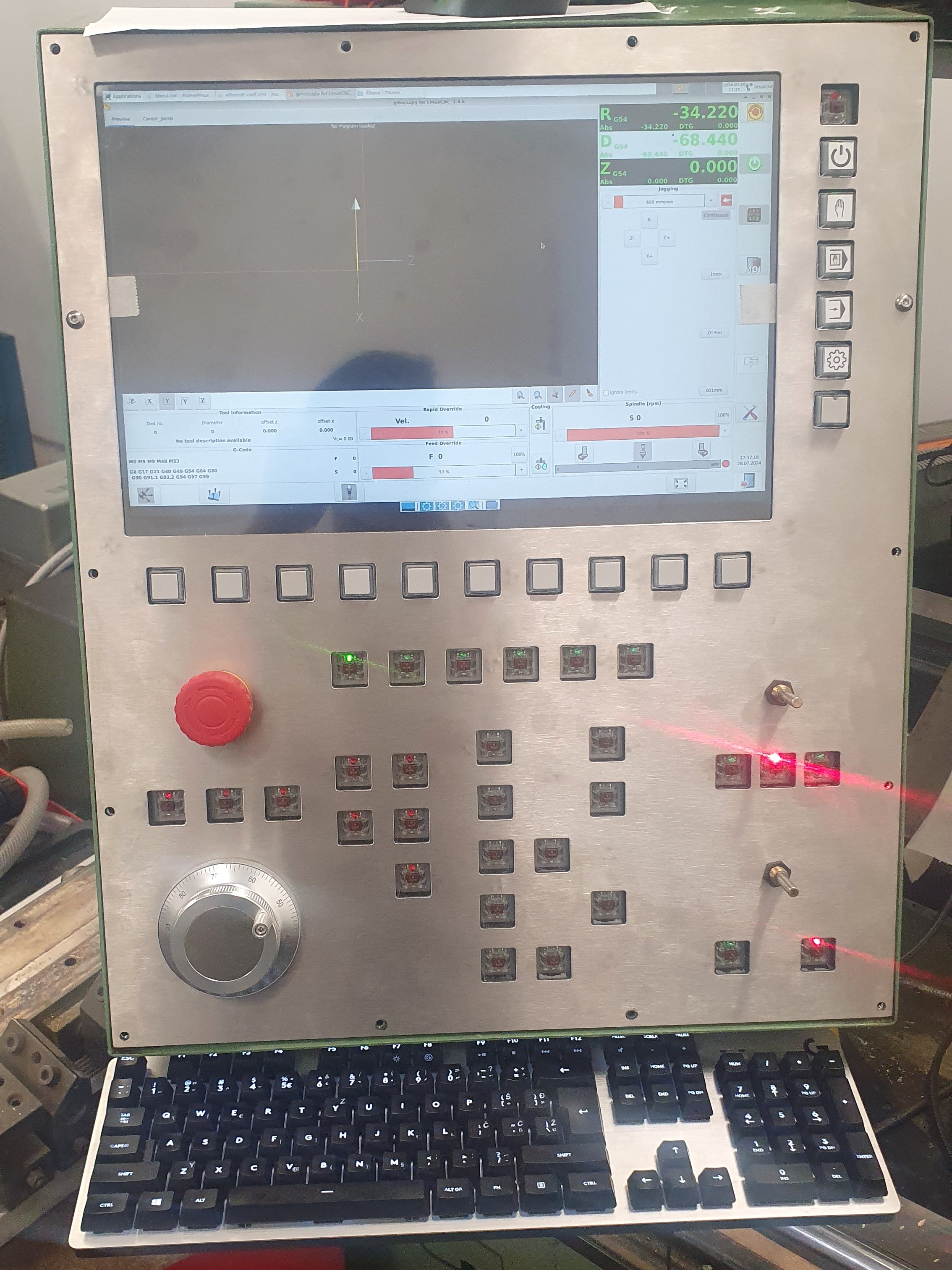

And this is the control panel, laser cut stainless, cherry switches and potentiometers for overrides. screen is a chinese 14 inch touch screen.

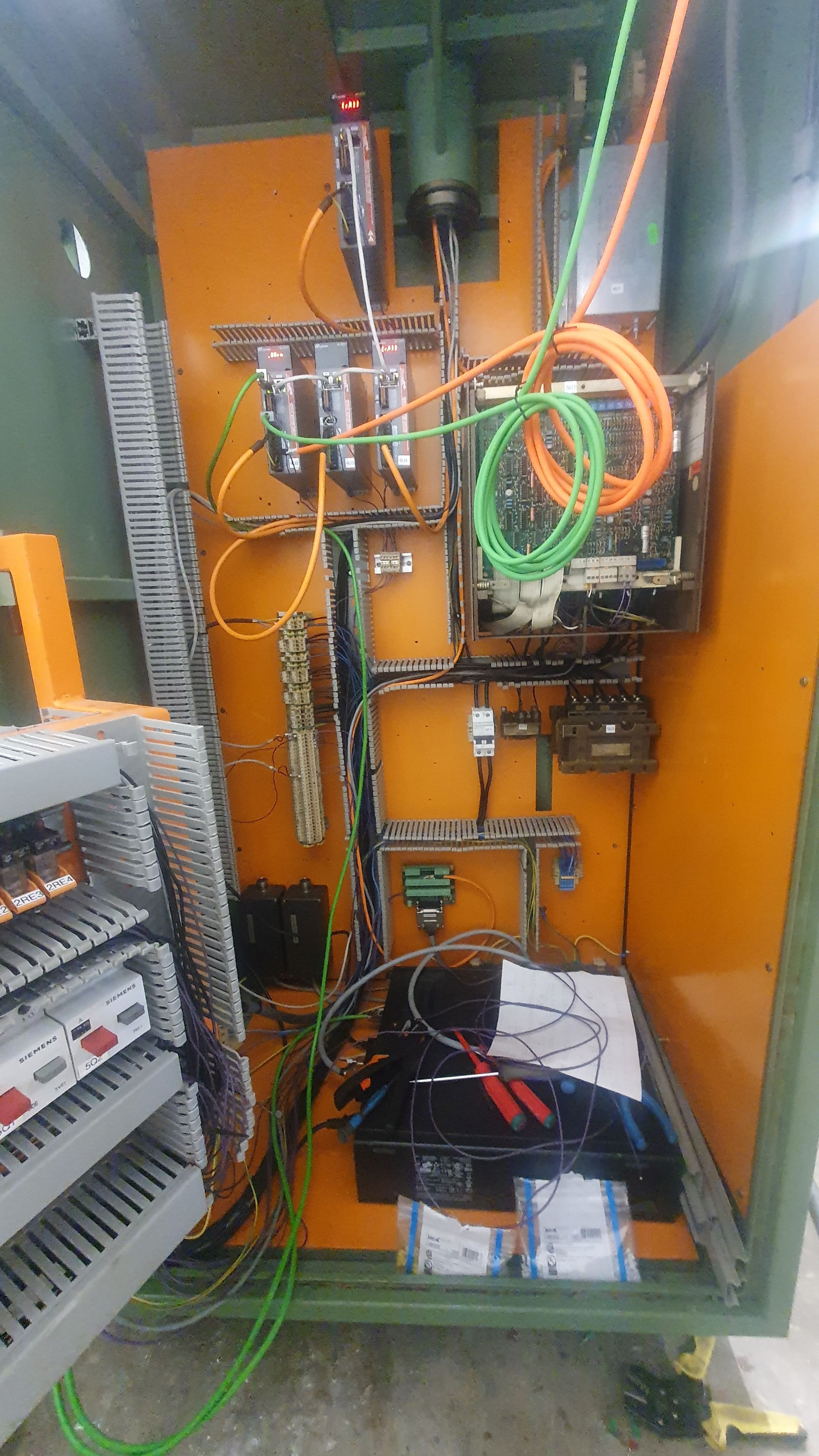

This is the control cabinet, wiring still in progress.

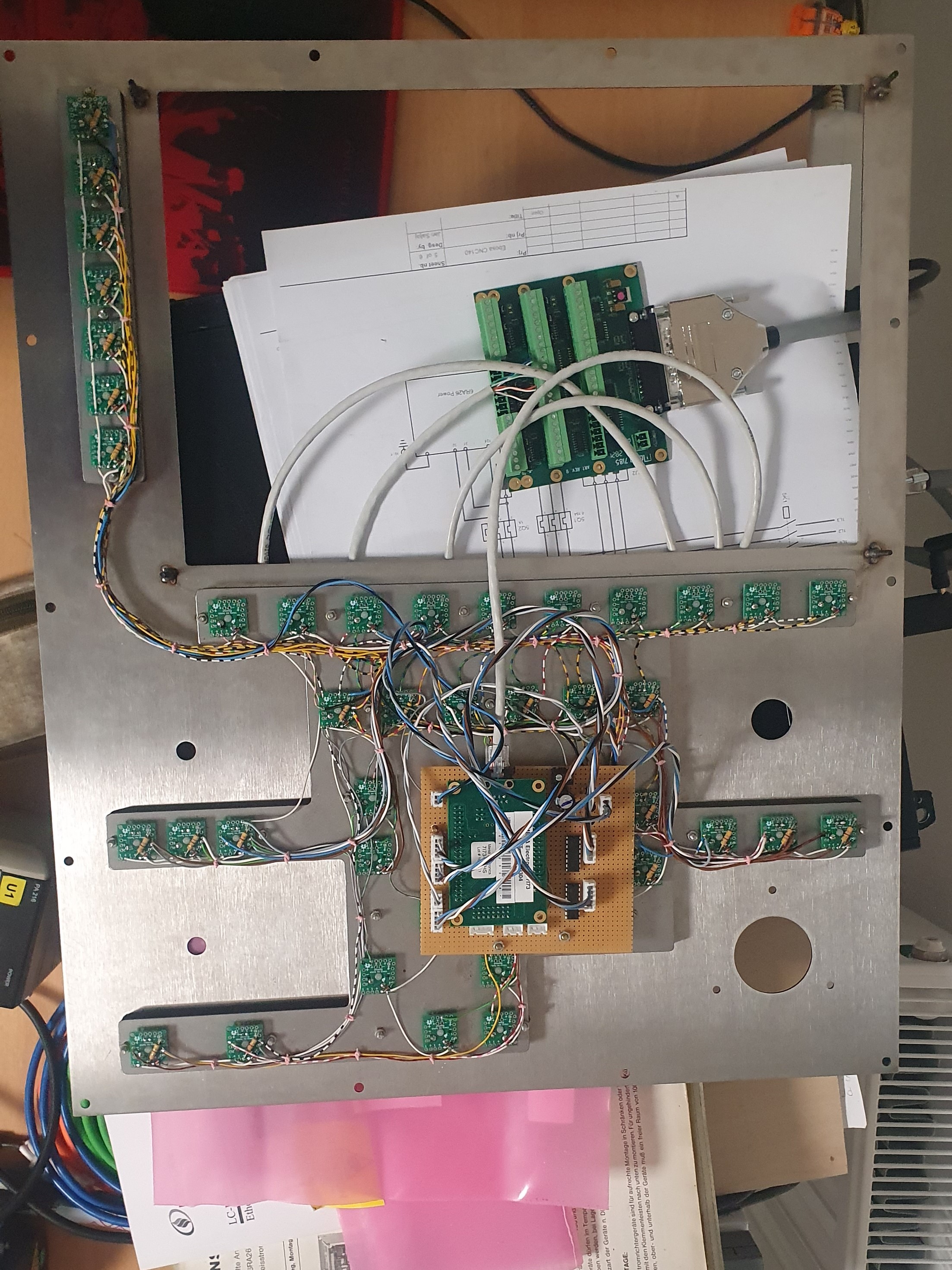

Here is a picture of the back side of the panel, 7i73 reading switches, 2 potentiometers and mpg encoder.
It also drives 30 LEDs under switches (multiplexed). The multiplexing is currently done in hal but I will try to write a component for it.

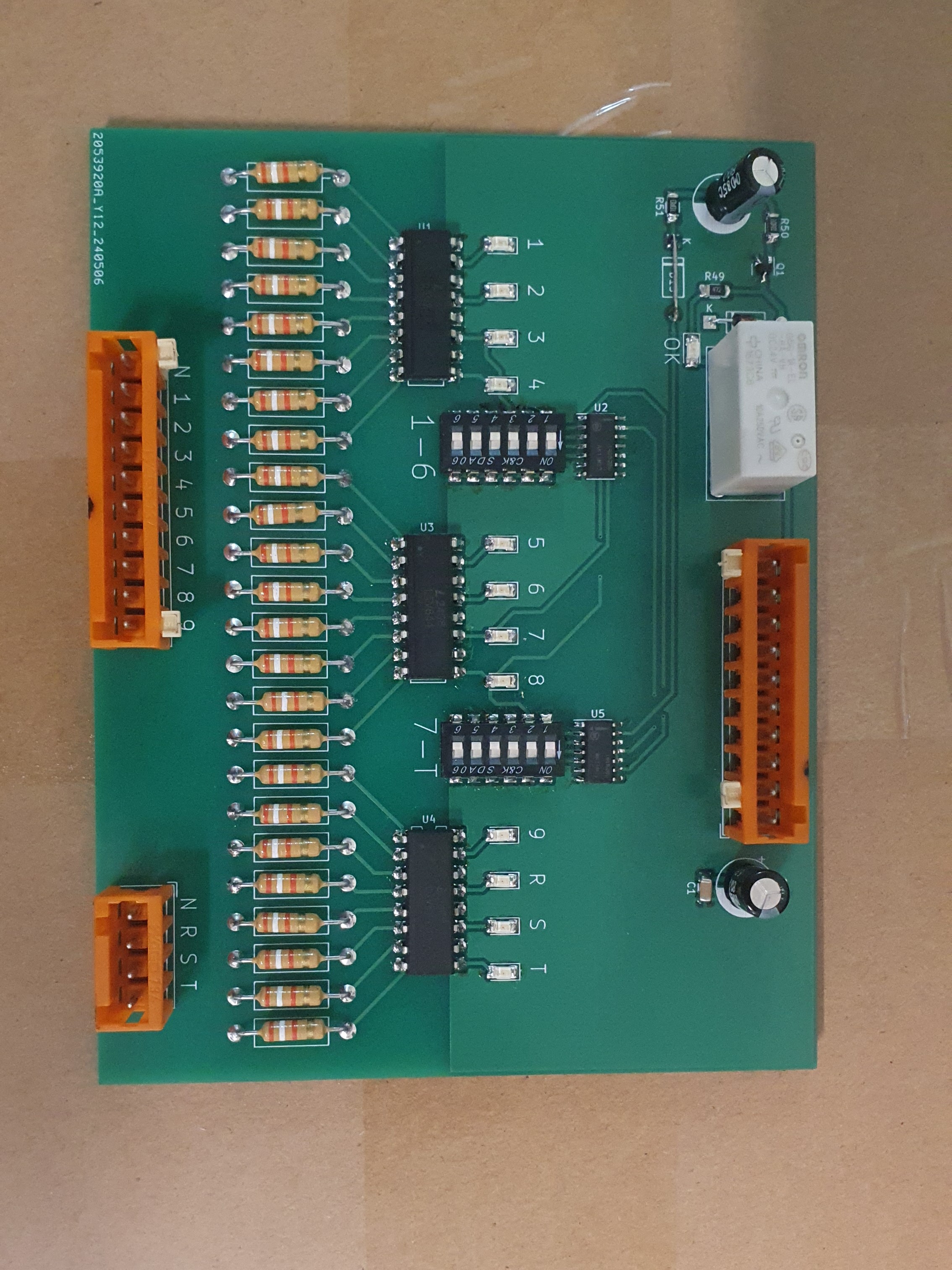

And this is a custom power detection board. Basically just 12 AC optocouplers and a relay output to detect a open breaker or motor overloads.
