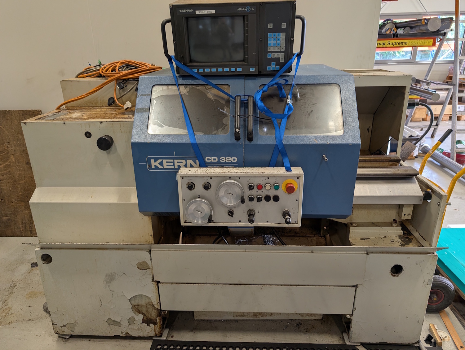

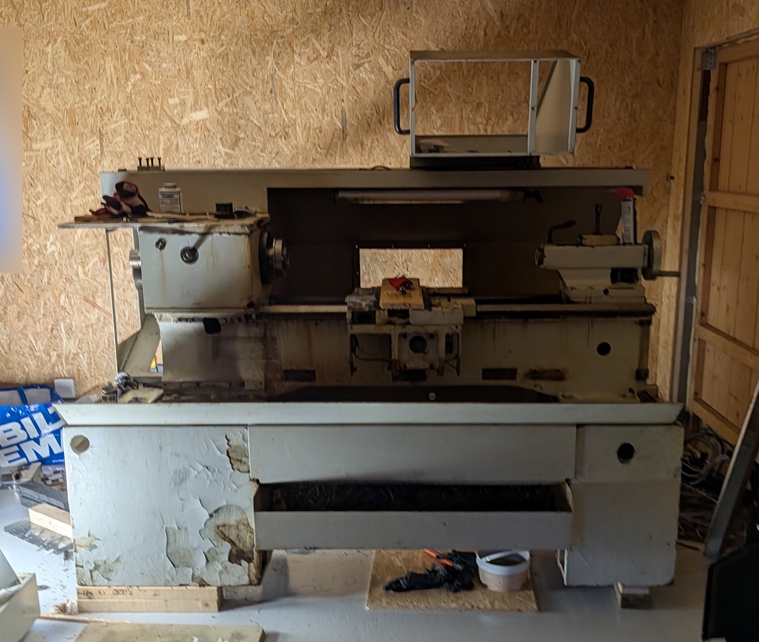

Hello everyone
I have gotten my hands on a 1998 Kern/DMT CD320 cnc lathe in kind of a rough state. My plan is to tear it down, clean out all the old gunk and then get new servos and electronics to allow me to run it on 3 phase 230v. But before I start spending money I have a couple of questions I was hoping someone around here could help me with.
1. Do anyone have any kind of technical drawings or manuals for this machine. I have tried emailing DMT a couple of times, but I get no reply.
2. I am trying to decide if I should go for Ethercat servos or Mesa + pulse, any thoughts on the best solution? I have been able to find suitable hw for both alternatives on aliexpress, so main concern is linuxcnc compatability/problems.
Any input is greatly appreciated, regards from Norway.

If the old motors and drives work, i would not change them, just get some Mesa analog boards and move on.
I can not give you useful advice for now as i always try hard to use the existing drive train when retrofitting (done plenty of those), and i did not use EtherCAT yet, but from what i read here they are both hard to set up and have issues i do not like to deal with, especially having position feedback going on vacation at random on a 15 ton machine.
If you need inspiration, have a browse through "show your stuff" section of the forum, plenty of retrofits by me and other forum members there, also many more on other sections but might be harder to find.

When I bought the machine it would not boot, with a bios battery error message, so the original computer is probably dead, but not really a big loss... But the machine was working fine the last time it was used, a couple of years ago, according to the seller, so the original Indramat drives and motors are probably fine. Main problem is they require 380v, 3-phase and 17kW of it... A bit more than I have available in my garage. So the plan is to reduce the power somewhat (especially for the 10kW spindle motor), given the machine is only going to be used for hobby projects, and get it to run at 230v 3 phase.
With regards to ethercat vs mesa it looks to me, based mostly on forums posts, that the mesa route is safer, more tested and less potential problems, does that sound about right?
