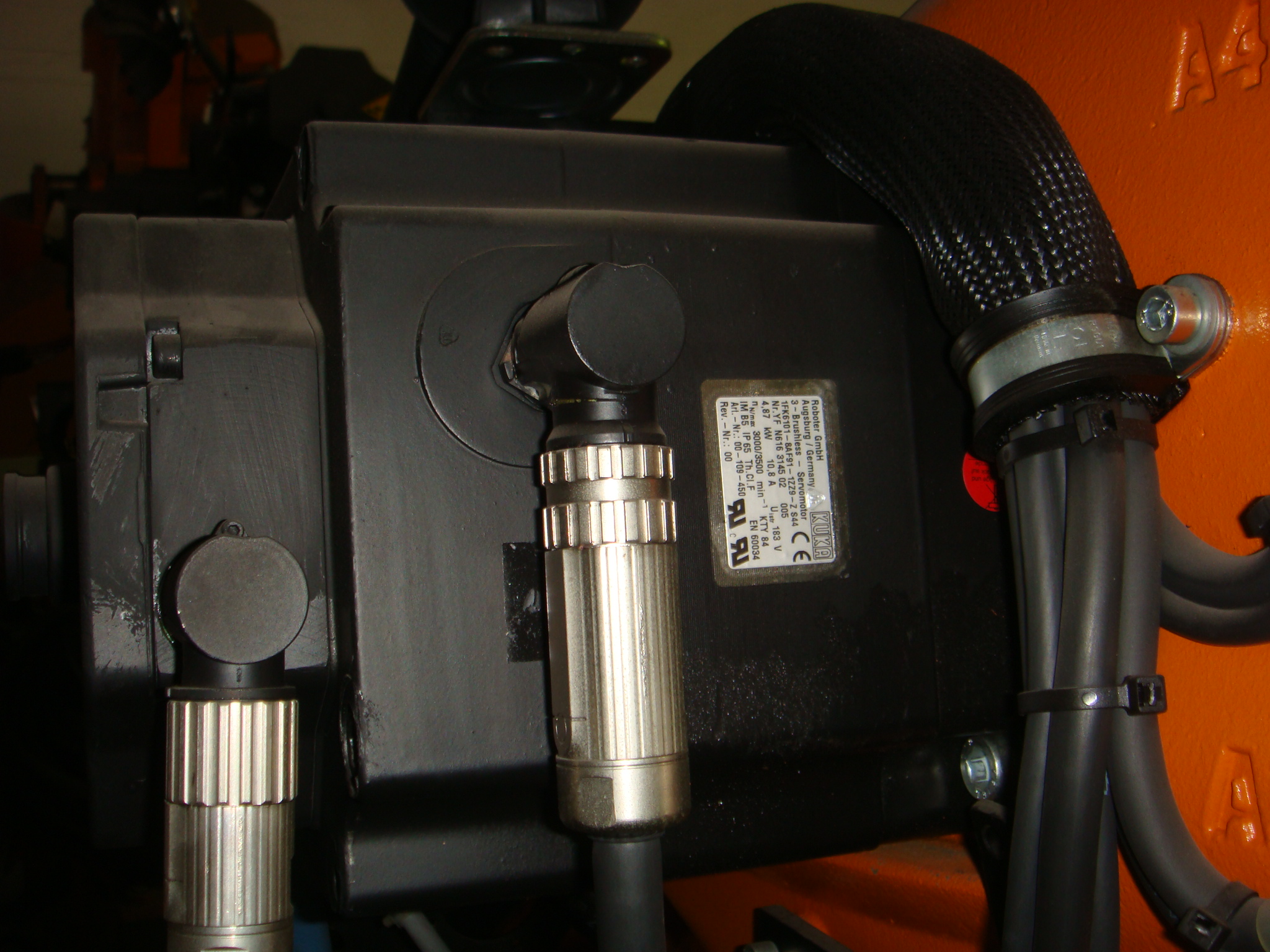

HI,
Is there a board more powerful than a mesa 8i20 for brushless ac motors ?
I need at least 600V / 12A

The 8i20 is 400V 30A. Your motors will probably run very well at 300V, but at about half the maximum speed (which is rarely a problem for axis motors).
www.a-m-c.com/download/datasheet/dprahie-060a800.pdf
Might work for you.

Thank you for your quick answer. It's exactly what i as looking for but i think this is reserved for united arab emirates

I have attached the photo of the motor specifications.
I don't known why mesa does think its not suited...
