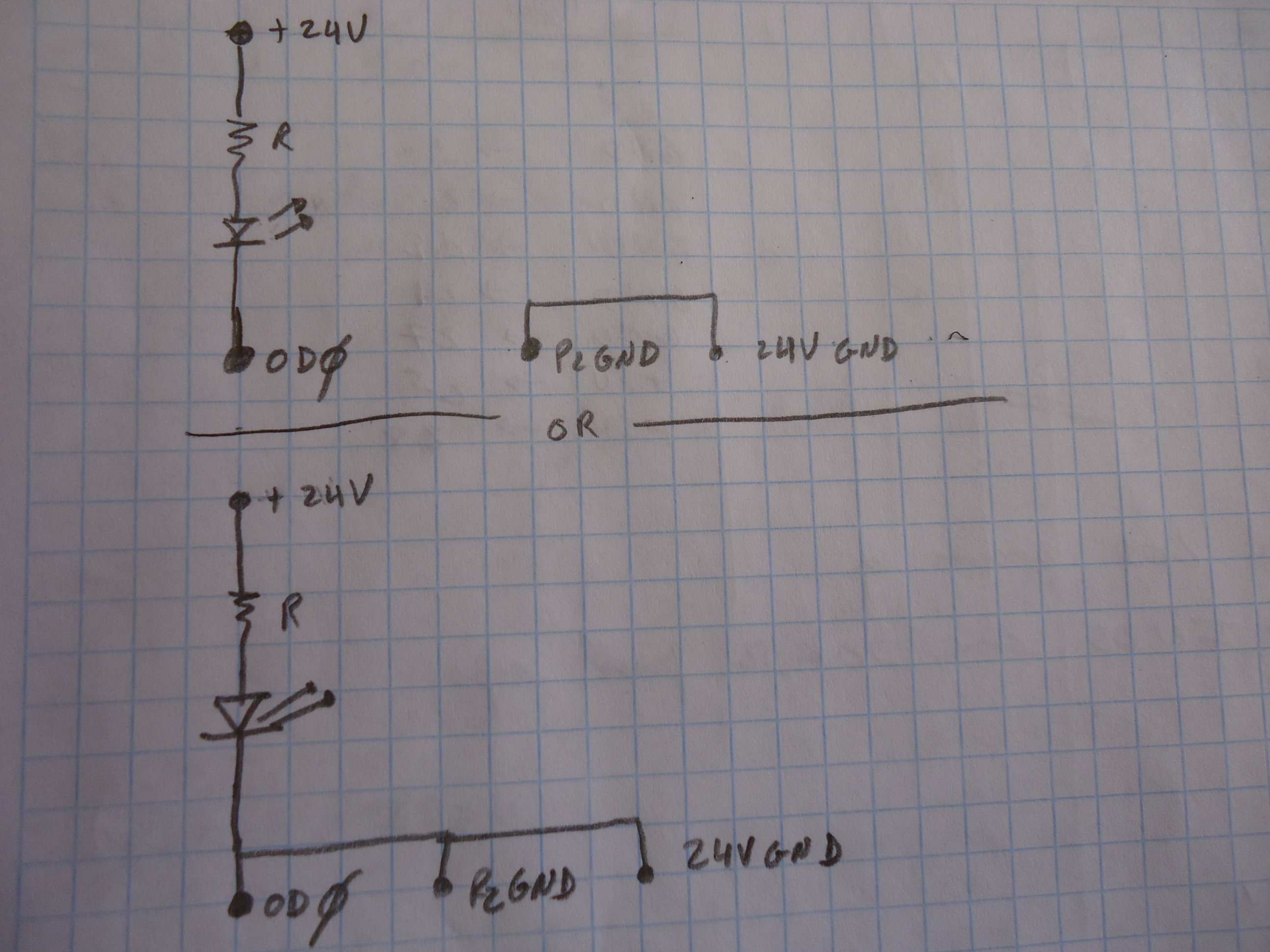

Yes, that will work +24 --> LED+ --> LED- --> OD0 --> P2GND --> 24VCOMMOM
(assuming the LEDs have built in resistors for 24V operation of course!)

23 Apr 2013 22:48 #33069
Replied by PCW on topic mesa 5i20 + 7i44 +7i73
The top one is right
(the bottom one will have the LED always on)
(My --> were current flow not wires)

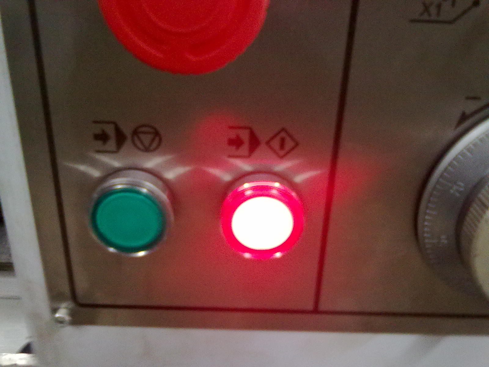

currently I'm having this issue:
with only the 24VDC power supply on the red back-light is on. all the others boards and the PC have no power. If I turn on the PC (mesa cards are powered by the PC PSU ), the back-light turns off. So, the 7i73 with no power can sink the current to turn the led on in one of this tow outputs (OD0 and OD1). that's a normal situation?
In linuxcnc I can turn on and off both back-lights with HAL commands so they should be well connected.
João
João
