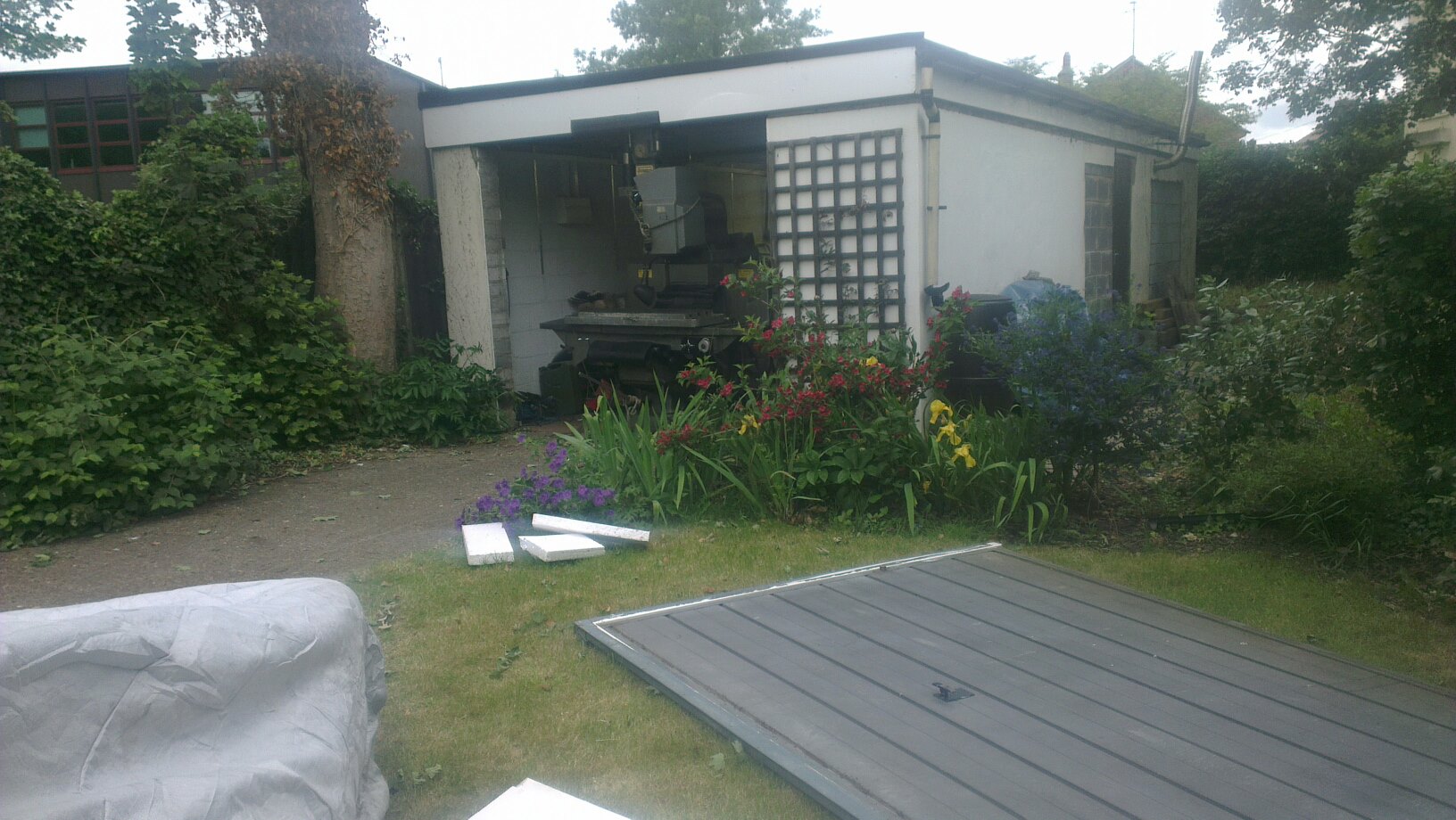

Many thanks, you can see from the picture I like biting off more than I can chew!
