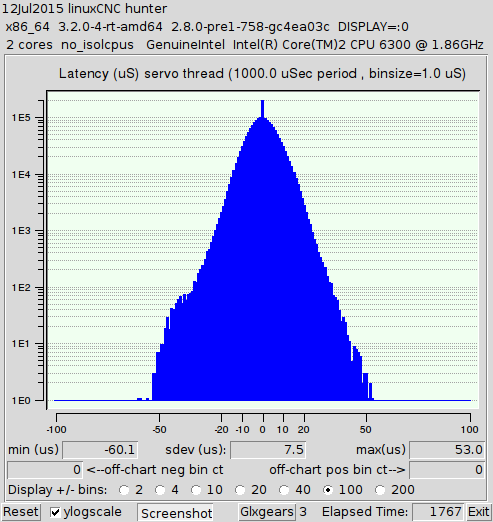

Finally have Preempt running, however having issues with graphics driver and Gnome 3. Accidently installed Jesse yesterday, and really liked the LXDE desktop. Need to figure out how to get that on Wheezy.
Numbers are closer to 20us, with far fewer outliers. Will repost numbers after I sort out the graphics problems and run it through the paces.

Well I've tried to plug in both an E8500 and a Q9550, but have found that the particular version of my Dell motherboard (0DN075-70821-73K-50AX) is not compatible with CPUs outside of the Conroe family (FSB@1066MHz vs 1333MHz). For each cpu, the fan goes to 100% speed on both the CPU and the Graphics card with no beeps or post screen. Was hoping a BIOS update would add either one, but no luck. Will have to settle with the existing performance on this machine. The numbers I reported earlier were not not really a torture test on the system, now sitting at a peak latency of 55uS.
Multitasking capacity has been greatly reduced from RTAI, which I would expect given that latencies have improved. The latency test will only open about 4 GLXgear copies before the system will not allow other applications to load. Beyond this, I need to close one instance to open another. CPU load is 100% at this point.
