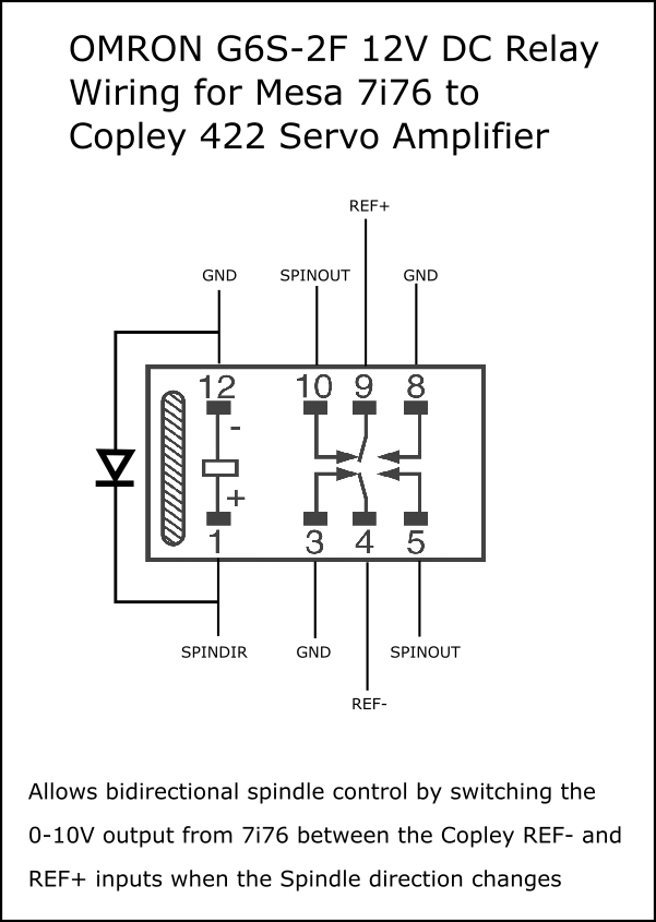

Do you need to reverse the spindle? If not, then you might be OK.
The cheapest extra Mesa card to do the job is store.mesanet.com/index.php?route=produc...83_88&product_id=122 (which would connect via the smart-serial port on the 7i76). I did read the part where you said you didn't want to do that.

The simple solution might be a DPCO relay controlled by the 7i76 REV output. It seems inelegant, but ought to work, I think. Though I would prefer something solid-state.

15 Oct 2017 10:48 #100382
by pippin88
Replied by pippin88 on topic Recommend me a servo amplifier / driver / h-bridge
Andy,
Thanks, I got it working (sort of - need to sort reverse speed).
Omron G6S-2F 12V relay - DPDT relay
Wiring:
SPINDIR+ = 12V
SPINDIR- = Relay coil +
Flyback diode across relay coil
One pole of relay has:
NC - SPINDLEOUT
NO - Ground
Other pole has
NC - Ground
NO - SPINDLEOUT
Relay outputs are connected to Copley 422 amplifier REF+ and REF-
Problem at the moment is that forward works at the correct speed, but reverse does not get to full speed. I'm sure this is a software problem, as when I invert the SPINDIR in HAL, reverse works at full speed and forward does not get to full speed, therefore it isn't a motor / amplifier problem.
Wiring:
SPINDIR+ = 12V
NC - SPINDLEOUT
NO - Ground
Other pole has
NC - Ground
NO - SPINDLEOUT

15 Oct 2017 14:49 #100391
Replied by PCW on topic Recommend me a servo amplifier / driver / h-bridge
Make sure you use the absolute spindle speed command (negative numbers for spinout will cause problems)

16 Oct 2017 05:15 #100424
by pippin88
I am using the absolute speed command.
I have tracked the problem further, it appears to be due to single ended signal into the differential input on the drive.
Measured at the servo amplifier input:
REF+ grounded, and REF- supplied 10V results in full speed
REF+ supplied 10V, and REF- grounded results in about 800rpm which then drops to about 700rpm.
