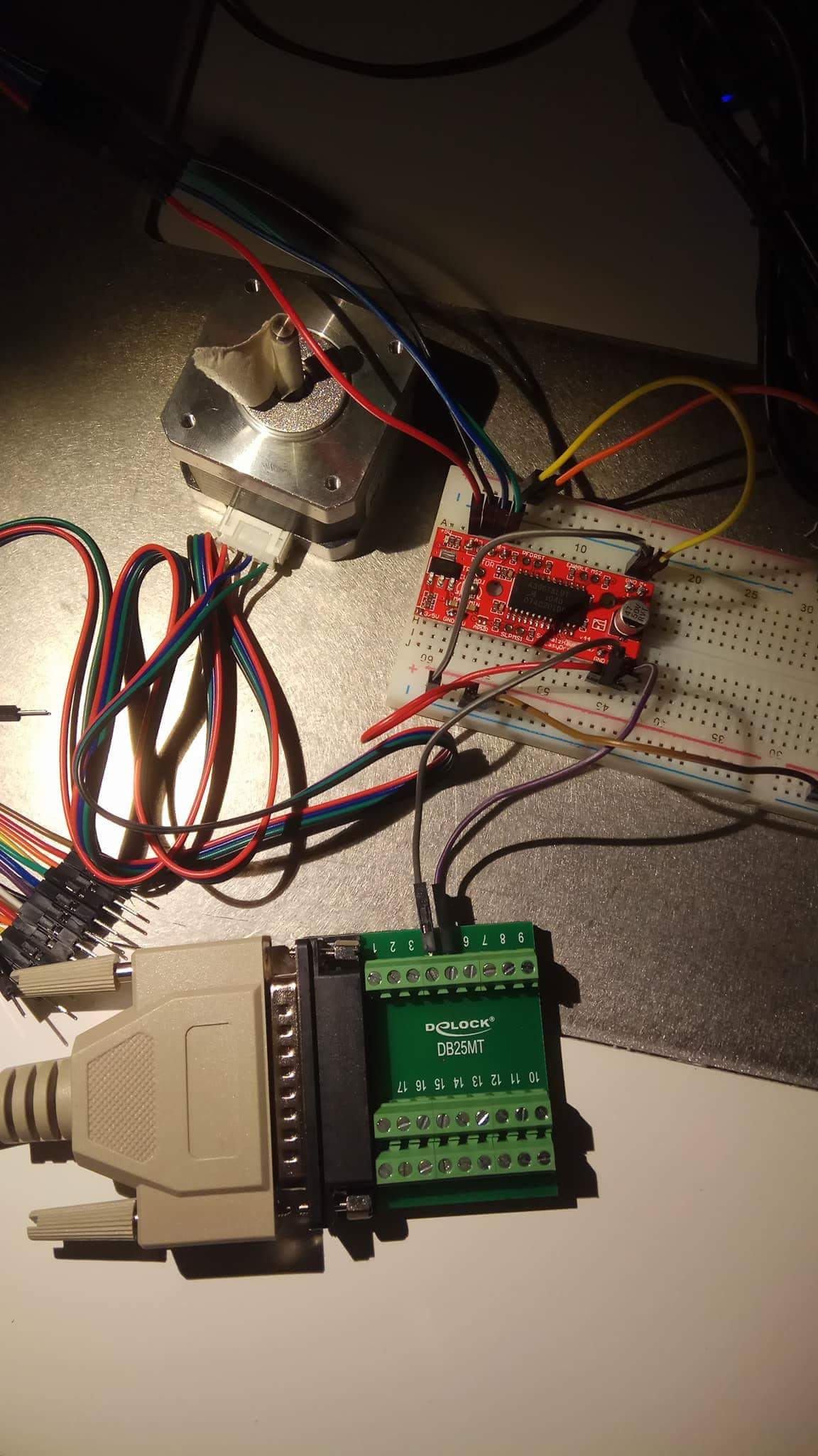

I have bought a simple step/dir driver to get to know linuxcnc as suggested by someone on the forum.
So I got the easydriver from schmalz and one NEMA 17 motor.
I followed the connection diagram. 12v power in and connect step, dir and ground. And I checked the wires coming out of the motor to connect correctly to coil a en b.
I attached my parallel port with a extension cable and a special header with screwlocks to easily connect the wires. I run the parallel port test program found in the wiki. I get voltage changes on every pin when I do that. In bios my parallel port is set to bi-directional. Address is 0x378.
I opened linuxcnc stepconfig. I left everything there standard and went to y axis. Cause I connected pin 4 and 5.
When I click test axis, whatever I do nothing happens. I checked the voltage on pin 4 and 5 when I press the buttons. pin5 will have 3.10 v to 0 and the other way around depending the direction I click. Pin4 goes from 0.07 to 0.11v when I click the jog command. So it seems the parallel port is working.
So why isn't the motor spinning.
I am noob, just learning my way little by little. Hope someone can help me out how to get this working.
edit: have tried to move the motor shaft when power is on, it can't be turned. I tried to manuall like morse code tap the step with 3.3V and the motor spins around. ( I can not get it to spin the other direction using 0 or 3.3volt to the dir pin and simultaneous give morse code against the step dir. it holds in place but does make noise.
1. What i noted too, When i measure the powervoltage over pin 5(dir) and ground pin 21 without having a wire from the driver to ground, i get 3V but when i connect the ground pin from the driver ( ground, step, dir ) to pin 21. Than i only get 0.22v over pin 5 and pin 21. It's like when in complete the loop as it should the voltage drops down completely.
2. Well i think to be short the following is a major problem. Whenever i click, test the motor ( run command in testpage ) the voltages drop from 1.15 to 0.07 on both step and dir pin during the entire run command. That doesn't make any sense to me. Shouldn't there be higher power to the pins on a run command????
Help pls.

My best guess whey it would not step when connected to the parallel port is because it looks like you did not have a ground wire connected between the parallel port (pins 18-25) and JP2 pin 1.

Alright.
I tried aswell with the ground wire to pin21. Picture was after that attempt.
When I had it connected it was like my voltages on the pins were even lower, including on the dir pin.
JP2 to pin 1? What is that exactly? I have read things about JP2 , on the board where is 3/5 V. That's when I fried the board. So what and where is this JP2 thing? And why pin1. What does that do?
Edit. I found in schematic that jp2 is the step,sir,ground location. So step to pin4 - dir to pin5 and ground to pin 21. But I tried this, it didnt do a thing. So question is what needs to go to pin1 ?

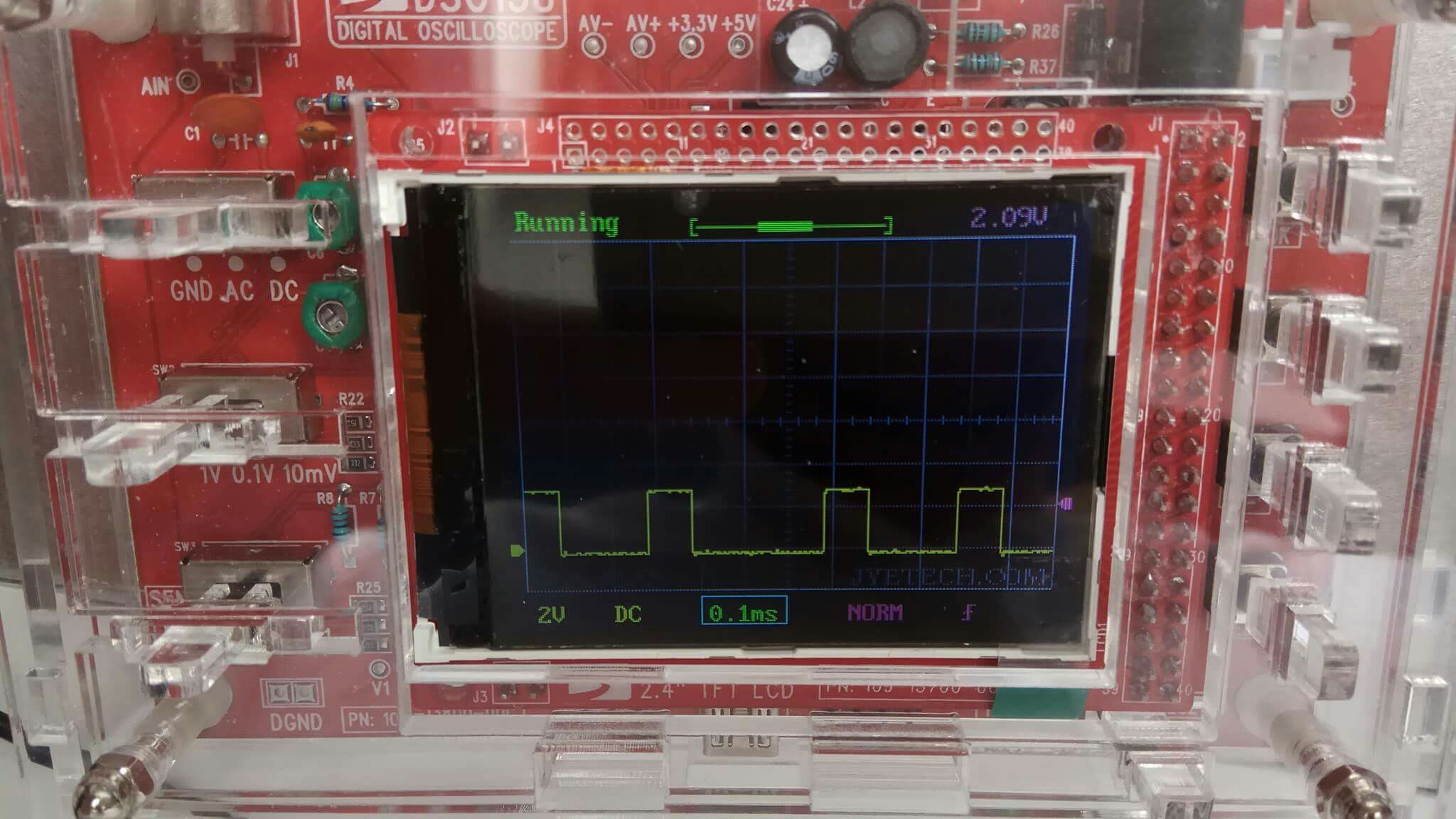

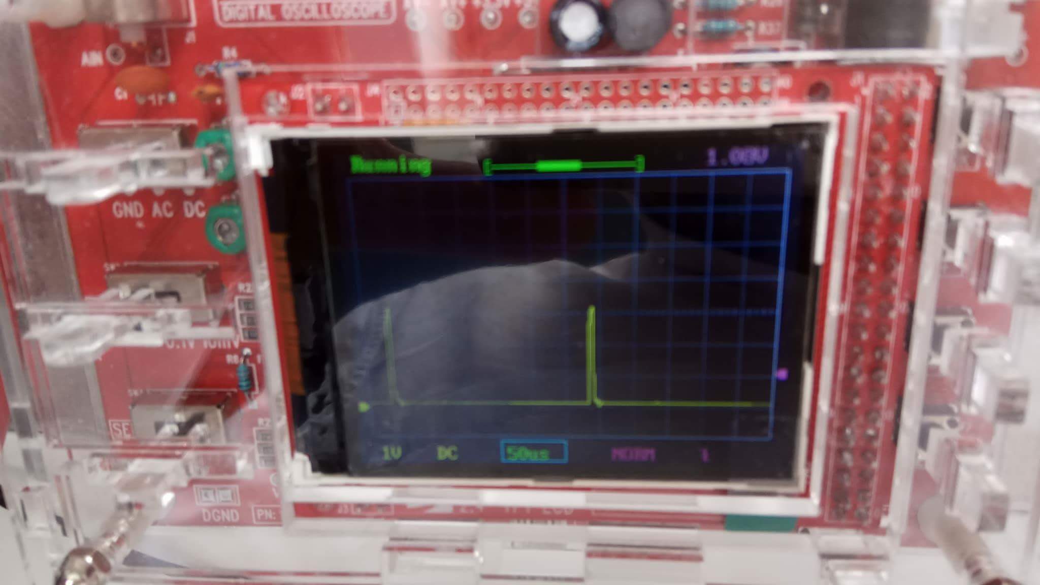

Hi all,.
So I have one oscilloscope and connected it to my parallel port. I have here 2 pictures of the result. When I click jog in the test x axis stepconf wizard .
1 is working on sensitivity of 1v and 50microsec.
2. Is working on sensitivity of 2V and 0.1millisec.
You can see the pulses. Only thing I am wondering now... Are these pulses strong enough for the easyDriver to see as both are falling under the 3v. I thought the easyDriver needed 5v step inputs. If this is not strong enough voltage wise how to solve? Also I am getting tb6600 drivers in tomorrow. Again for testing. Would these pulses do?
