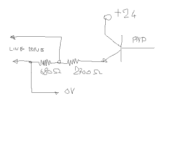

I have a plc PNP output +24V that can drive an axis in Puls Dir mode .... but it is open collector and my drive receive only Line Driver 5V signal .... so I came up with the idea of doing a simulation of the line driver communication as seen in the poor design attached .... I'm doing right or I will not get any results?
the schemas:
I need someone can check my work.
regards
Giorgio

A line driver input will need to have a positive and negative difference between the input pins to recognize both states.
One way to do this if driven from a single ended source is to tie one of the differential inputs to a 2.5V reference
(made with 2 low value resistors (say 47 ohms x2 ) and a 5V source) Then if the other differential input is driven from
0 or 5V the difference between differential inputs pins is +2.5V or -2.5V

@PCW so my error is to tie one differential input to 0,xx V and not to a 2,5V?
My schems is 24V powered, but with these resistor perform 0,xxV at +ref input when plc output have no signal, and +5V at +ref input when plc perform the signal. -ref is always at 0V. So in differential mode it should be 0,xx down, 4.xx up and so on .... these is right or not?
Anyhow hanks for your reply.

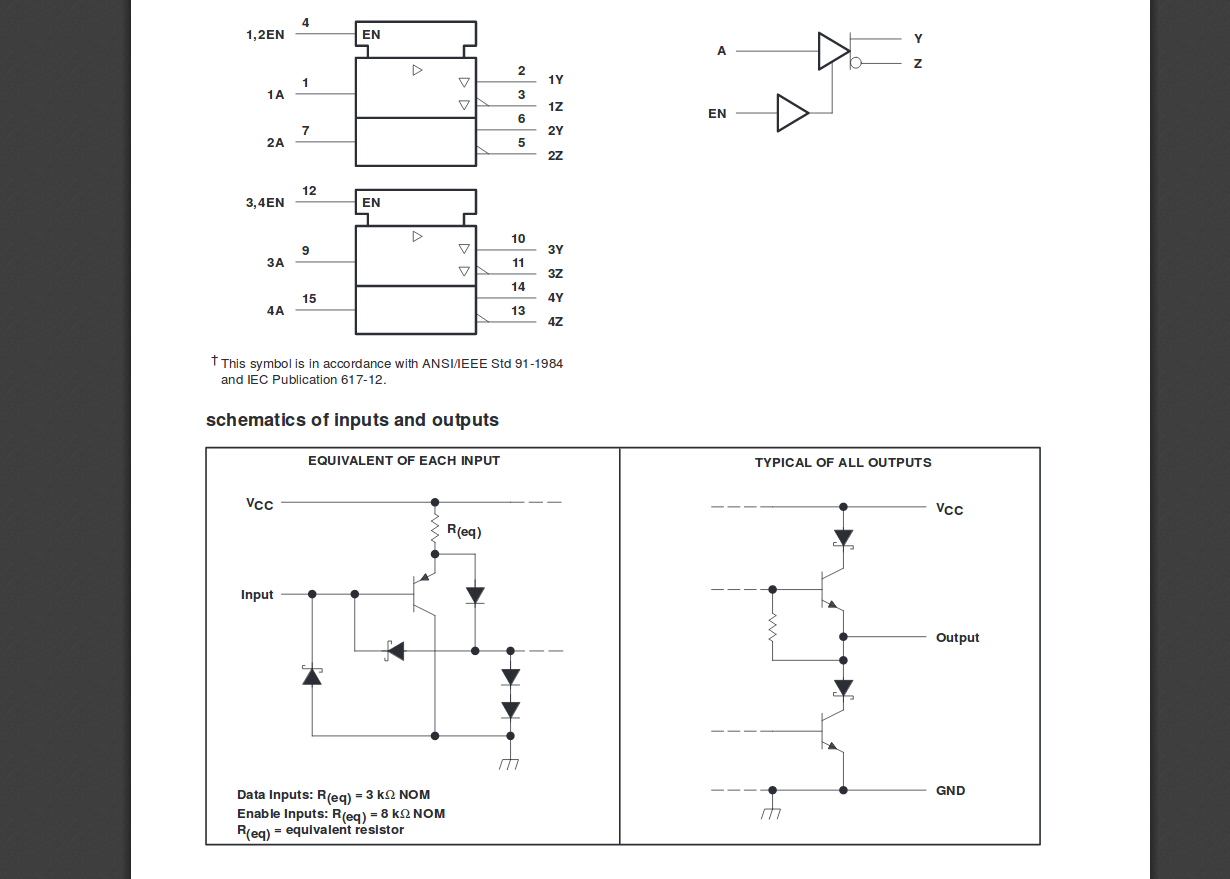

I have always used this: sn75174 or an equivalent.

thanks .... I find only SN75174N version .... I think is the same ..... Whit these I can input my plc open collector output and obtain a normal differential output line driver is Right?
for more precision:
1) I must put Enable IN at hight level
2) use 1A channel as pulse signal from my plc
3) obtain 1Y and 1Z as puls+ & puls- signal for my ServoDrive.
Is all right?

Yes, right.
you can use the divider to reduce 24 volts to 5 and you're good to go.
the same for "dir"
if half do not use it, put it low en pin
regards
