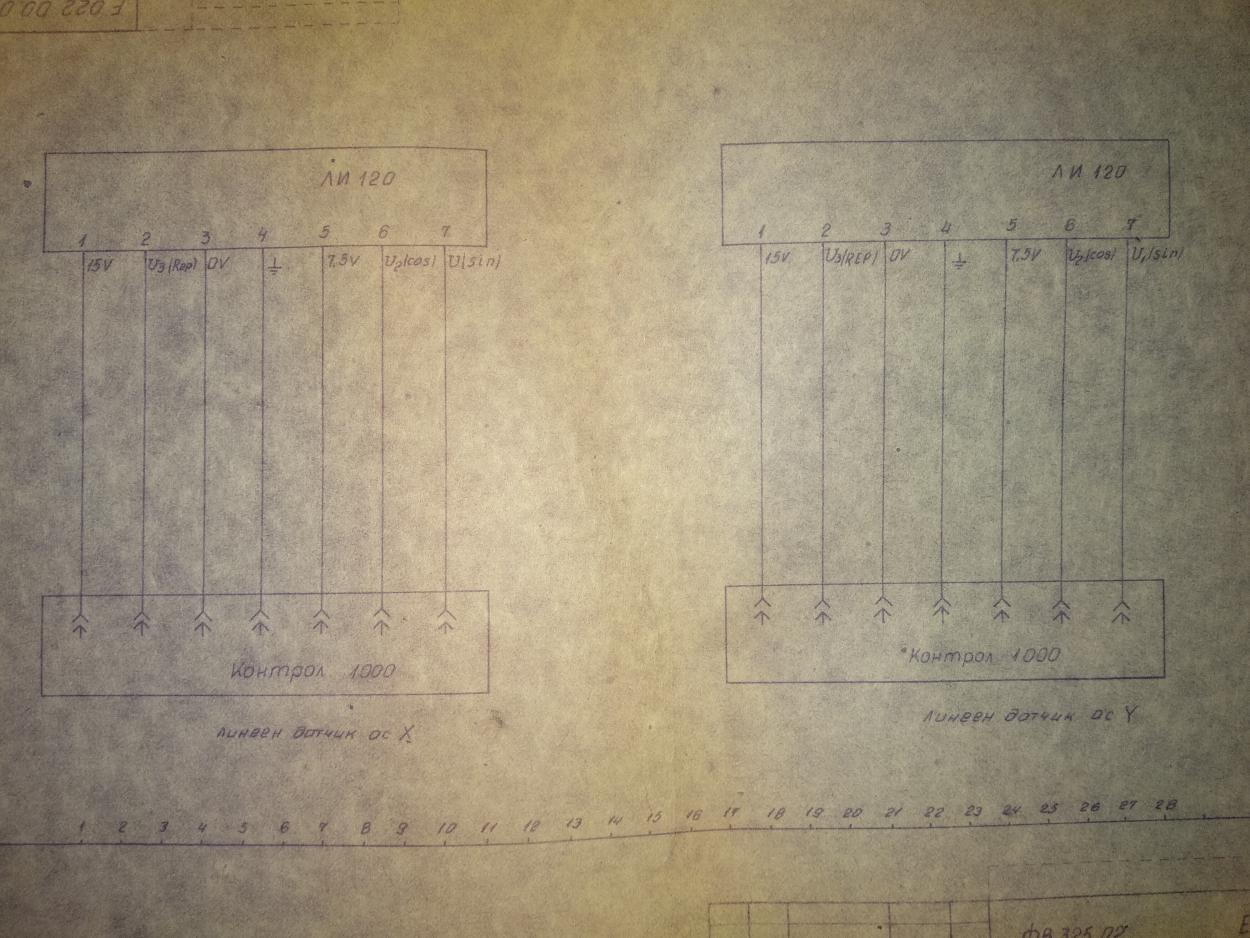

I have an old milling machine (1989) that has linear scales installed.
Scales seems to be analog sin-cos 1Vpp they have 6 wires go to old controller.
How to identify the wires and how to connect to mesa fpga card ?
Can i do a circuit to convert the sin-cos wave forms to square A-B that accepts mesa card?
Is better to replace these scales with digital scales that output square AB differential signals ?
With 280euros i get 3 new digital optical glass scales + 3 axis DRO
So what to do keep the old scales or to replace ?

The Arduino thing never worked particularly well, I can't really recommend it.
Try searching eBay for "heidenhain EXE". Those are specifically for converting linear scales to quadrature.
The STMBL servo drive can read such scales too. In theory you could build just the important parts of the LV board and use one without bothering with the power board.

Witch Heidenhain EXE to get ?
Heidenhain Encoder Interface EXE 702 B is ok ?
I see that exe is for 11 μA PP and IBV for 1Vpp
