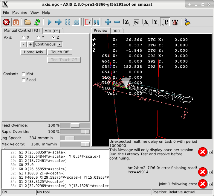

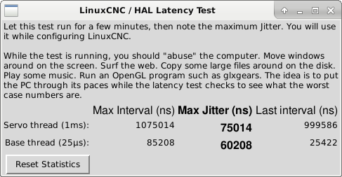

I'm trying to finish up my configuration tool but I keep getting a joint following error when I jog an axis. The sample configuration is attached. I'm running master uspace 0b443d. Latency test servo thread 52,000.

Replied by PCW on topic 7i96 Joint Following Error
As we discussed on IRC I suspect your host has poor enough Ethernet latency that some packets are timing out. At the sample configs high speeds (1200 IPM = 20 IPS) a missed packet will result in LinuxCNC using stale position feedback data from the stepgen (and 1 ms stale data would result in a 20 mill following error at 20 IPS)
Its possible to work around this error by "short-circuiting" the commanded stepgen data to the feedback data if a packet error occurs. As long as the errors are infrequent, very little actual position error is cause by a missed packet
Here is a hal file that implements this scheme:
You can also work around the issue by just setting the following error limit to > maxvel*servothread_period
but this has 2 bad side effects: 1. you need to set large following errors so you may miss real problems, and 2.
The PID loop "sees" the bogus stale position data and does a bogus correction, causing a real glitch in the
stepgen position tracking

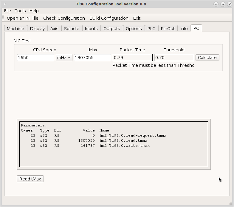

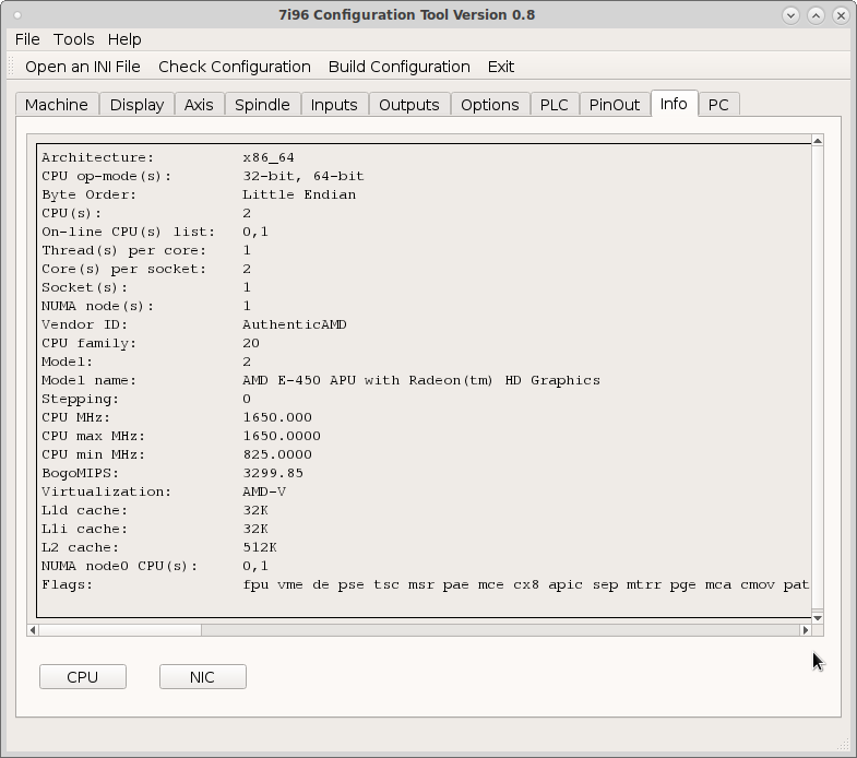

Kinda glad I had a slow pc to test on. I added a couple of tabs to the 7i96 Configuration Tool so you can get the CPU info, NIC info and the tmax. Then added the calculations to show if the packet time is faster than the threshold. What would be a good percentage for packet time to threshold time?
JT
Its a bit subtle because you can make a working system that occasionally drops packets whether from excessive latency or EMI.
In my experience with Preempt-RT, Large Ethernet latencies happen infrequently so its possible to set the threshold to say 1/2 of the max number and only have very occasionally dropped packets, if you add the fix for timed out packets, you will like never notice the dropped packets at all.
If on the other had you never want to have a timed out packet, I would set the timeout to say 70% and make sure the latency is never more the say 35% when tested for an hour or so
In any case its great to have the actual Ethernet timing numbers available in the utility
You might want to indicate that the .79 and .70 numbers are in units of servo thread period
(and perhaps show them as 79 and 70 %) and perhaps suggest increasing the thread period if the number is more than
50% of the total servo thread time

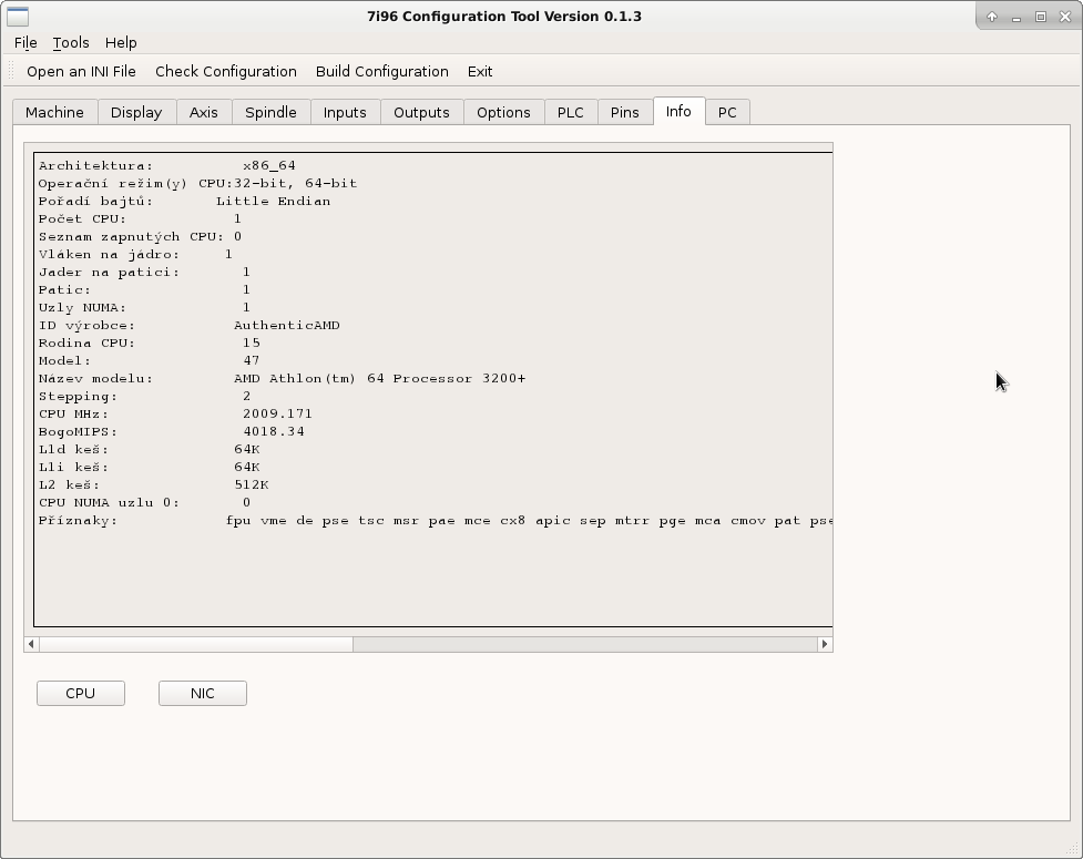

- zz912
- Posts: 596
- Thank you received: 98
09 May 2020 14:37 #167166
by zz912
Replied by zz912 on topic 7i96 Joint Following Error

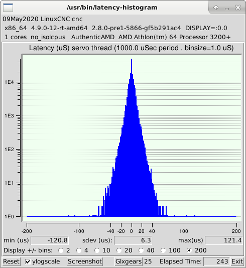

- Posts: 18119
- Thank you received: 5337
09 May 2020 14:45 - 09 May 2020 14:46 #167167
1. Have you disabled all power management in the BIOS?
(disable all turbo modes, speed-step options, cool-and-quiet, cstates >1 etc)
2. Have you run a standard latency test?
I suggest:
latency-histogram --nobase --sbinsize 1000
Run this for at least 10 minutes while opening windows, doing fie transfers,
watching you-tube videos etc and post the results here
I suggest:
Last edit: 09 May 2020 14:46 by PCW.
- zz912
- Posts: 596
09 May 2020 15:44 #167174
by zz912
