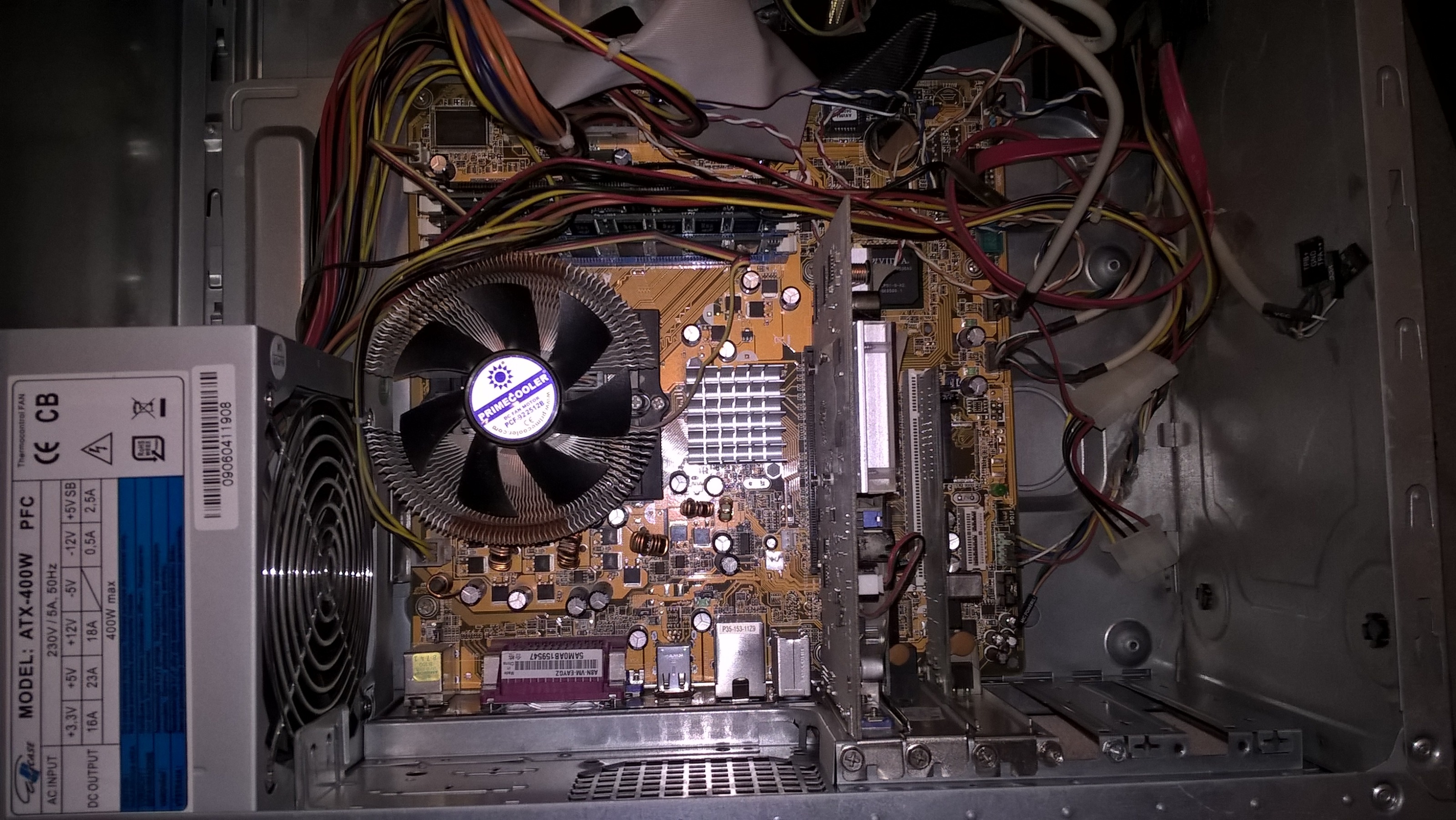

10 May 2020 03:53 - 10 May 2020 03:55 #167243
by zz912
What information do you need? I am not Computer specialist.
Paralell port loose steps.
MESA - NIC test is not OK.
BIOS is problem for me. I dont understand this, so foto can be downloaded here: www.uschovna.cz/zasilka/YCZ8TCXT5ENUPIDJ-85U/ (it is big) STÁHNOUT VŠE JAKO ZIP = DOWNLOAD ALL LIKE ZIP
Replied by zz912 on topic 7i96 Joint Following Error
What pc is that?
This is the worst information for me. I am still wasteing money and wasteing time with founding hardware for my CNC.That all looks ok
Last edit: 10 May 2020 03:55 by zz912.

10 May 2020 12:57 #167292
by zz912
It is custom made one. This computer is my friend. My friend has a friend who has a computer repair shop. He composed this one from his old computers. My friend's friend will help me, but I need to know what I need.
He can repair a computer, but does not understand the issue of Latency.
I didn't find any markings on the motherboard. Is it possible to find out the name of this motherboard from Linux? The motherboard manual would help me a lot.
What is written on the PC ? It must have a name somewhere or a model on the back side ?
Or is it a custom made one?
- Posts: 22036
- Thank you received: 7504
10 May 2020 13:12 #167293
Replied by tommylight on topic 7i96 Joint Following Error
That is quite old, something like 17 to 19 years old, it has an Nvidia chipset on it.
You will have to deal with BIOS settings, or you can take pictures of it and post it here so we can try to figure out what to disable and what to enable.
BTW, if you see "gate A20" that must be enabled or set to fast, otherwise everything will be slow on it.
