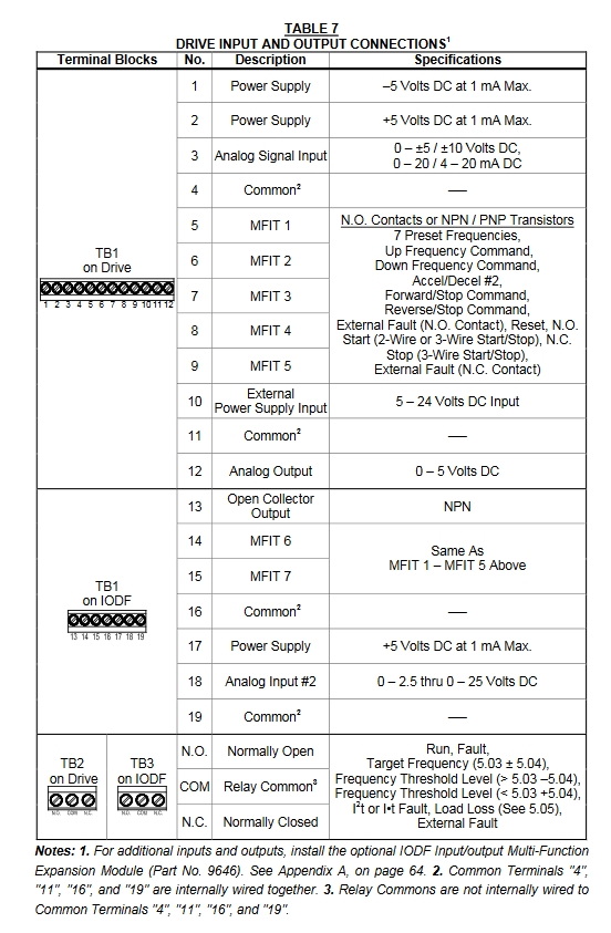

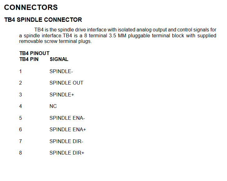

on the Mesa Board the VFD is wired to TB4, this is how i have it wired so far.
TB4 VFD Side
Pin 1 (Spindle -) --> Pin 4 (common)
Pin 2 (Spindle Out) --> Pin 12 (analog output)
Pin 3 (Spindle +) --> Pin 2 (+5v dc)
Pin 4 (NC) --> Unsure
Pin 5 (Spindle Ena -) --> Pin 11 (common)
Pin 6 (Spindle Ena +) --> Unsure
Pin 7 (Spindle Dir -) --> Pin 11 (common)
Pin 8 (Spindle Dir +) --> Unsure

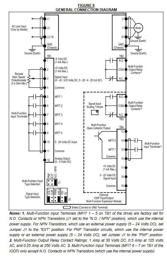

07 Nov 2018 10:25 #120160
The 7i76 "enable" and "direction" outputs should be considered to be switches, so wire them as shown in the VFD figure 6.
7i76 + terminal goes to VFD 5/6/7/8/9 (as required) and 7i76 - terminal goes to common.
Reading the text below the image it states that if the jumper is set for NPN (default) then the digital inputs use the internal power supply and there is no need to connect to terminal 10.
(Typically a VFD does not need an external DC PSU to work, in the vast majority of applications that would be inconvenient.)
Replied by andypugh on topic 7i76 VFD Wiring Help
do you know what the signal needs to look like for pin 6 and 8 on TB4?
