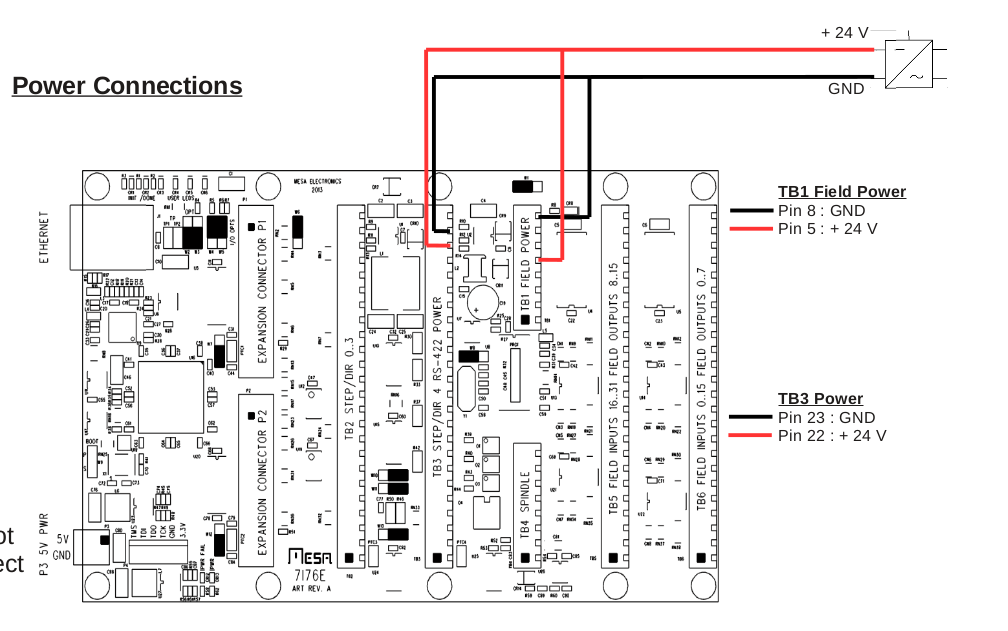

Hello,
i found several power connection for the mesa 7i76e card. One is 5V on Vin and 24V on TB1 Pin 5 and 8.
Second 24V over TB1 Vin Pin 2 and 3 plus Pin 4 and 8 on TB1 like you can see in picture. But i am confused what is the best way and how to set jumpers?
The easiest way is second one. I need only one power supply.
What could be the reason of many possibilities and what do you recommend?
Thanks, Christian

Replied by PCW on topic Power connection mesa 7i76e
+24V --> TB3 pin 21,22 TB1 pin 1,(2,3,4)
24V Common --> TB3 pin 23,24 TB1 pin 8
(W1 left)
Will allow the complete 7I76E to run from a single 12 or 24VDC supply
with the proviso that the logic and field I/O sections share a common ground
(W1 left)

Replied by newbynobi on topic Power connection mesa 7i76e
i made The document you attached , if you look at page one or two, you will notice the jumper settings belonging to my connection sheet.
Norbert
Norbert

Hello forum
i connect this way. Unfortunately i test my multi hand wheel today. I think i made a mistake and now the logic side is black. But if i connect 5V to logic side works everything fine and also all digital inputs working. So i hope there is only a fuse broken. Does anyone know what could be burned?
Thank you Christian
Thank you Christian
If you accidentally overvoltage the 5V logic side of the 7I76E it will likely damage the 5V regulator, you can bypass this as you learned by supplying an external 5V source.
I would check that the step/dir outputs work as the 74ACT buffers that drive these pins will get damaged by more than 6.5V

Replied by chris@cnc on topic Power connection mesa 7i76e
I look for the mistake and found out what happens. I have not soldered the hand wheel cables in the correct line and shorted between 5V logic and field side.
Never trust this 25 sub D socket.
This 5V on step side are okay i hope i can work again with the second power supply.
