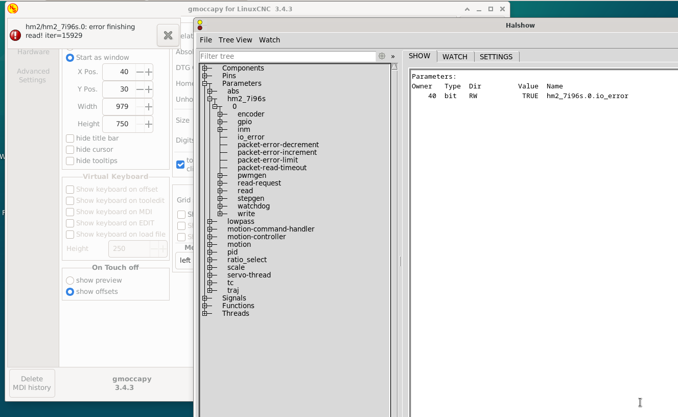

10 Oct 2023 12:59 - 10 Oct 2023 13:05 #282684 by Boogie
Replied by Boogie on topic Mesa 7i96 Installing to Run
Thank you! Downloading for evening session after wok!
I can see the file name is saying:
LinuxCNC_2.9.pre-amd64.hybrid
suggesting amd64, not x86?
Last edit: 10 Oct 2023 13:05 by Boogie.

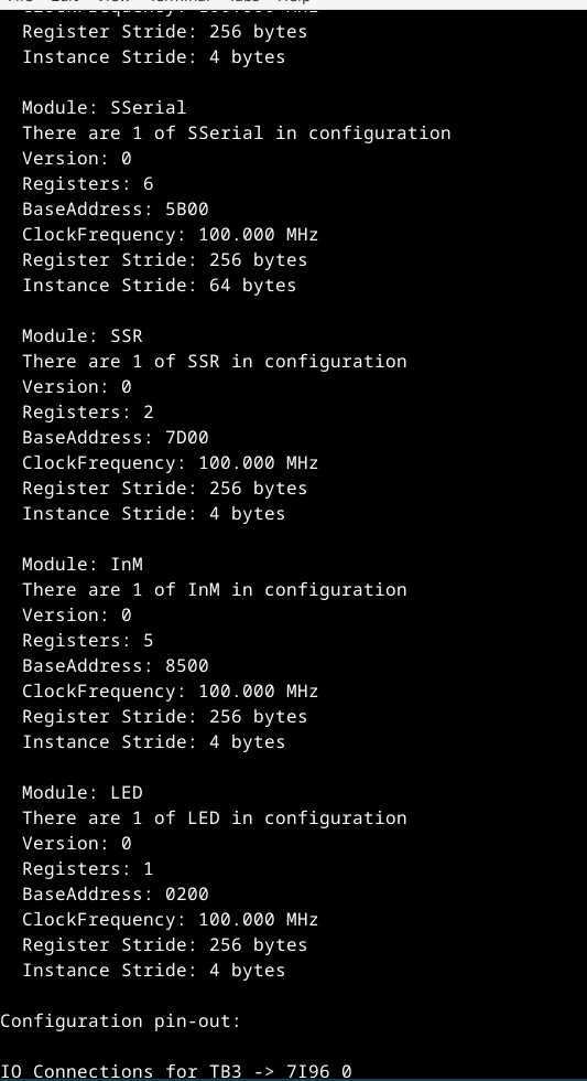

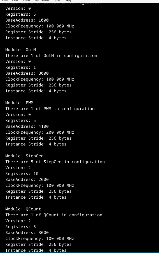

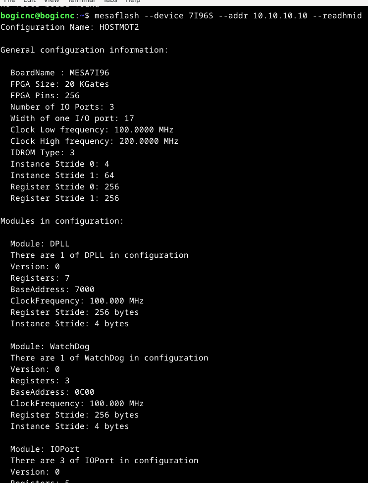

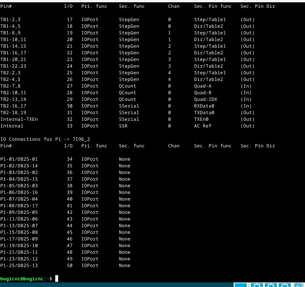

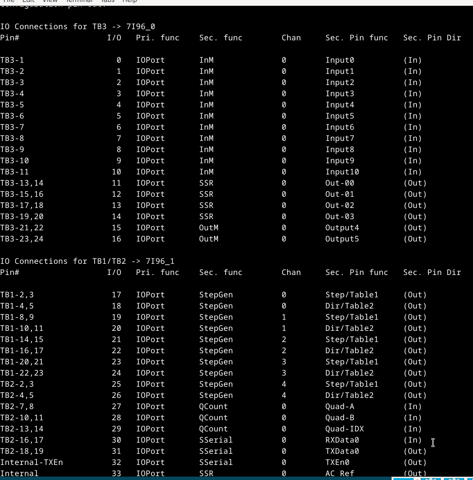

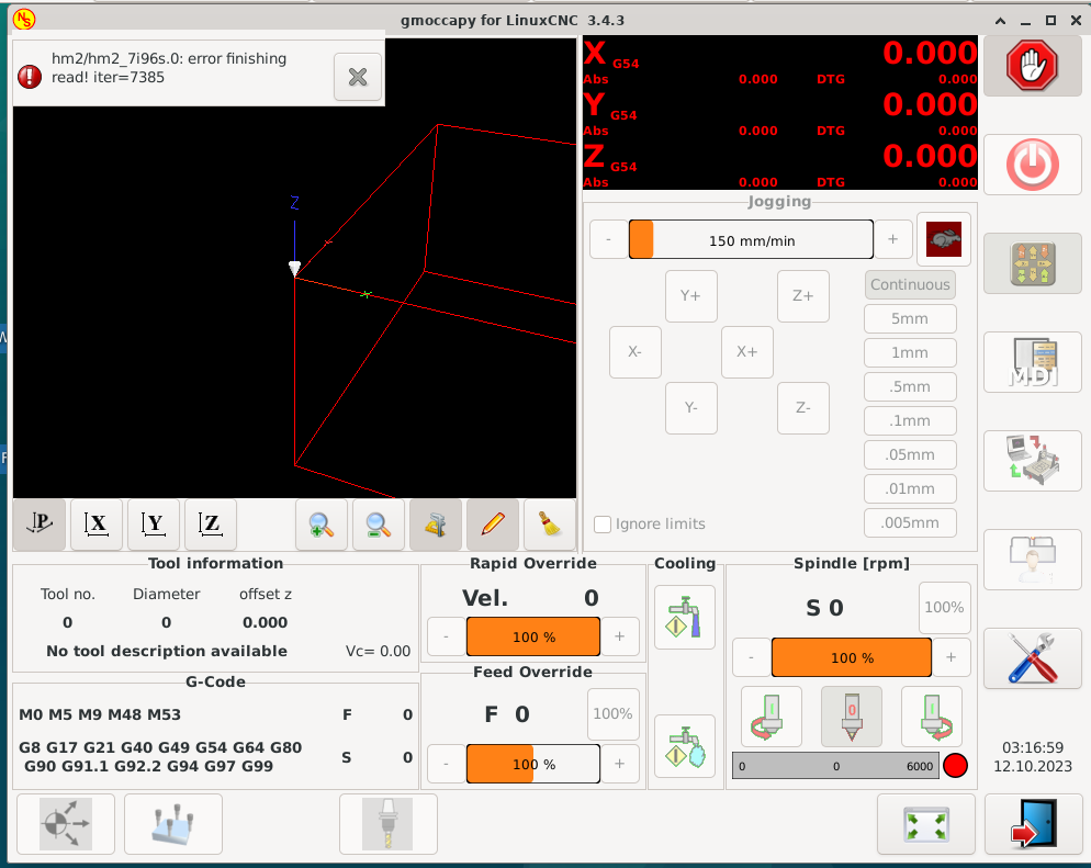

12 Oct 2023 02:19 #282790 by Boogie
Almost there, almost there:
as per RODW advice i used his image and installed linuxcnc. This installation is next to ubuntu 22.04.3 i have on the same drive. All went fine. Then i went through this to set up connection PC-Mesa over ethernet cable:
forum.linuxcnc.org/27-driver-boards/3559...ethernet-mesa-boards
Looked so good. So i started Linuxcnc Pncconf Wizard, picked standard xyz machine, basically i followed this:
wiki.printnc.info/en/controllers/Mesa_7i96_Guide
and looked fine:
so started Linuxcnc. Loaded with no errors... But in couple of seconds CR6 LED on Mesa (next to eth port) turned red and i got this message:
I have two wired connections now:
1. the one i'm using now to talk to you guys - over USB cable via my phone sharing internet
2. the one for Mesa using laptop gigabit eth port. Mesa is on 10.10.10.10.
I have connected nothing to Mesa. It's just sitting on my desk, powered up vie laptops USB and connected to eth. I'm offshore now and i took Mesa card with me only...
I'm lost now. What should i check?

What else can be helpful to identify this issue?
Thank you!
