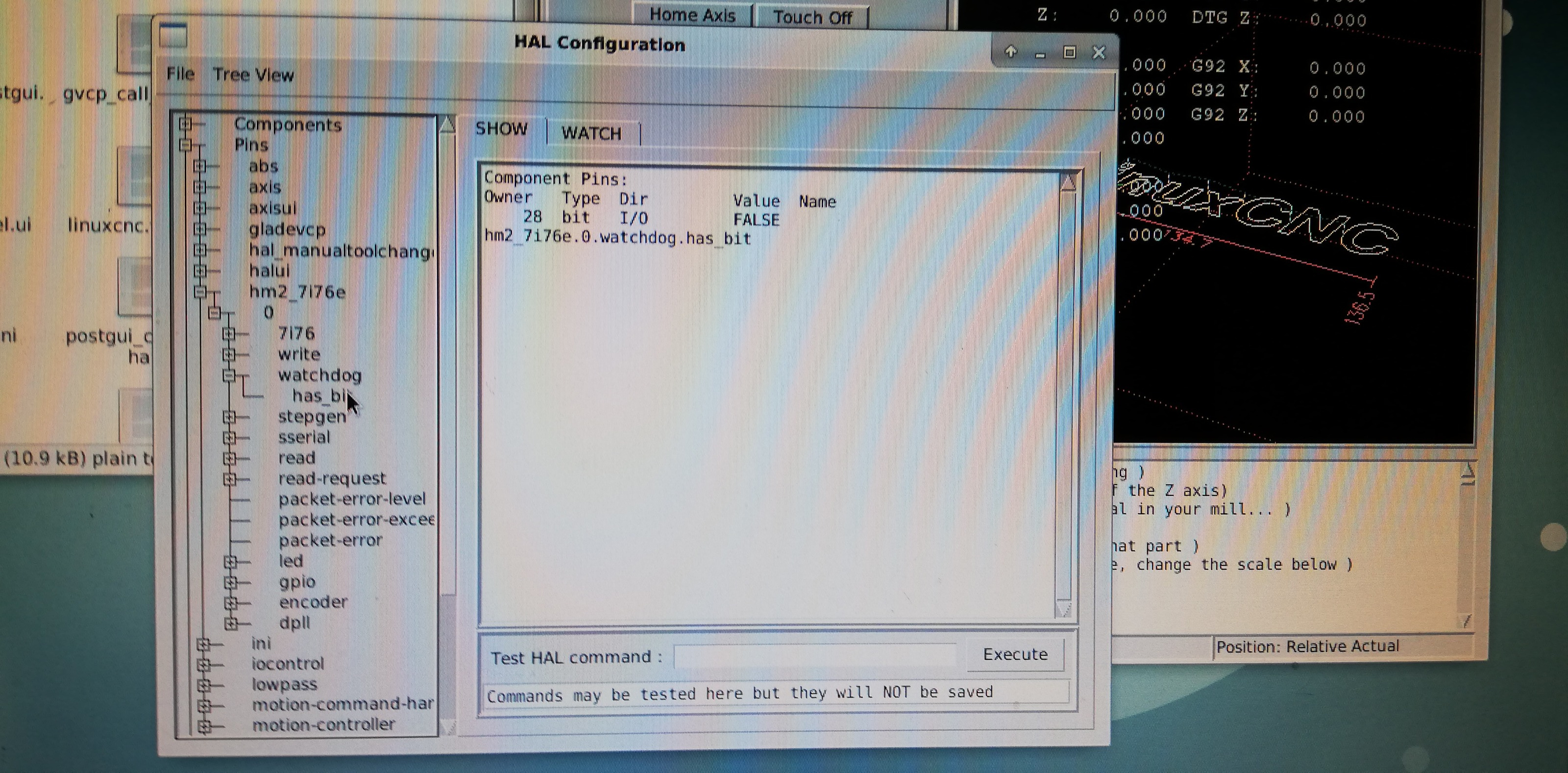

Today I made sure that the watchdog time was higher than the base thread. And disabled all power savings in the bios, at least as far as I'm aware.
That didn't change the fact that CR1 still comes on when I start up linuxcnc.
Now according to HM2 man the wachtdog pin should be high, but that isn't the case when I look in the Hal file.

Replied by PCW on topic Strange 7i76e problem when starting linuxcnc
This may just be an issue with the driver (some older versions of LinuxCNC have this problem with some firmware)
This should not affect operation as long as the watchdog bit is not actually set
