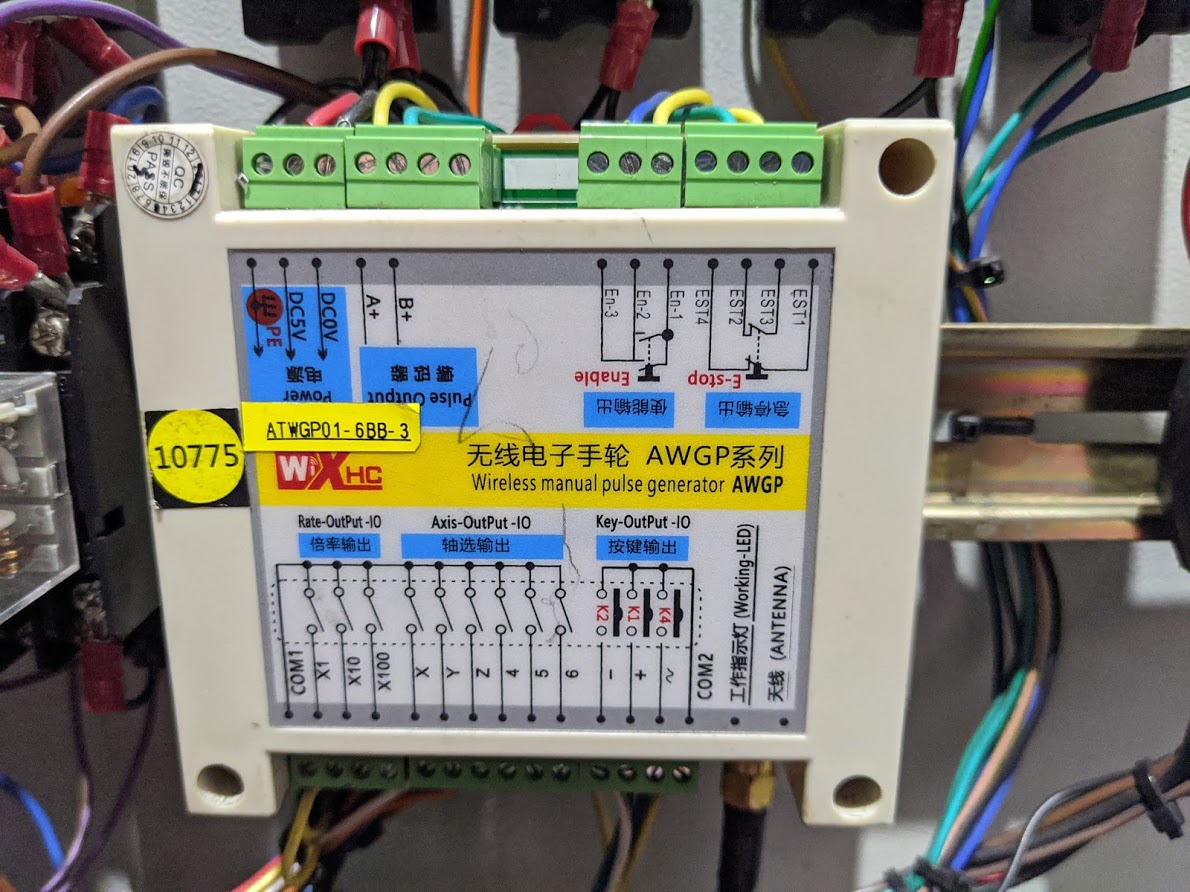

5 axis Pendant takes 9 + MPG, ATC + other system inputs takes another 13, home switches + limit switches is another 9, 6 Servo alarms, a few physical switches, I am using a crap ton.. yah... Even using up most of my BOB's IO..... (ATC + five axes uses sooo many pins!!!)

my pendant is pretty simple, but with 5 axis, 3 speeds and an e-stop it eats pins... kind of wish we were "smarter" about it I could express 9 values in 4 inputs if we were able to be really creative in the HAL..... But its all just hard switches no IC to convert to something more "compact"

Interesting.. What is the lag on those? I have a USB wired MPG on my Mach4 based 4'x8' router and the lag bothers the hell out of me.. My wife doesn't mind and sense she uses it the most (making small furniture) I have never dug into why there is a good 50 or 100ms delay between input and movement... Either way, I am sensitive to MPG lag as my old Adtech controller (the one I am replacing) had no perceivable lag and it was awesome..
Replied by jhandel on topic MPG encoder count by 4?
You think your pendant eats pins?
At least the axis select and the scale inputs are binary so not all pins are in use.
I just ordered a couple more of these wireless 433Mhz pendants with 7i76e and 7i73 so we will see how it goes.

19 Oct 2020 21:11 #186624
Replied by rodw on topic MPG encoder count by 4?
There isn't any perceptible lag or if there is, I have forgotten about it.
The only annoying thing is you have to toggle the estop on the pendant on and off when you first power up the machine but I'm sure that is for safety by design. It uses 433 Mhz wireless, not USB so it is allowed to be real time
I am lost without it!
