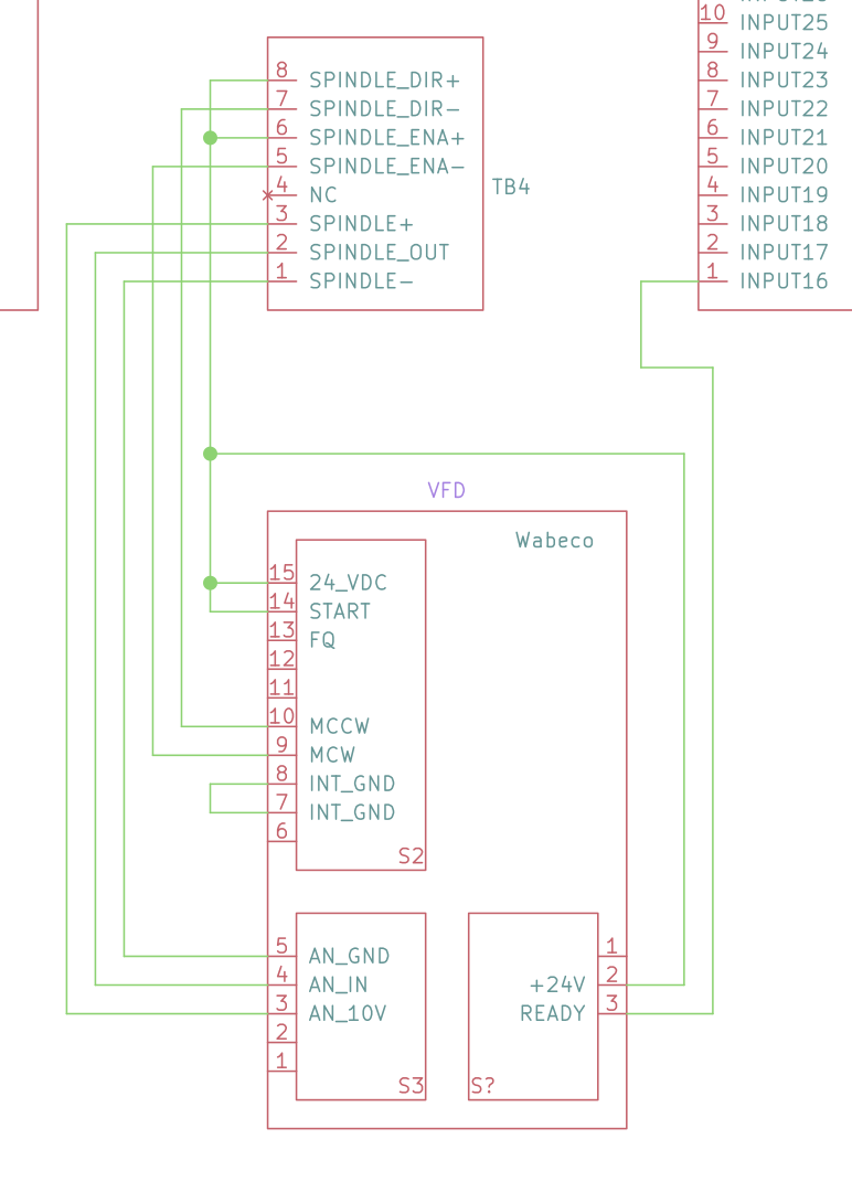

Hi there! I hope you’re doing well.
Before turning on the power, I would like to ask for a sanity check.
Wabeco VFD:
Mesa 7i76ED
From the manual: SPINDLE ISOLATED OUTPUTS
The 7I76E provides 2 isolated outputs for use for spindle direction control, and spindle enable. These outputs are OPTO coupler Darlington transistors. They are all isolated from one another so can be used for pull up or pull-down individually. They will switch a maximum of 50 mA at 0 to 100 VDC. The SPINENA output is special as it uses the same signal that enables the analog output. When the analog output is enabled, the SPINENA OPTO output is on.
And if I understand correctly, for clockwise rotation, I only need to enable analog output and it will turn on spindle in clockwise rotation.
And if +24V is connected to SPINDLE_DIR+, and SPINDLE_DIR is switched ON, SPINDLE_DIR- will output +24V signal, turning on spindle in counterclockwise rotation?
However I don't understand how I can turn off SPINDLE_ENA and keep analog output enabled? Otherwise both SPINDLE_DIR and SPINDEL_ENA output +24V.

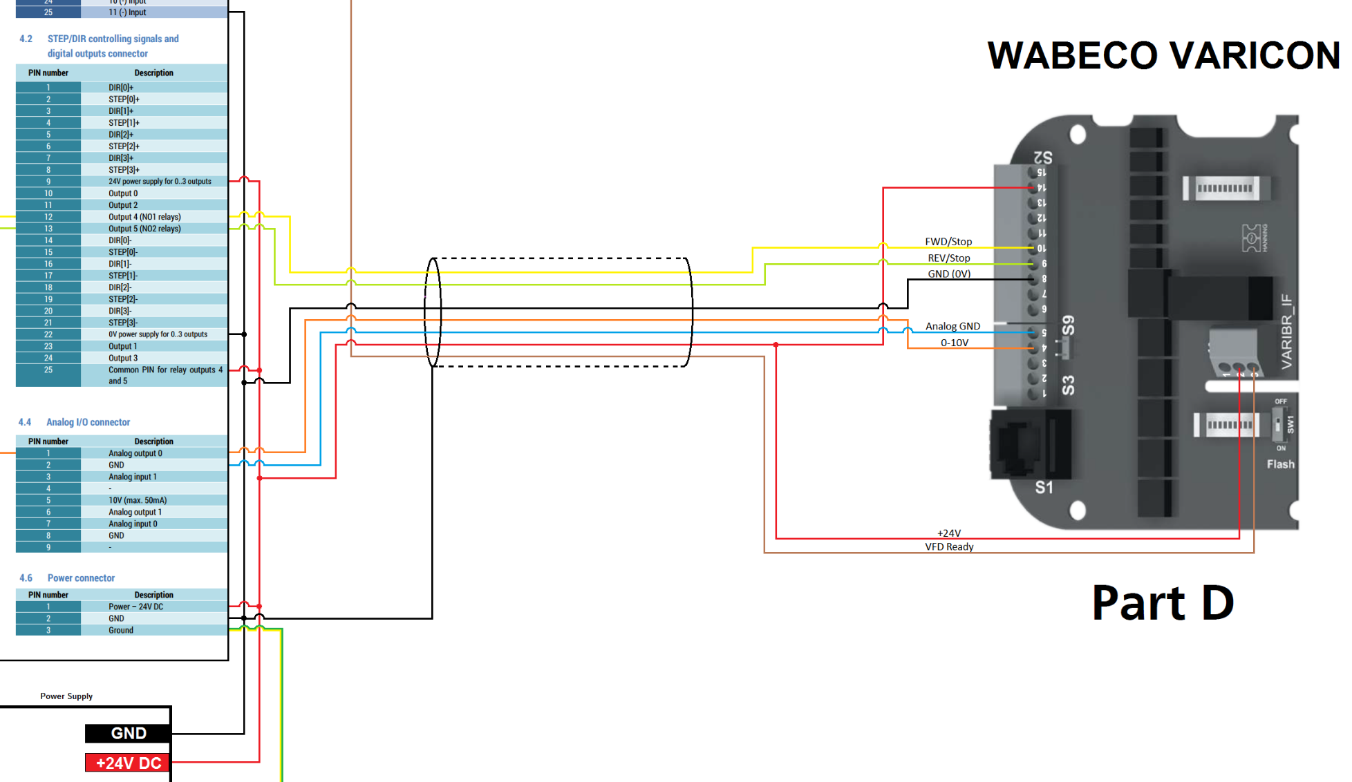

For the reference, I included wiring diagram for CSMIO-IP/M - its realized using two relays. Also analog wiring, from the milling machine is included.

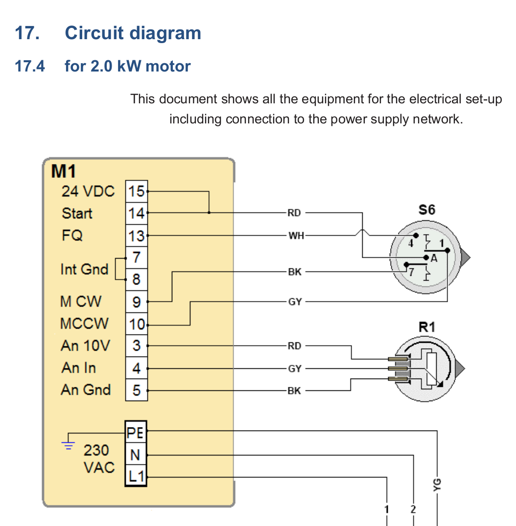

Wabeco VFD:
- Pin 14 (start) is connected to +24V
- Pin 13 (FQ) - no idea - maybe GND or -24V ?
- Pin 9 (M CW) - starts spindle in a clockwise rotation.
- Pin 10 (MCCW) - starts spindle in a counterclockwise rotation.
- Pin 3 (An 10V) - outputs 10V
- Pin 3 (An In) - analogue input 0 to 10V
- Pin 3 (An Gnd) - GND

No, that's not quite right. SPINDLE_ENA is just that. It enables the spindle drive, meaning it is activated whenever the spindle is commanded to turn either CW or CCW. Many drives have an enable input.
In your case you will need a relay that switches the enable signal to either the CW or CCW input of your VFD depending on the SPINDLE_DIR signal. So SPINDLE_DIR to A1 of the relay GND to A2, SPINDLE_ENA to the COM, MCCW to NC and MCW to NO of the contact
[edit]
And yes SPINDLE_DIR+ and SPINDLE_ENA+ go to +24V and the SPINDLE_...- terminal outputs the 24V if the respective signal turns on.
Analog output is correct as suggested
[edit]
