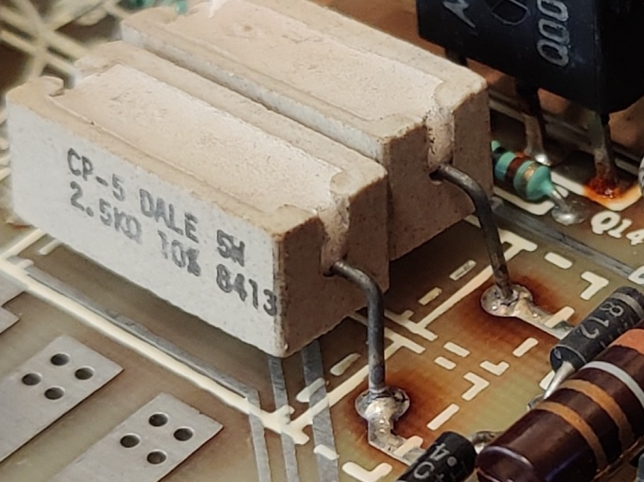

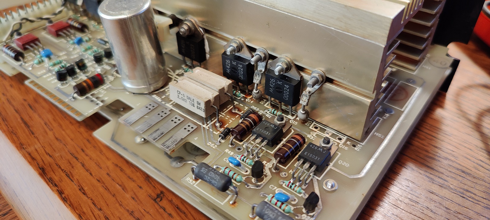

15 Dec 2020 14:56 - 15 Dec 2020 15:21 #192048 by Tom_R2E3
Or maybe there is a chance to repair the drive that I have.
There are two resistors on the top circuit board which look as though they have been hot. They are labeled 5W 2.5k Ohm but when I measure them I get 3.15 kOhm and 2.08 kOhm, could this be the problem?
I've attached a couple of photos. One of the legs on the transistor mounted behind them also looks suspicious.

15 Dec 2020 16:55 #192053 by Todd Zuercher
Measuring resistances of installed components can be tricky, because readings from surrounding items will screw up your readings. If you had reading even remotely close on a resistor like that they are likely ok. Resistors usually die by going open. But you should probably re-flow those solder joints, and any others that look like they may have gotten hot.
15 Dec 2020 17:05 #192054 by jmelson
Hi Jon, thanks for the info and suggestions. I didn't realise it would be such an expensive exercise to replace the drives. For something with 35-40A rating i'm looking at £800+ for the three, probably more like £1000

15 Dec 2020 17:08 #192055 by jmelson
You might resolder the leads on these resistors, sometimes after long periods of running hot, the solder "crystallizes" and you get bad contacts. But, those resistors don't look like they got hot enough to go bad. Most likely one of the power transistors failed. And, that may have taken other parts with it.
