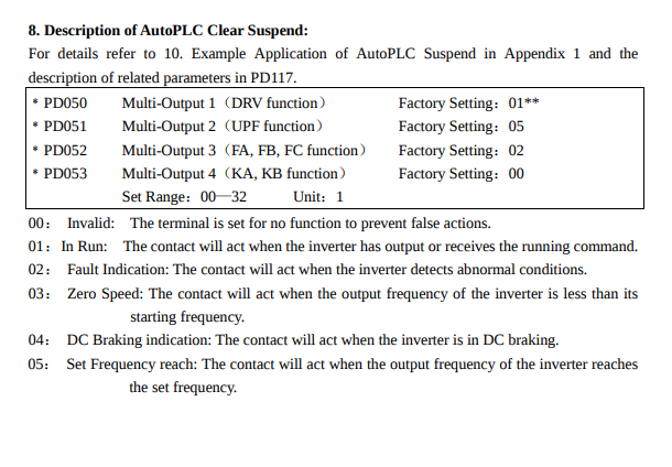

I have a 7i76e with a Huanyang HY series VFD, connected to a Raspberry Pi 4, running a CNC router. I'm currently using the Analog Spindle Control from the 7i76e, but I realized I don't have spindle-at-speed functionality (no encoder).
I'm thinking of switching to RS-485 control. Can someone confirm that spindle speed feedback is provided over RS-485 to enable use of the spindle-at-speed signal?

You have on your VDF a multi-output function. Adjust parameter by table and you have a spindle at speed signal or spindel lost speed signal. There are some more in manual...
Not necessary switch to sserial. But of course this is pretty cool and you can adjust some more and have life health information. But i can not adjust it.

Thanks chris@cnc. That's good news. I'll try wiring up one or more of those outputs from the VFD.
If anyone else has any input, I'm still curious just for the sake of learning, if there are any pros/cons of using RS-485 vs the 7i76e analog control.

You might actually be able to use the analog control you already have set up and use the RS485 just for reading the extra information you need from the vfd.
I found that, for some reason, using RS485 with my vfd was very slow for adjusting the spindle speed while machining.
