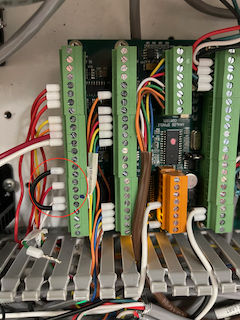

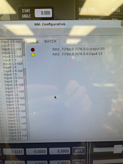

I have a 7i76e configured up, had some challenges along the way - seeing this:
Output-5 is high (connected to an LED indicator lamp) -
It's high @ power on, it remains high after booting linuxcnc
However halshow shows thatsignalpin as FALSE/Red
so I disconnected the led and looped output-5 back into input-15
Input-15 shows HIGH (in halshow) and output-5 shows FALSE
I've seen the same on output-4 but output-1 seems to do the right thing?
Wiring? something fried?
Thanks in advance
-jeff

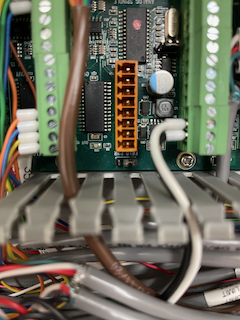

- Posts: 21898
- Thank you received: 7465
02 May 2021 15:21 #207636
Replied by tommylight on topic 7i76e output always high
As far as i can gather from the picture the loopback is wired to output 4, not 5.
It's at an angle so hard to make out where the pins are.
- jschi
- Posts: 7
02 May 2021 15:28 #207637
by jschi
Replied by jschi on topic 7i76e output always high
you are correct - I have the same issue on 4 & 5

- bevins
- Posts: 1947
- Thank you received: 338
02 May 2021 15:31 #207639
by bevins
I zoomed in and it does look like output 4.
Replied by bevins on topic 7i76e output always high
