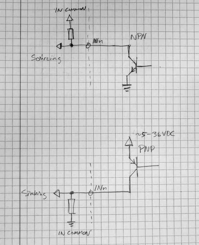

Replied by PCW on topic Mesa 7i96 mixed voltage field input wiring
Assuming a 24V field voltage and conventional current flow for simplicity.
Sourcing inputs have the input common tied to +24V (so they "source" current)
They are activated by connection to ground (a sinking or NPN type sensor)
Sinking inputs have the input common tied to ground (negative of the 24V supply so they "sink current)
They are activated by connection to +24V (a sourcing or PNP type sensor)
A sinking sensor must be matched with a sourcing input and vice-versa.
The issue is that ground is common for sinking inputs but the + voltage is the reference
for sourcing inputs.
With sourcing inputs, when you have contacts or NPN sensors,
having a common say 24V reference is fine (since the inputs will
swing the full 24V) but they will not work with 5V outputs (say a MPG).
I guess you could use a 5V common but that is marginal with switches
and NPN sensors with indicators (which have a built in pullup to 24V)
With sinking inputs you have none of these issues with mixed voltages.
Last edit: 05 Oct 2022 19:26 by PCW. Reason: format/clarify
Typically you can only use mixed voltages with sinking inputs (input common grounded)
In this case, any positive input voltage from +5V to +36V will be detected by the 7I96
isolated inputs.
isolated inputs.
The following user(s) said Thank You: sk_linuxcnc
Here is the 7I96/7I96S input circuit
Notes:
1. The quad optos are AC input type
2. The solid GND symbol is input common
Notes:
The following user(s) said Thank You: tommylight, Pipik
