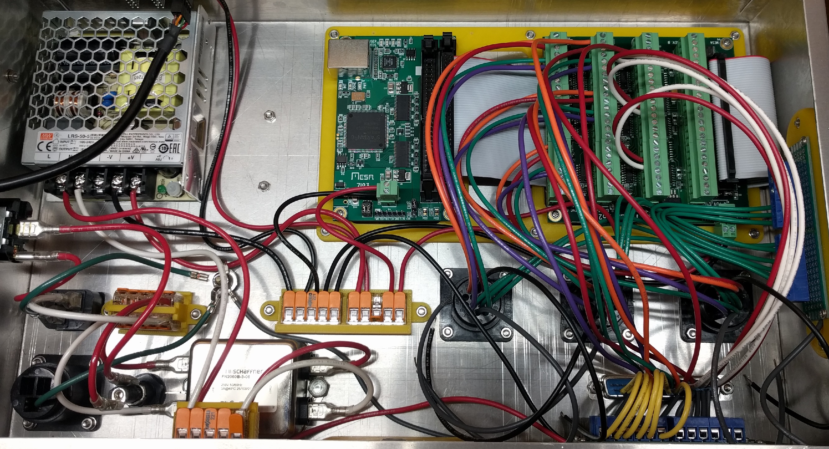

I'm retrofitting a 90s era SWI TRAK CNC2 that uses a 15.5Khz PWM signal (50% = 0 drive) for servo control. I want to hook up my oscilloscope to check that PWM signal is what I'm expecting before actually hooking it up to the machine and attempting to tune everything. I have my scope connected to pin 19 for channel 1 and pin 20 for channel 2 on connector P3 (7i52s) which should be connected to pwmgen.02 for Z. I increased the Ferror variables so I wouldn't get a follow error when jogging, then jogged the Z axis, and saw no signal on the scope. I know the scope works since I just tested it earlier today. So where did I go wrong?

29 Jul 2021 15:43 - 29 Jul 2021 16:49 #216233 by Zenduin
Replied by Zenduin on topic Testing funny PWM with 7i93 + 7i52s
1. Yes, but I MAY have done something wrong in compiling it...

2. PWMgen scale is 10, Offset-mode is enabled, PID MaxOutput is set to 2.5
halcmd show all hm2_7i93.pwm shows nothing, but:
