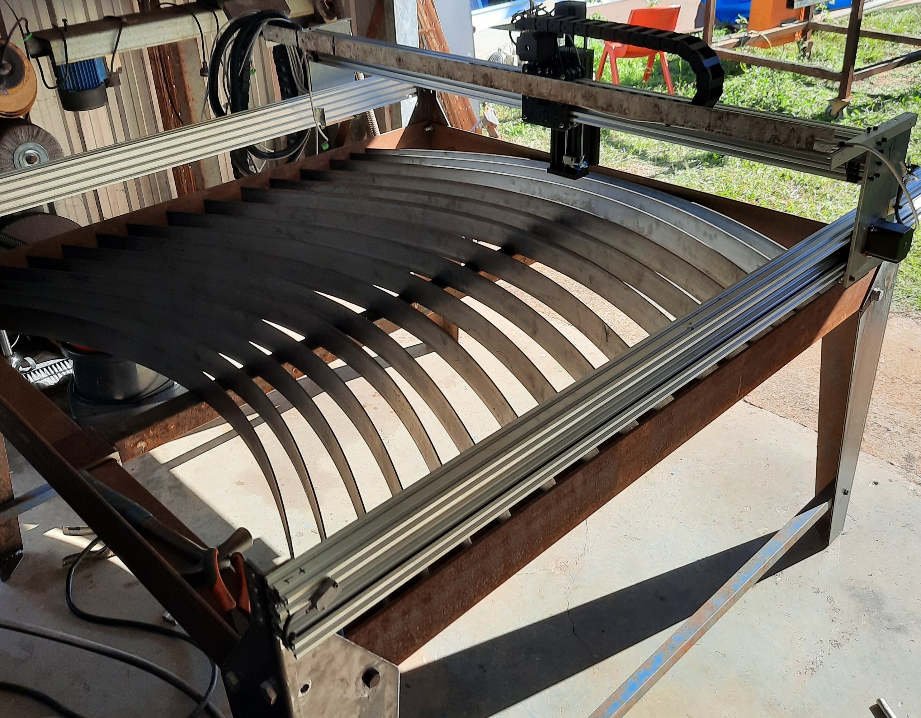

What a great site with so many people helping out, i''m in the process of building a diy plasma table i have a thermacut EX -TRAFIRE 45ds with machine torch it has a cnc port the machine's manual looks like a copy of hypertherms. now onto the board or boards i been researching mesa boards and am lost as to which on to go for, any recommendations on this and what motors most hobbyist are using please. i have 4 stepper motors but not sure if they are big enough
i got the table design from openbuilds site and would like to thank devloop for he's files.
now for my next big learning curve to get my head around how linux works i know ive rushed the build and need to finish it properly.

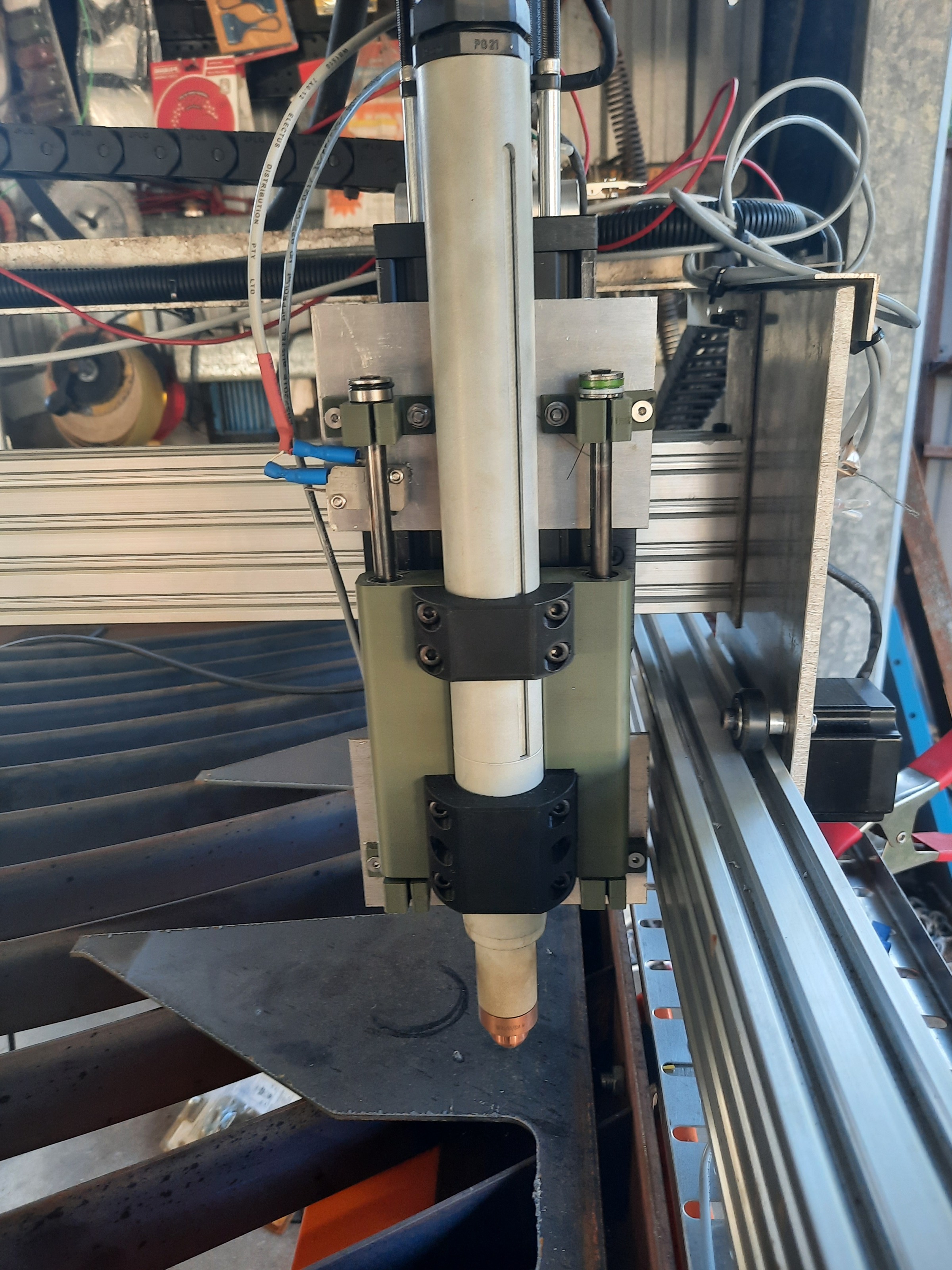

- wilkodean
- Posts: 5
27 Aug 2021 19:12 #218936
by wilkodean
Replied by wilkodean on topic newbie from Queensland Australia.
He's another pic
- Posts: 22026
- Thank you received: 7501
27 Aug 2021 23:48 #218948
Replied by tommylight on topic newbie from Queensland Australia.
I would like to say "very nice" as i usually do, but noooo !
Limit switches, all have to be relocated, as you have them they might just survive the first homing. I did say might!
Also the float switch is to far, so add a screw or a piece of metal to trigger it with the least amout of torch going up. Oh and it also has to be relocated.
Switches me be sideways and the parts triggering the switch must move past the switch, not through the switch.
Sorry to throw all this at you ...
- wilkodean
- Posts: 5
28 Aug 2021 09:37 #218977
by wilkodean
Thanks Tommylight I will get the right switches mate I have rushed it, I had some micromave switches form one I pulled apart no more rushing the job doing it properly from here out I am really grateful for your help and everyone on this site makes you feel like your finally found the right community
