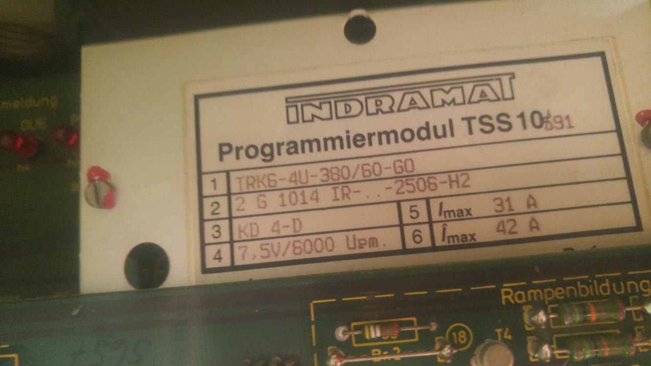

Quick question, can it be that I have a wrong "Programmiermodul" in my Indramat.
Its a MAHO MH500 W4 mill.
I noticed today when parameterizing the spindle for Linuxcnc...
Normally the spindle Indramat should be set to 9V/5000rpm or not?
As I said a maho w4 with 2 gears maximum speed 5000.
In my case is a module inside with 7.5V 6000rpm.
Has there been mounted something wrong?
The input voltage, I can parameterize suitably, so tis not a problem,
but whether the remaining values then still fit to the mounted spindle motor?
so Imax especially?
How can I check tis

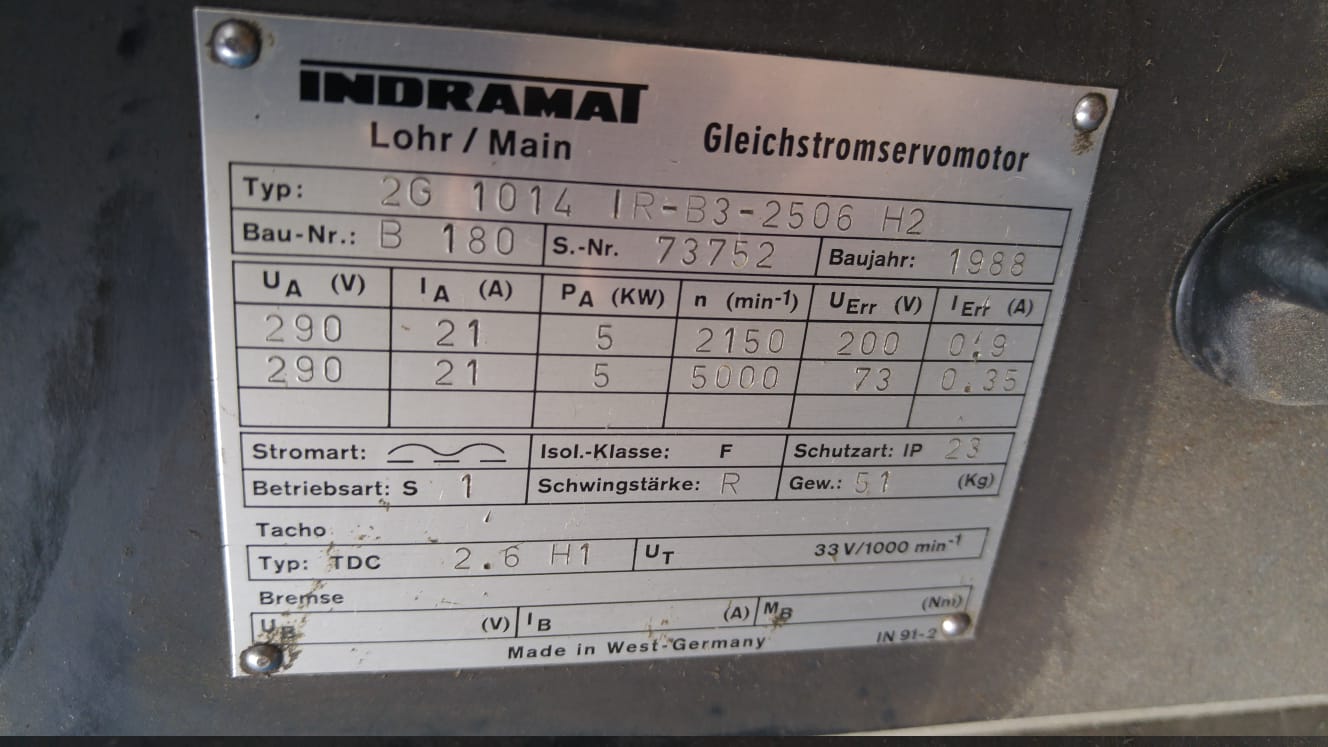

please post a picture of the type plate from the spindle motor.

07 Sep 2021 09:52 #219832
by DoWerna
Replied by DoWerna on topic "Programmiermodul" for TRK 6-4U
- db1981
- Posts: 790
- Thank you received: 276
07 Sep 2021 10:52 #219836
by db1981
Replied by db1981 on topic "Programmiermodul" for TRK 6-4U
looks ok, modul matches the motor type.
if you search the web, this modules are alle setup at 7.5V, so i think this is original.

07 Sep 2021 11:26 #219839
by DoWerna
OK great
if motor and driver fit together i am already satisfied!
if I understand the machine constants correctly, the machine was parameterized from the factory for 9V at 5000rpm with the philips 432.
the gearbox has a 1:1 ratio
but anyway, the important thing is that the Indramat fits to the engine, the rest I can then parameterize accordingly...
