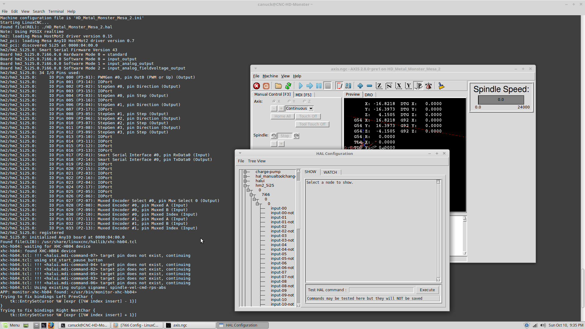

I have a 5i25 with a 7i85s and am trying to connect a 7i66 to the 7i85s.
My question is what do I put in my hal file for: sserial_port_0=_______
I tried a few different ones but am not seeing any new pins show up when I boot up linuxcnc.
I want to run the 7i66 in mode 0.
7i66 is externally powered and I used a cat5 cable for the connection between 7i85s and 7i66.
I get a orange light on the 7i66 when I hook up the cat5 only and w1 in the left position. 7i85 is externally powered by 5v
I get an additional red light when I hook up 12v to vin pin5 and gnd to pin8 on the 7i66 TB1 with w1 in the right position along with cat5 hooked up.
My hal file:

hm2_5i25.0: initialized AnyIO board at 0000:04:00.0My hal file:
loadrt [KINS]KINEMATICS
loadrt [EMCMOT]EMCMOT servo_period_nsec=[EMCMOT]SERVO_PERIOD num_joints=[KINS]JOINTS
loadrt hostmot2
loadrt hm2_pci config=" num_encoders=4 num_pwmgens=1 num_3pwmgens=0 num_stepgens=4 sserial_port_0=00000000 "

11 Oct 2021 03:16 - 11 Oct 2021 03:21 #222816
Replied by PCW on topic 7i66 Config
W1 on the 7I66 needs to be in the left hand position
and you need 8-32V field power for the 7I76 to be
detected.

11 Oct 2021 03:33 - 11 Oct 2021 03:36 #222817
by the_canuck
Replied by the_canuck on topic 7i66 Config
Solved.
Hooked up the serial connection on the wrong spot on the 7i85s. Pins are showing up now.
Andrew
