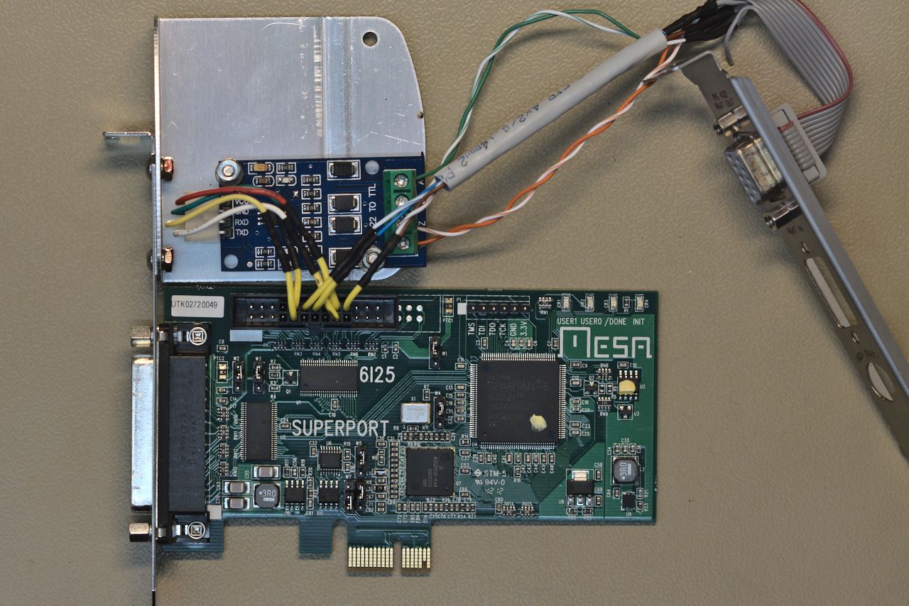

Is there some "easy" way to hook up a 7i73 Pendant/Control Panel interface to a PC? I.e. without having to use a parallel cable or any external cabinets.
I have a left over 6i25 card, can that be used, perhaps with a small bidirectional RS-422 converter card as the electrical interface?

4 years 5 months ago #243323
by arvidb
Replied by arvidb on topic Best/easiest way to hook up a 7i73 to a PC?
So I made this contraption:
Nothing exploded neither when I powered on the computer nor when I hooked up the 7i73 - so that's a big win!
Unfortunately the 7i73 is also not being detected.
I have flashed the 7i77_7i74 firmware to my 6i25:
On starting linuxcnc (with the 7i73 connected) I get this:
Obviously I would have liked to see a Smart Serial Interface on P2-05 and P2-09...
The 7i73 CR1/FAULT LED lights up as soon as the 7i73 is connected, and stays lit also when I start linuxcnc.
The only things I do with the 5i25 in my hal is:
I'm *guessing* that the P2/7i74 will be sserial port 1 in this config? Anyway it shouldn't affect detection.
Before I dig out the oscilloscope and start to debug this it would be great if someone could confirm (or not) that this should work at least in principle. PCW, if you see this?
Code:
loadrt hm2_pci config="sserial_port_1=33333333"
addf hm2_5i25.0.read servo-thread
addf hm2_5i25.0.write servo-thread
4 years 5 months ago #243324
Replied by tommylight on topic Best/easiest way to hook up a 7i73 to a PC?
Try setting the port to 00000000, not 33333333.

4 years 5 months ago #243330
by arvidb
Thank you tommy, I'd have gone crazy trying to find this!
Unfortunately the 7i73 is still not detected. And its CR1/FAULT LED stays on just like before.
*doh* I had my 7i77 configured to mode 3 for MPG use and confused it for an 7i73 setting. After removing the config= parameter for sserial_port_1 I now have sserial interfaces on the 6i25 IOs:Does 7i73 have "mode 3" ? I forgot.
I still have one in a suitcase.

Now I'm a bit confused. The HAL lines shown above are added to an already working EtherCAT config, in a separate file pulled in by an additional HALFILE statement in the .ini file. There is no 'start' statement anywhere, but both EtherCAT and the MPG input of my 6i25/7i77 combo has been working great anyway.
Adding 'start' makes no difference unfortunately. But start or no start, in HAL Meter I can see hm2_5i25.0.gpio.025.in (the RX line I've connected to the TTL/RS422 converter board) toggle from FALSE to TRUE when I disconnect the 7i73. So at least there is some life.
You are missing one crucial step...
Code:start
A bit of a sanity check: the 7i73 RX (CAT5 orange) should be connected to the 5i25 TX, and vice versa, right?
- Posts: 17533
- Thank you received: 5334
4 years 5 months ago #243372
Replied by PCW on topic Best/easiest way to hook up a 7i73 to a PC?
Yes, though you may have to swap the polarity (TX+/- and RX+/-)
The following user(s) said Thank You: arvidb
