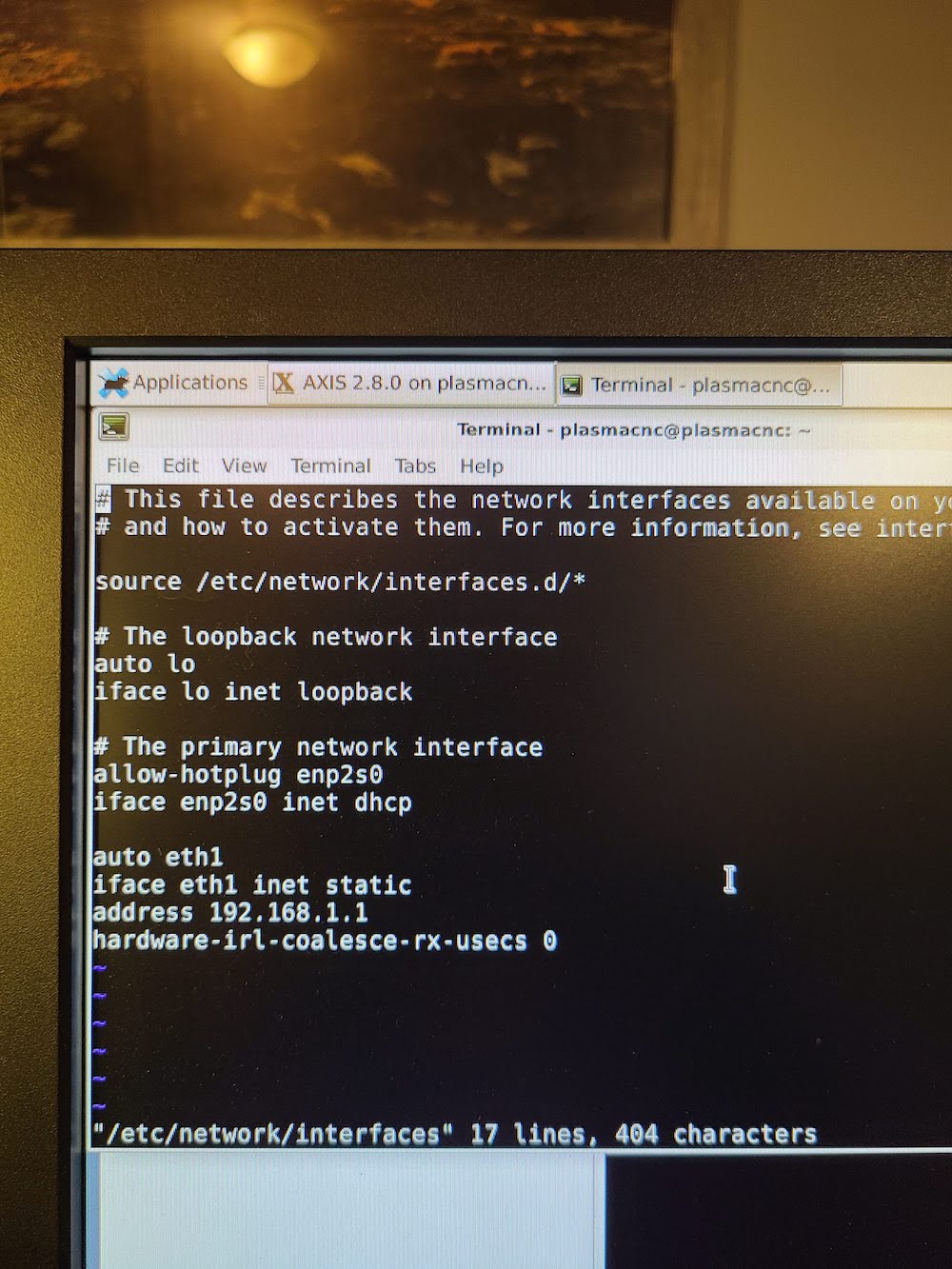

Hello!

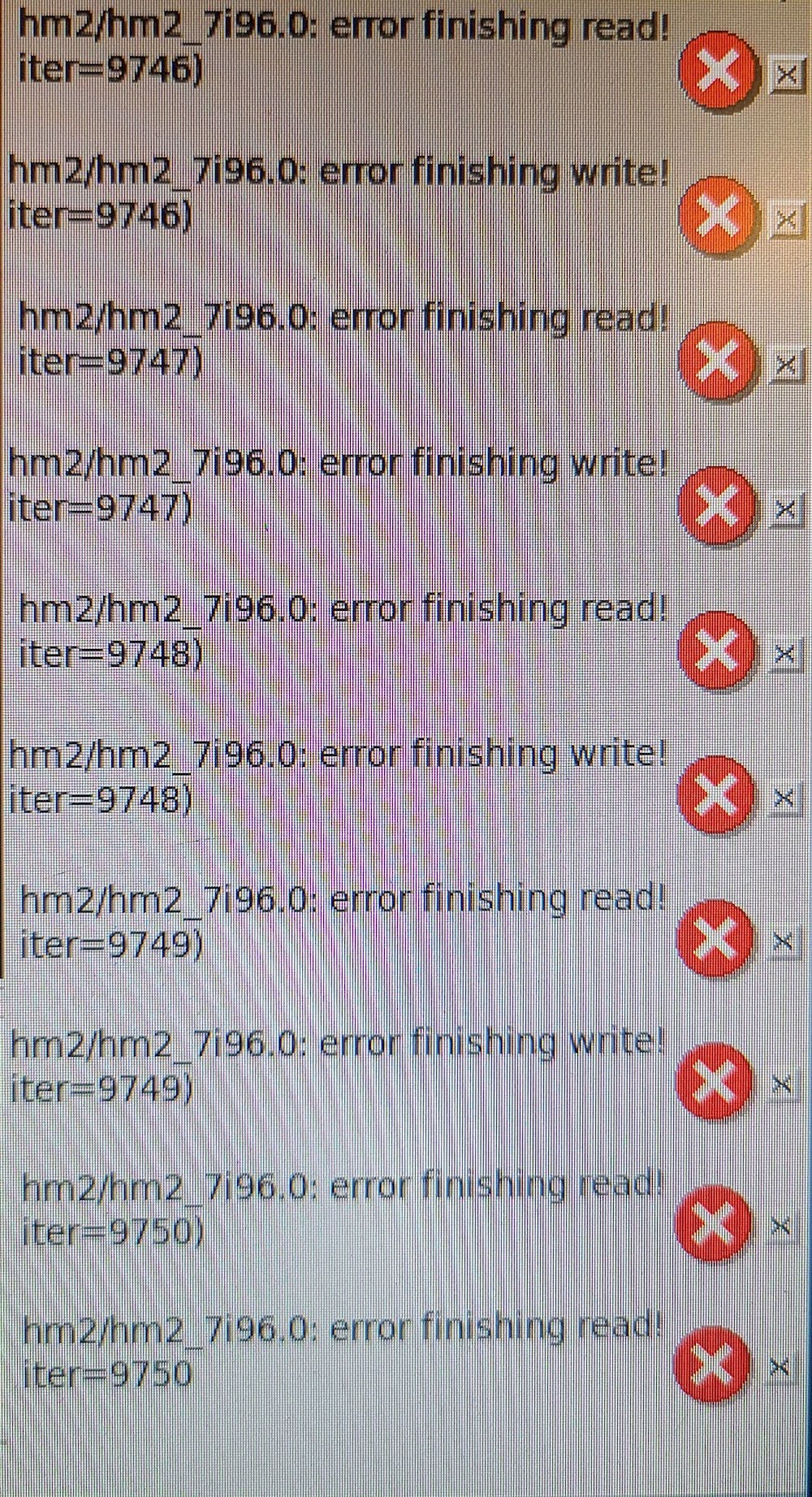

I've had a plasma cutter set up and running for over a year now. It recently started throwing the finishing read/write errors. I did just do a bit of a rebuild of motor/sensor wiring, but everything was external to the control box. I'm able to replicate the read/write errors with none of the motors plugged in, so I'm assuming this is unrelated to my recent change, and just an unfortunate coincidence.
I've searched around and seen several instances of these errors showing up, but I can't seem to find a solution. From my understanding the other instances were when a new computer was being used. Nothing on my setup has changed in terms of the computer and control board, so not sure why it started throwing the errors. I've attached a screenshot of the errors for reference.
Another difference with my case seems to be that the errors don't always come up right away. It'll throw the errors anywhere from immediately upon opening linuxcnc to sometimes several minutes into a job.

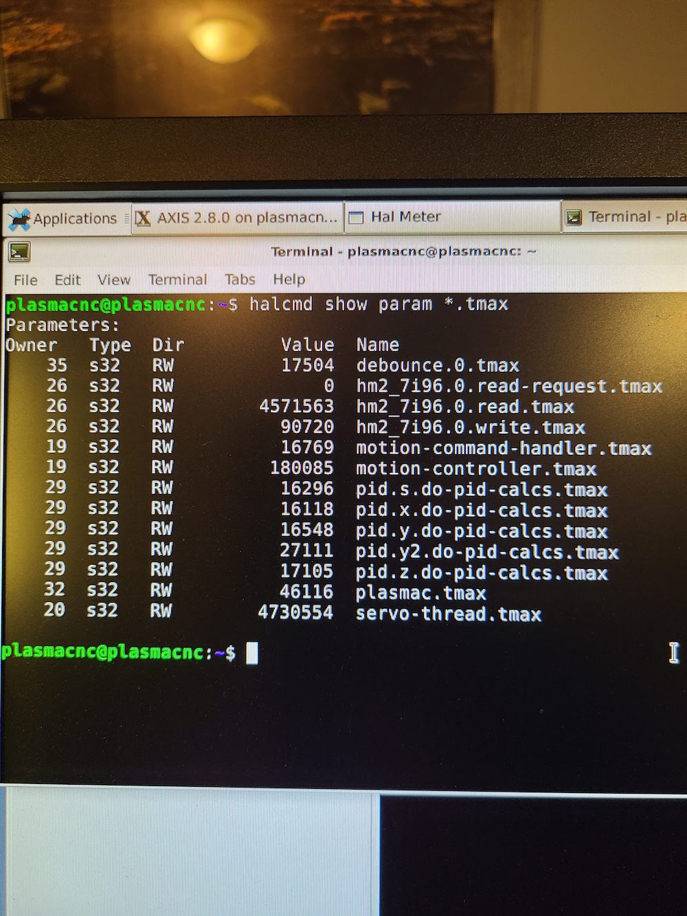

I've attached a screenshot of the output for `halcmd show param *.tmax` which shows 4,571,563 for hm2_7i96.0.read.tmax.
Here's what I've tried so far, with no luck:

06 May 2022 22:30 #242199 by phillc54
Replied by phillc54 on topic Another 7i96 Error finishing read
There may be a typo, the text shows "hardware-irq-coalesce-rx-usecs 0" but the image frome the terminal shows "hardware-irl-coalesce-rx-usecs 0"

06 May 2022 22:34 #242200 by chadfawcett
Replied by chadfawcett on topic Another 7i96 Error finishing read
Good catch! That was my second time making that change, just so that I could get an image of the error. I went in and corrected the typo, but still get the same error on startup.
07 May 2022 10:06 - 07 May 2022 10:23 #242238 by PCW
Replied by PCW on topic Another 7i96 Error finishing read
Looks like your Ethernet name is enp2s0, not eth1
Also, you can verify if the coalesce settings took (or are even applicable)
with:
ethtool -c enp2s0
(from the command line)

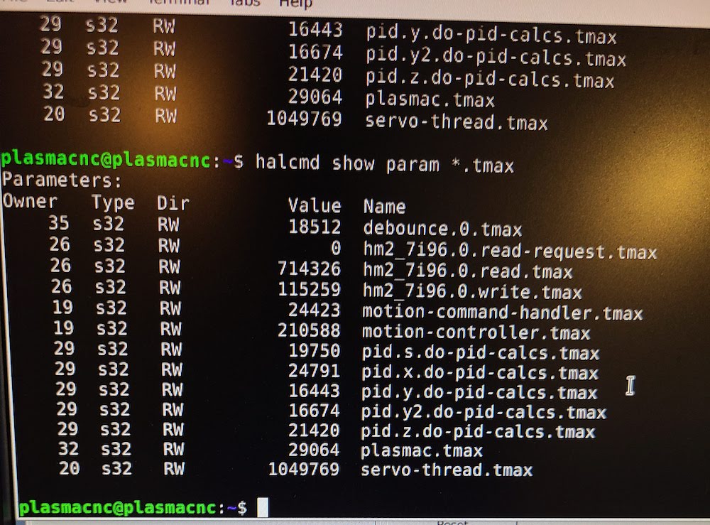

07 May 2022 16:02 #242256 by chadfawcett
with:
ethtool -c enp2s0
 Changing eth1 to enp2s0 seemed to have an affect. My `/etc/network/interfaces` now looks as follows:

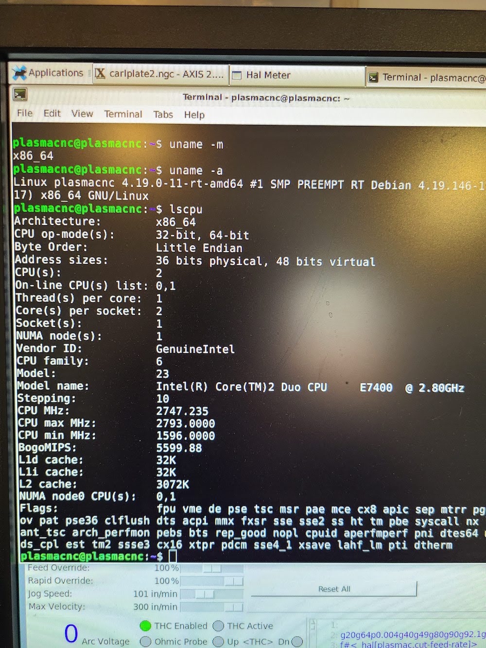

I tried running `ethtool -c enp2s0` but apparently `ethtool` isn't installed on my machine.
I'm unable to replicate the issue after making this change, hurray! If I change my network config back to what it was before (pre disabling irq coalesce), I can replicate the issue within a few minutes. So it appears this has resolved the issue.
Since this is an intermittent issue, and because the shop this is normally setup in is an hour away from home, I'd like to do some further digging if possible before sending it back to the shop. Especially considered this error just started happening after a year or more of it running fine.
After linux cnc has run for a few minutes, the read.tmax is `714326`. Is this high? I ran a few commands to get the specs for the machine, and it's an Intel Core 2 Duo @ 2.80 GHz.
I've attached a couple more screenshots. Any further help to debug/double check that this has been resolved would be greatly appreciated!
Chad
07 May 2022 16:21 #242262 by PCW
714326 (about 250 usec ) is a lot better than the
4571563 ( about 1600 usec) that is was previously...
