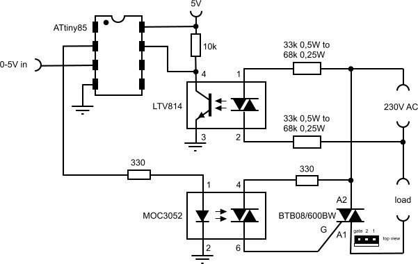

This is more of an "I was wondering" thought....
I've got a SuperPID for my router controller, and its ~OK.... but I was wondering if anyone has built or knows of a circuit to directly control a router.
No it cannot be VFD controlled.
It would need to be controlled via a TRIAC, the SuperPID uses a BTA26-800CWRG (Triac, 800 V, 25 A, TOP-3, 35 mA, 1.3 V)
4donline.ihs.com/images/VipMasterIC/IC/S...58556ACFDE234799DDF0
Whilst I like the LCD, knobs and switches of the Super PID, I was wondering if anyone has built or knows of a circuit that would integrate with LinuxCNC via maybe a Mesa card?
The SuperPID uses an optical sensor for speed sensing...... it's been ok, but reciently it was not happy and was getting erratic readings.
My router actually has a magnetic disc on the end of the spindle and the original speed controller used {what I suspected and now confirmed} a hall effect sensor to provide speed control and feedback.
I am presently feeding the superPID index signal back to linuxcnc via an encoder index signal
I was just thinking ..... there must be a better / simpler way with linuxcnc of providing closed loop speed control via a simiple interface.
Open to suggestions (I'm about to get some boards made and shipped so I though I'd get one designed and have a go at getting it to work closed loop in linuxcnc)

Hmm..... this may provide a simple circuit for speed control of the router:
forum.arduino.cc/t/voltage-controlled-di...an-attiny85/303732/9
swapping out the triac for a BTS26-800CWRG
separate circuit for spindle index feedback.

As there is a microcontroller in there, I would suggest not using analog voltage for the speed control, instead use a step-dir interface. (or something else digital). I am thinking on terms of a position-mode step interface, where the microcontroller increases or decreases an internal speed variable in response to pulse inputs.

If using a Mesa card, this also could be done with a FPGA oneshot with a trigger in
and end of timeout pulse output. I'll take a look at adding this.

How is that ^^^^ going to work?
nearly finished my PCB design (added an index / encoder input with a divider as my router seems to have a 4 pole magnetic ring on the end of the spindle measurable with a hall effect sensor

"How is that ^^^^ going to work?"
Two FPGA pins, one for zero crossing detect input
(connects to the LTV814), the other for the Triac drive pulse
Oneshot with variable time set in hal sets the delay
between zero crossing and pulse output = direct phase control

ahhh. {light bulb!}
I can get rid of the attiny!
that would be much better to be able to control the triac directly from within linuxcnc. also better given it would be able to switch 50hz or 60hz too.
thanks very much that would be a lot better.
