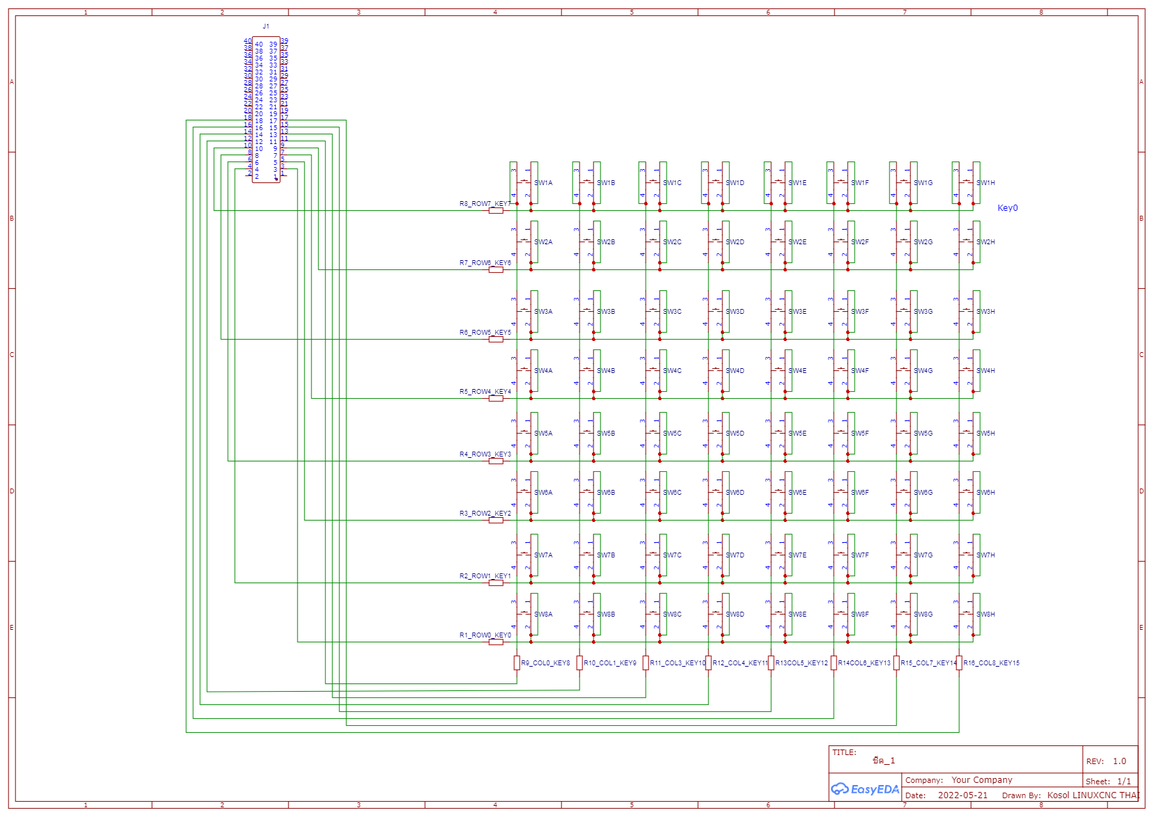

Need help config wiring daigram Matrix_kb8x8 on7i73 with 7i92 7i77. I set it according to the attached file but it still not working.
- status of the CR2 on 7i73 flashing green.
- hm2_7i92.0.7i73.0.2.swrevision = 14.
- matrix_kb.0.keycode Value= 0x00000040. (There is no change when the button is pressed.)
R1-R16 I use it as a jumper or it must be used
How do I fix it? please help
Thank you.

1. Looks like the rows and columns are not correct in your drawing.
correct wiring is:
( KEY0..KEY7 are rows = P1 3..10 )
( KEY8..KEY15 are columns = P1 11..18 )
2. Its expected that you will wire the scan code to the matrix component
(key scan codes only last 1 servo period and then revert to the no-change
code ( 0x40 ) so are hard to see with halshow etc)
correct wiring is:

As for R1-R16 is it necessary?
Replied by SOLD on topic Matrix_kb 7i73 need help
thanks for the help1. Looks like the rows and columns are not correct in your drawing.
correct wiring is:
i will fix it
Last edit: 20 Jun 2022 02:53 by SOLD.
- Posts: 18115
- Thank you received: 5334
20 Jun 2022 03:51 #245468
Replied by PCW on topic Matrix_kb 7i73 need help
No resistors are needed

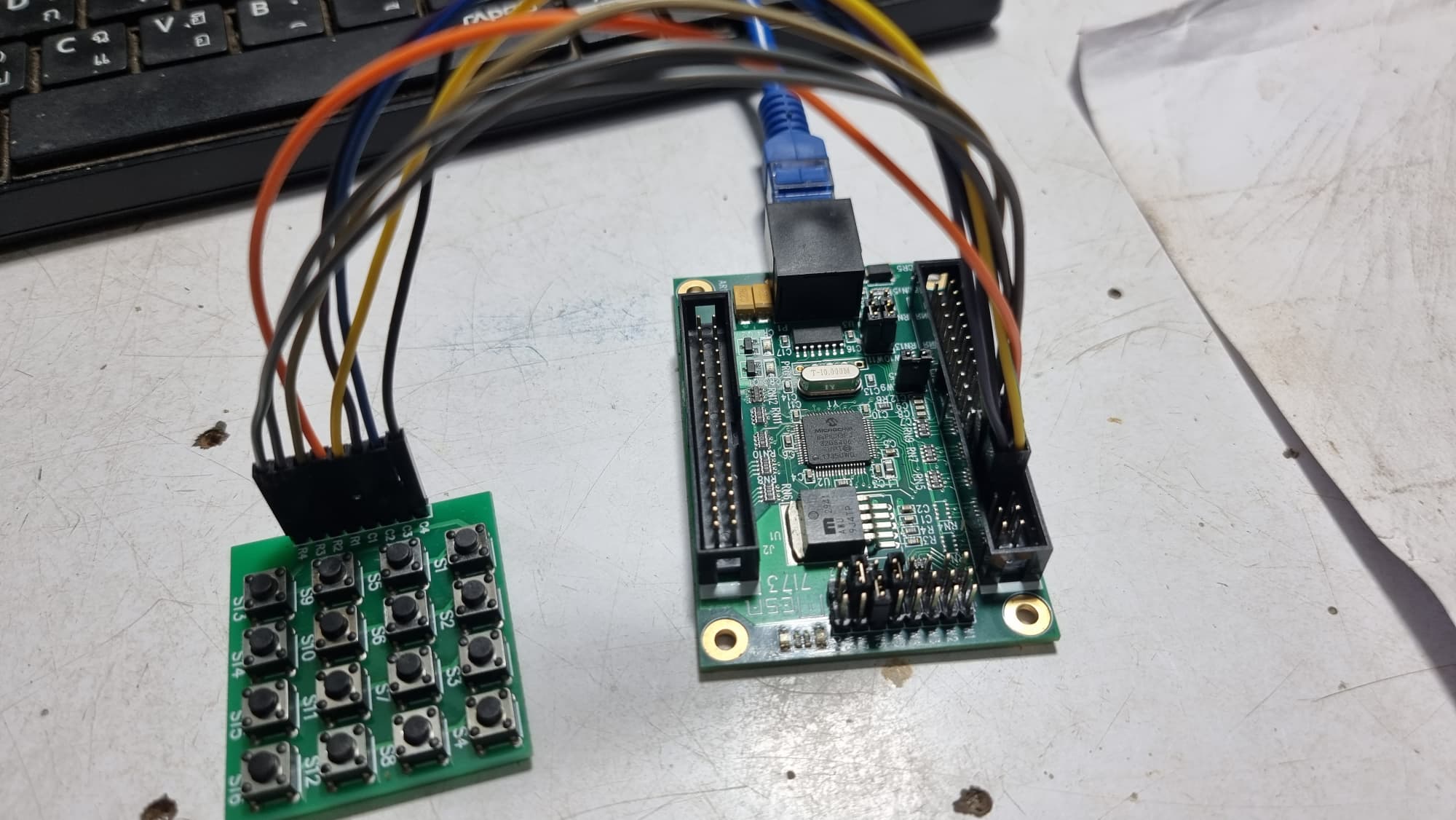

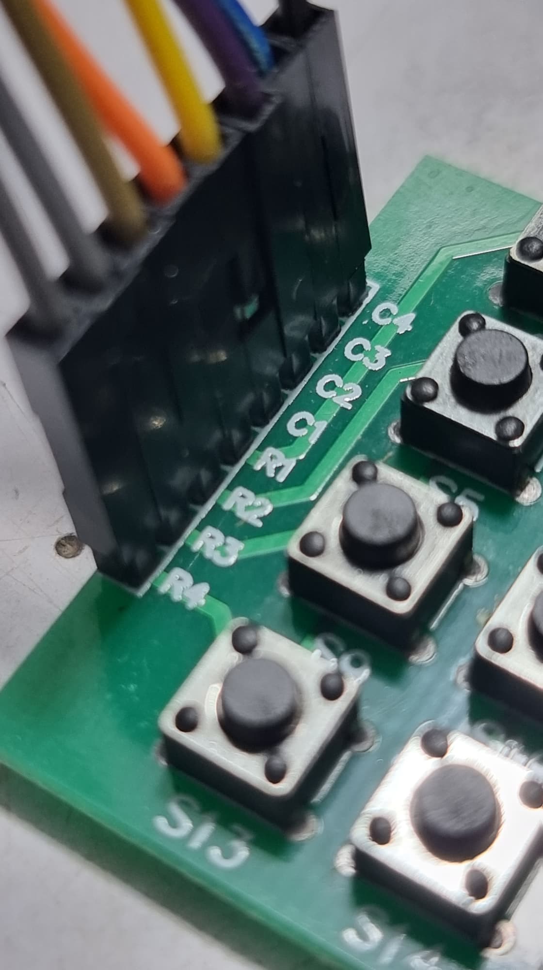

I have tried the fixes you suggested. But it still doesn't work.
I followed this forum.linuxcnc.org/47-hal-examples/32725...ic-pendant-with-7i73
As in the picture, it still doesn't work.
I wonder if the wiring is faulty causing the 7i73 to be damaged? How do I check for damage?
And how can I check the function of the key?
Last edit: 20 Jun 2022 12:02 by SOLD.
- Posts: 18115
20 Jun 2022 13:48 #245482
You could jumper the 7I73 for no KB and check the individual inputs and outputs
(all KEY pins become available as inputs (Key8..Key15) or outputs (Key0..Key7)

I checked I/O,P11,P12,P13,P14 to GND it's working. But P15 It works itself sometimes. P16 P17 P18 to GND it's not work. P3-P12 not tested
I want to know the settings sserial_prot_0=001xxx correct for
1.
Board hm2_7i92.0.7i73.0.2 Hardware Mode 2 = keyboard4by8nodisplay
Board hm2_7i92.0.7i73.0.2 Software Mode 0 = inputoutputencoderkeycode4by8
Board hm2_7i92.0.7i73.0.2 Software Mode 1 = inputoutputencoderanalogkeycode4by8
Board hm2_7i92.0.7i73.0.2 Software Mode 2 = inputoutputencoderanalogkeycode4by8
and
2.
Board hm2_7i92.0.7i73.0.2 Hardware Mode 4 = keyboard8by8nodisplay
Board hm2_7i92.0.7i73.0.2 Software Mode 0 = inputoutputencoderkeycode8by8
Board hm2_7i92.0.7i73.0.2 Software Mode 1 = inputoutputencoderanalogkeycode8by8
Board hm2_7i92.0.7i73.0.2 Software Mode 2 = inputoutputencoderanalogkeycode8by8
I am waiting 7i73 In Stock.?
We should have new 7I73s in a week or so
Did you check the output pins?
The keypad input pins (Key8..Key15) should all read about 3.3V
when unconnected since they all have pull-up resistors to 3.3V
