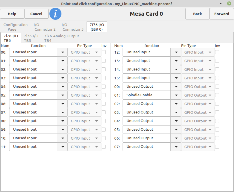

I am hooking up a 7i76 card to my machine, and everything is working so far. My machine is a CNC router that uses a hand held router as its spindle. To control the spindle (Turn it on and off) it uses a GPIO controlled relay. My problem is that I can not get the spindle on controls to operate the GPIO pins on the 7i76. I am a total novice to this so any help would be appreciated. Thanks

- 42walrustitan
- Posts: 18
16 Jul 2022 17:15 #247484
by 42walrustitan
Replied by 42walrustitan on topic 7I76 output issue
My only spindle control is going to be on off because the spindle is a hand held router controlled through a relay. As far as I know I have set up the spindle in pncconf. Is there something special I need to do to set it up.

- 42walrustitan
- Posts: 18
16 Jul 2022 20:30 #247501
by 42walrustitan
That is what I did. Is there something else that I need to do?
- Posts: 18111
- Thank you received: 5330
16 Jul 2022 21:29 #247506
Replied by PCW on topic 7I76 output issue
If you did, you should get a statement like
net spindle-enable => [HMOT](CARD0).7i76.0.0.output-01
in your hal file
If thats is there the 7I76 output01 will turn on when the spindle is enabled
in your hal file
