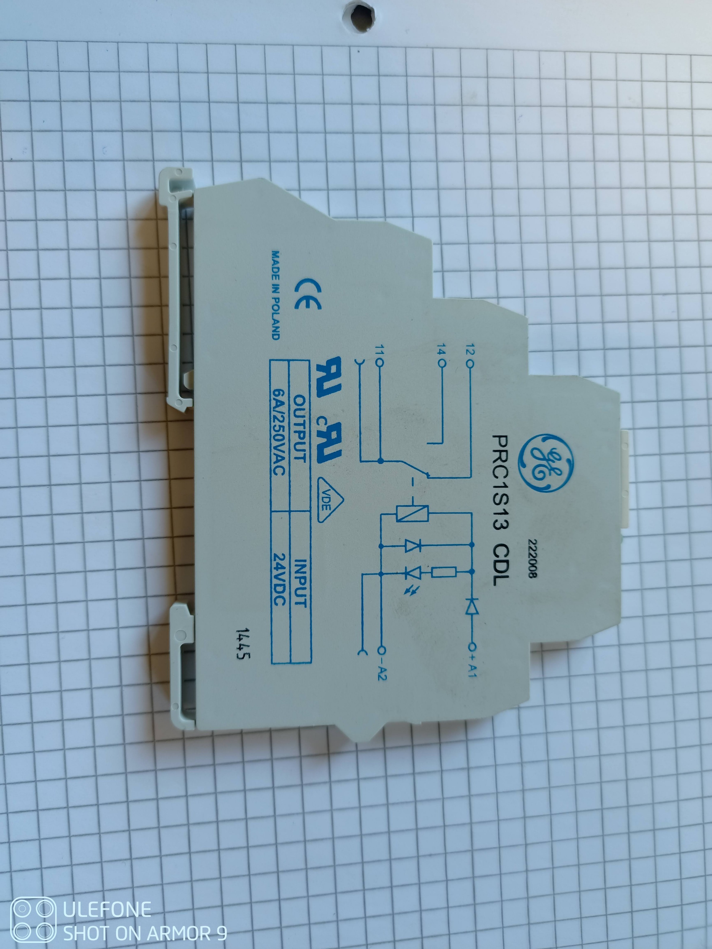

I'm trying to do another retrofit and the easiest way for me would be to energize this relay from ENA output
+24v - ENA0+
ENA0- - relay A1
relay A2 - 0V
is this safe to do?
+24v - ENA0+
ENA0- - relay A1
relay A2 - 0V
is this safe to do?

Yes, as long as the relay draws 50 mA or less.
