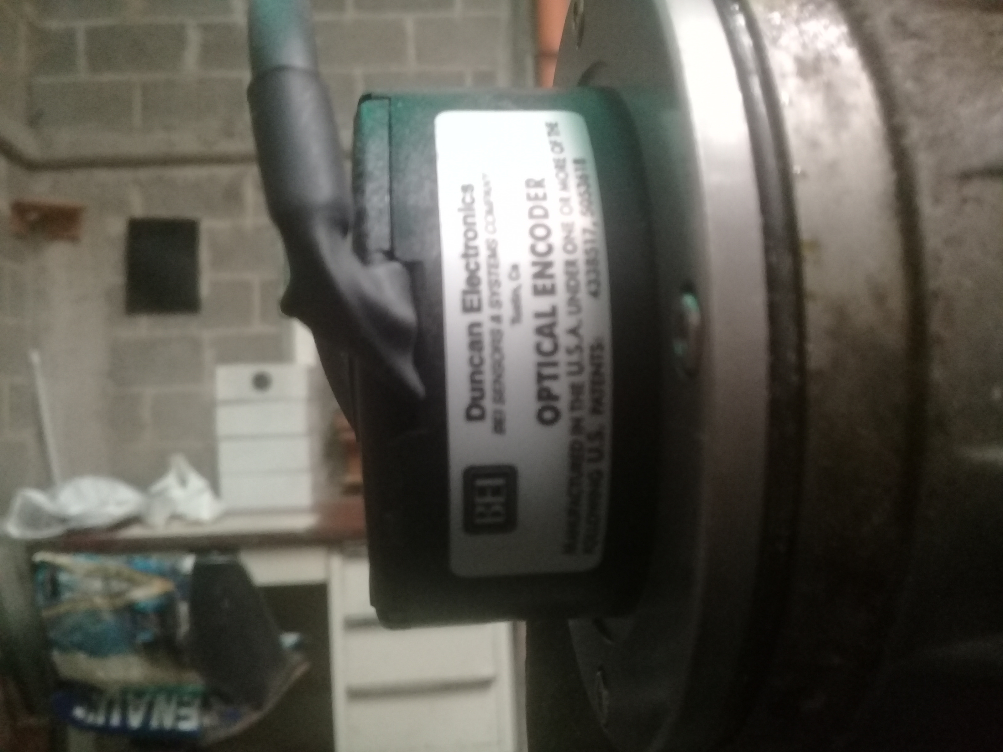

Hello, newbie here, I need to know what is the correct bit file for a 7i93 and 7i33TA card. I think it has 7i93_svst4_4d.bit file. I am doing a retrofit for a Hurco km3p milling machine the machine has 3 brushed dc servo motors and the drivers are electrocraft max-400. I have another question about the encoders, they are incremental encoders 5 volt model BEI MX21-592 I don't have the datasheet don't know the pinout. Please could someone help me find information about the encoders I don't want to fry the mesa card
