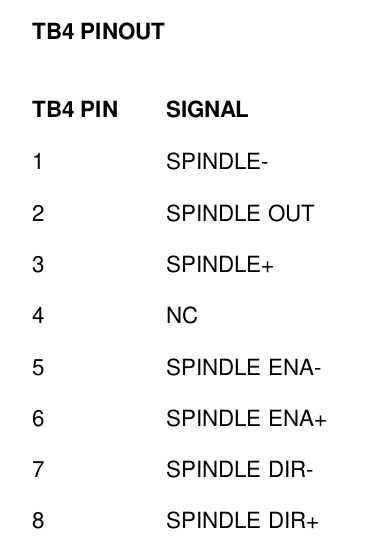

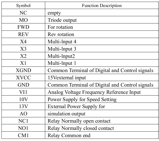

I am trying to figure out the wiring for the YL620 + Mesa 7i76. The VFD has the following pins:
Unfortunately the VFD handbook has no more details on each pin.
The Mesa TB4 pins:
I am *guessing* the following connections from the Mesa card connector TB4 should be made:
Can anyone confirm this wiring?
The Mesa TB4 pins:
- Pin 1 Spindle- to GND
- Pin 2 Spindle out to VI1
- Pin 3 Spindle+ to 10V
- Pin 5 Spindle Ena- and Pin 7 Spindle Dir- to XGND
- Pin 6 Spindle Ena+ to REV
- Pin 8 Spindle Dir+ to FWD
Last edit: 04 Dec 2022 10:45 by knipknap. Reason: Corrected wiring

Replied by PCW on topic YL620 VFD wiring to Mesa 7i76e
Do you have a link to the manual?
Ideally you can set the drive so it has a a drive on input and drive direction input
Yes, it looks like P00.16 must be 1
I think you have DIR/ENA swapped on your connections
As far as I can guess, when P00.16 =1, FWD = ENA and REV=DIR
You might verify operation with mechanical switches first.
Last edit: 04 Dec 2022 16:37 by PCW.

04 Dec 2022 16:41 #258516
by knipknap
Replied by knipknap on topic YL620 VFD wiring to Mesa 7i76e
True, Thanks for the correction!
