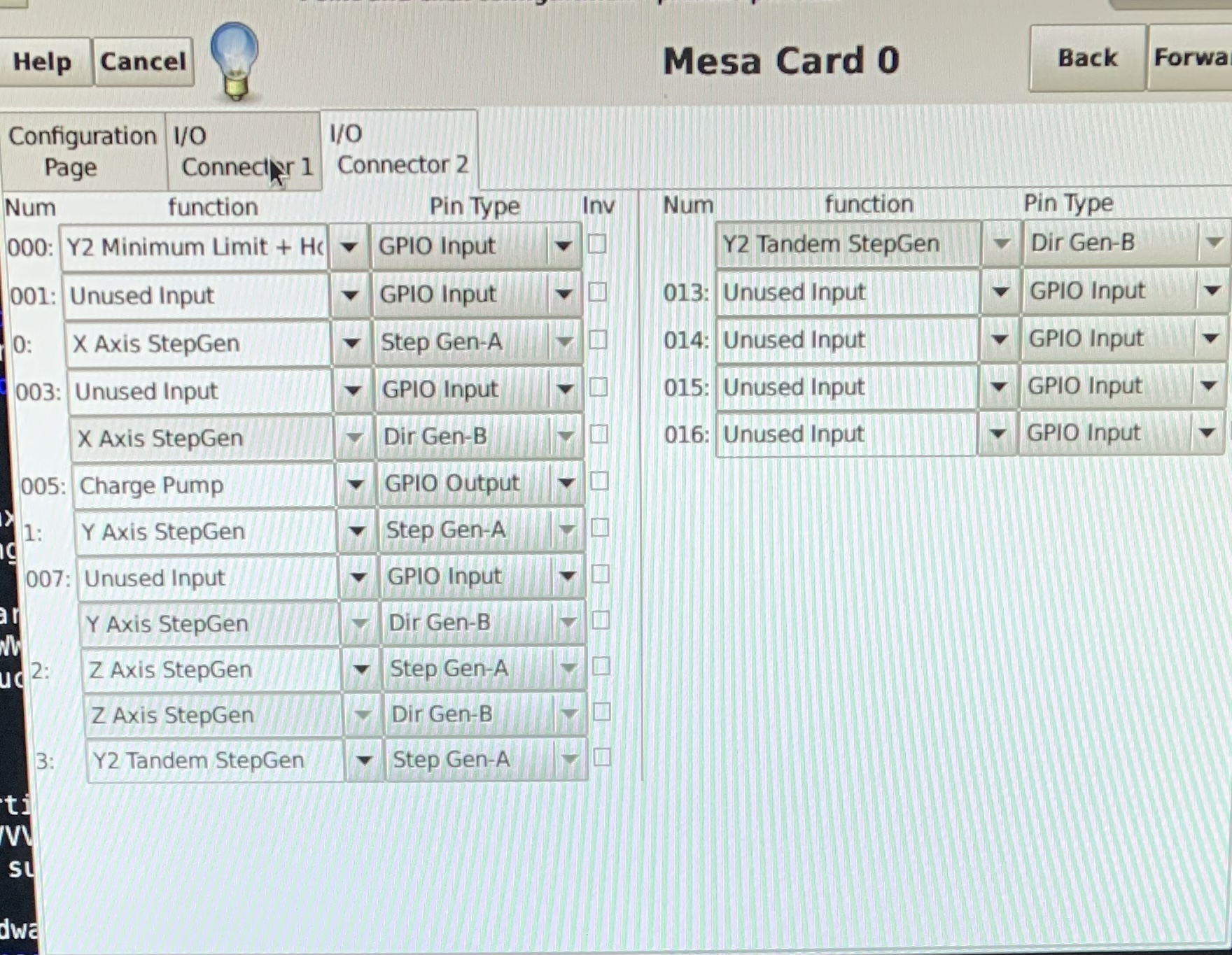

30 Dec 2022 03:03 #260531
by trainwreck
Replied by trainwreck on topic Looking for 7i92 firmware to use Gecko G540 and 7i75
Sorry to bother again, and please let me know if this has gone outside the scope of this board.
It appears that there's some kind of disconnect between the pncconf wizard and the firmware you gave me. I was able to get my motors to jog successfully using it and get my Y2 limit to trigger, but the limit input is not on the same connector as the motors. As shown in the picture attached, to get it to work I had to configure it on the same connector in pncconf, so I'm quite confused.
Do I need to change something to make pncconf understand the new firmware, or is it just not possible to get it working and I'll just need to do all of the configuration manually in the Hal and in files?
- Posts: 18100
- Thank you received: 5326
30 Dec 2022 03:37 - 30 Dec 2022 03:40 #260535
Replied by PCW on topic Looking for 7i92 firmware to use Gecko G540 and 7i75
Yes, you will likely have to re-assign any GPIO by editing the hal file
(while looking at the pinout printed by mesaflash)
If you use pncconf to setup all the limits etc for a standard configuration,
you can fix the GPIO numbers in the hal file by adding 17
GPIO starts at 17 on P1, so if a standard config uses GPIO 11 on P2
for X limit, that same DB25 pin will be 28 (11+17) on P1.
