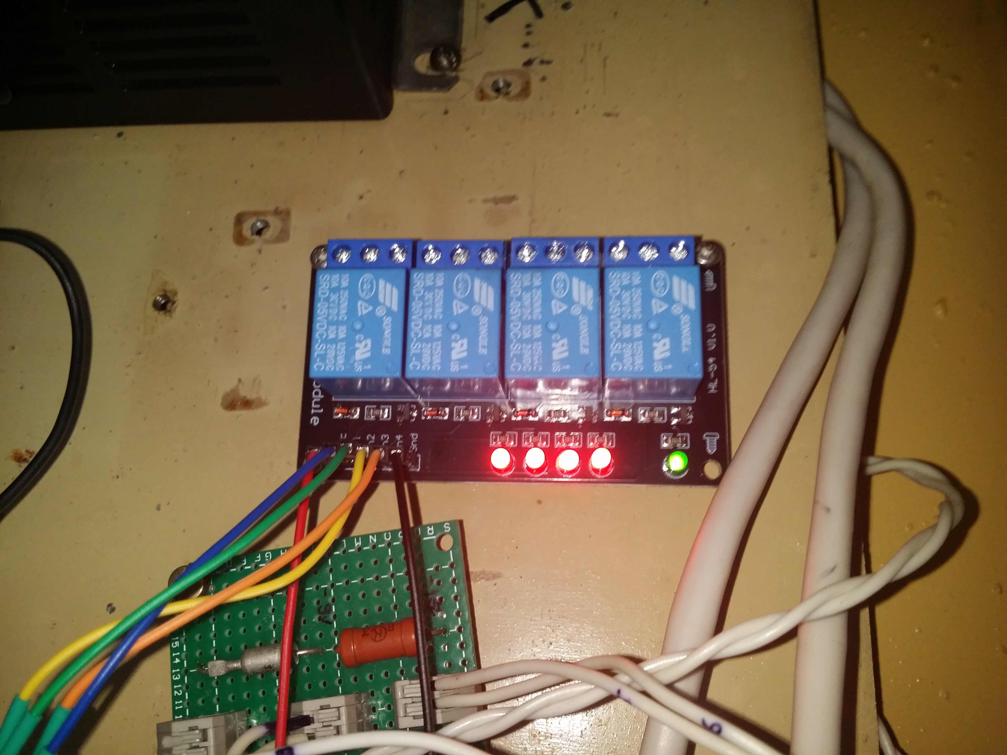

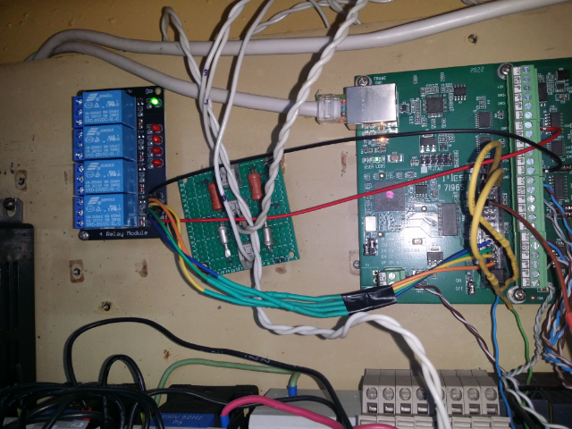

Hello.
I bought a 5v relay module.
The current draw on it's input is ~5mA. (negative HIGH - turns on the relay)
I 'd like to operate them with the P1 port.
How can I do it correctly?
Because now i have no positive result.
The firmware with axes indexes on P1 (1-5 pin) LCNC 2.9.4. The wires has 47 Om resistors in series.

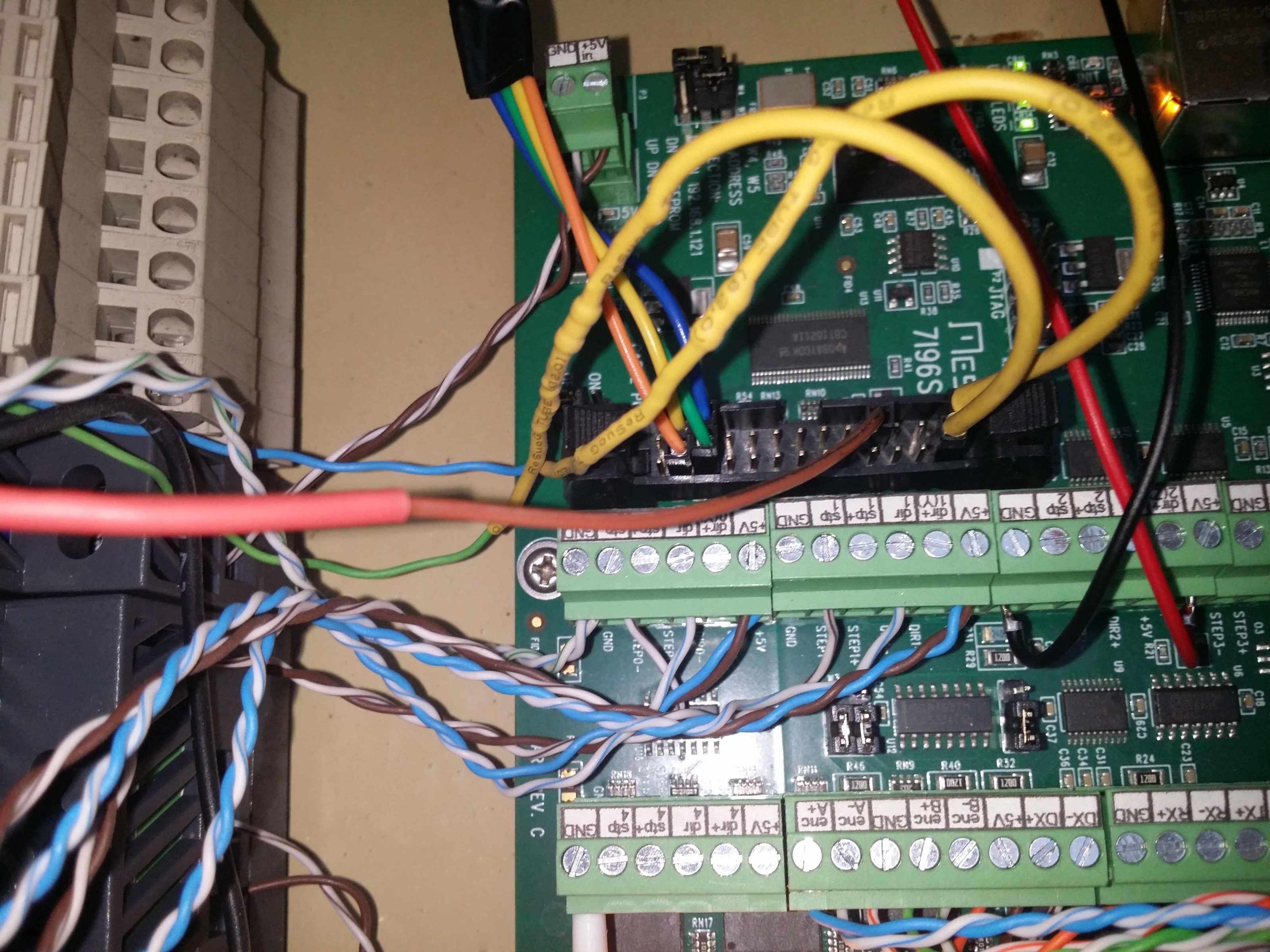

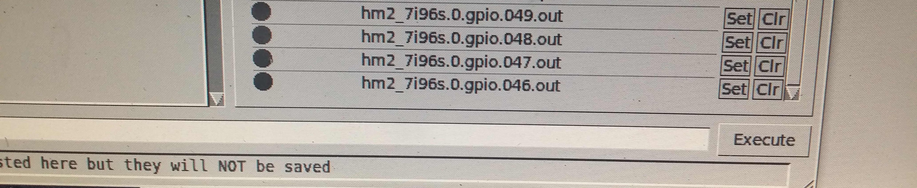

Found a mistake.
Now connected correctly 19 21 23 25 pin (47 48 49 50).
When the LCNC not running, all LEDs are OFF on the relay module.
When the LCNC is running, all LEDs are ON on the relay module. (relays turns on)
Changing bit not turns off the relay and LEDs.
Can it be solved somehow?

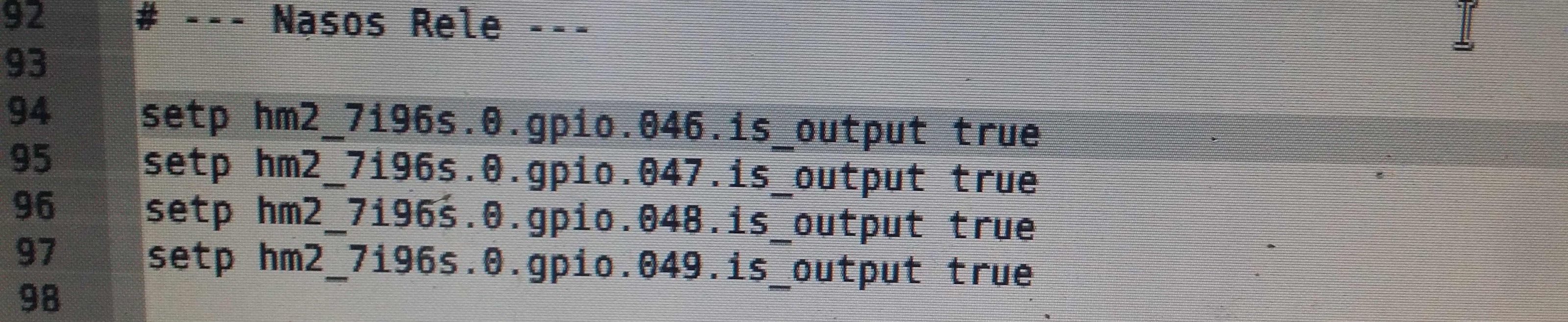

Finally figured it out
I had to make true "is_opendrain" and "invert_output".
Alltogether:
setp [HMOT](CARD0).gpio.050.is_output true
setp [HMOT](CARD0).gpio.050.is_opendrain true
setp [HMOT](CARD0).gpio.050.invert_output true
Alltogether:
