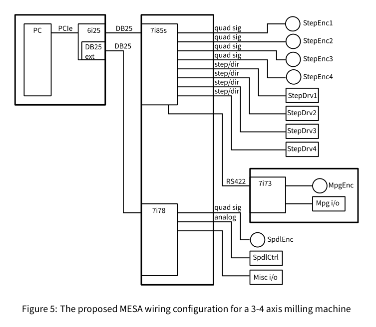

I am new to this, but anyway went ahead and bought a bunch of Mesa card to have something to play with.
I have wired them like this (picture below):
There is a firmware in the firmware .zip folder that looks similar to what I will be doing
" 5i25_7i85s_7i78.bit "
Are 5i25 and 6i25 firmware compatible ? I can't find 6i25 specific firmwares...
Should it be modified to get the 7i73 to work ?
Thanks in advance for your support

Replied by PCW on topic Mesa firmware help needed 6i25_7i85s_7i78_7i73
Yes, 5i25 firmware will work on a 6I25

And will the " 5i25_7i85s_7i78.bit " firmware support the 7i73 plugged in to the 7i85s ?
Yes, any sserial card can be connected to either the 7I85S or 7I78
