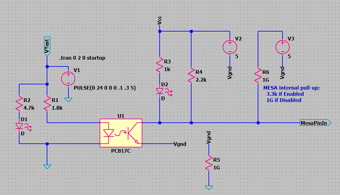

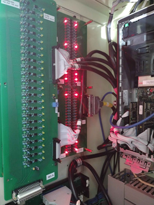

I am in the midst of connecting the original IO from my Howa VMC to a pair of Mesa 6i24-25 PCIe boards. Board 0, for input only, is flashed with 5i24_25_justio.bit firmware. 48 IO points are being used (Ports P1 and P3). Machine inputs are connected through my own optoisolation board. Schematic of one IO point attached. 24vdc on the machine side and 5VDC on the card side. The 5vdc for the card side of my board comes from respective ports/pins on the 6i24. Mesa pullups ae disabled as they are included on my opto board (schematic attached). Input works fine from machine controls, through test LED's on my card, and on the test screen in Axis.

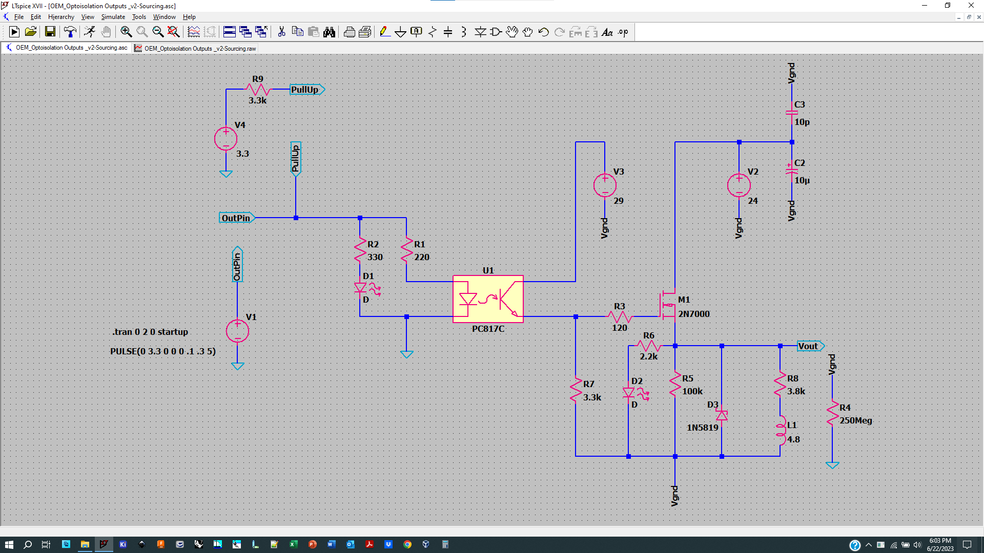

Where I am stuck is on the outputs from the second Mesa 6i24. Board 1 is also flashed with 5i24_25_justio.bit. 48 IO points are being used (Ports P1 and P3). Machine output are also connected to the 6i24 through a custom optoisolation board. In this case . I have the Mesa card configured for 3.3 volts, thinking their IO pins would drive the opto input side of my board by sourcing 15-18 milliamps for the opto input + test led. A schematic for one pin is attached. I may have messed up thinking the 6i24 could source the current.

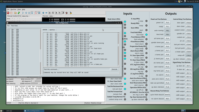

The Axis test screen and Hal Config show the test buttons signaling the hm2 gpio correctly, but nothing happens at the opto board. When I tested the board, 3.3vdc at each 'input' side of the optos allows 24 vdc through to the corresponding outputs (relays, panel lights, etc).

Are the "is_output" parameters set true for all the output bits?

Yes, you would just have a bunch of:
setp hm2_5i24.N.gpio.mmm.is_output true
statements in the hal file
Mesaflash currently can only access 1 PCI card.
