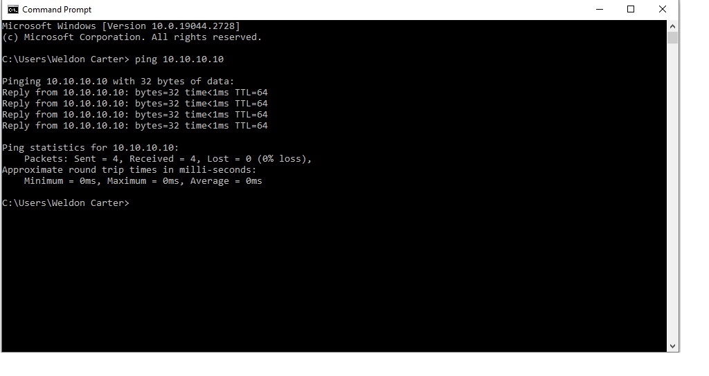

04 Sep 2023 20:15 #279879
by CarterKraft
Replied by CarterKraft on topic Mesa 7i96s 5v supply reverse polarity damage
Ok, not sure what happened but after connecting to the windows PC and pinging I can now ping it on the linux PC, left two user lights are solid green.
--- 10.10.10.10 ping statistics ---
145 packets transmitted, 145 received, 0% packet loss, time 146489ms
rtt min/avg/max/mdev = 0.148/0.368/0.618/0.133 ms
