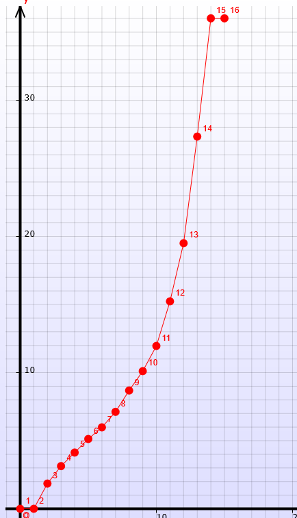

I am now having an issue with the voltage not being linear even though I am using 50k linear pots. I assume this is because of my lack of electronics knowledge and some basic thing that I don't know. See the attached graph. I am using a 36v supply with the positive connected to the first pin of the pot, negative to the third pin and the input on the 7i84 connected to the wiper. I understand the dead zone on either end of the graph but I don't understand why it isn't pretty close to a straight line. I divided the ~300 degree rotation into 16 points. Here are the actual values:
1 - 0
2 - 0
3 - 1.850588
4 - 3.131765
5 - 4.128235
6 - 5.124706
7 - 5.978823
8 - 7.117647
9 - 8.683529
10 - 10.10706
11 - 11.95765
12 - 15.23176
13 - 19.50235
14 - 27.33176
15 - 36.01529
16 - 36.01529
Everything seems good enough until around points 10 or 11. Then the voltage shoots up significantly. Center on these pots reads about 7.9v.
I would appreciate guidance from anyone who knows what's going on here.

Pot has 3 pins, middle pin to mesa input, one side pin to GND the other side pin to +24V or 12V or whatever you are using.
Also, check if they are ok with a DVM, see if the resistance is linear, if not, use another pot.

This behaviour is expected because the input impedance of the 7I84
is about 11 K ohms. A 50K ohm pot has an equivalent source
impedance of close to 0 ohms at either end, but 12.5K ohm source
impedance in the middle of its range. This means at 1/2 way up
the 50K Ohm pot looks like a 18V source with 12.5K of series resistance.
The means the reading in in middle of the range will be less than
1/2 the expected linear reading.
I would probably use 24V and a 5K pot.
